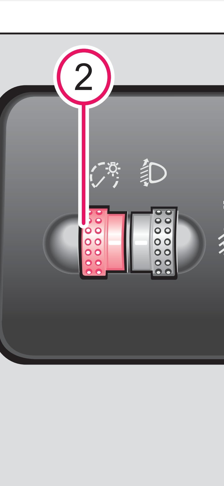

Try adjusting the instrument cluster ilumination dial from minimum to maximium like 10 times, DON'T DO IT TOO FAST, SOMETHING COULD GET DAMAGED, this could clean some corrosion from the switch, than try adjusting it slowly to see if there is some sort of position where it gets brighter. I think on my fabia the adjuster is a bit crackly after the many years. Or it might be a short somewhere that loads down the circuit but doesn't blow the fuse. The knob/dial on the left that is indicated in red adjusts the ilumination of the instruments, I don't know if it adjusts the ilumination of the interior switches.
