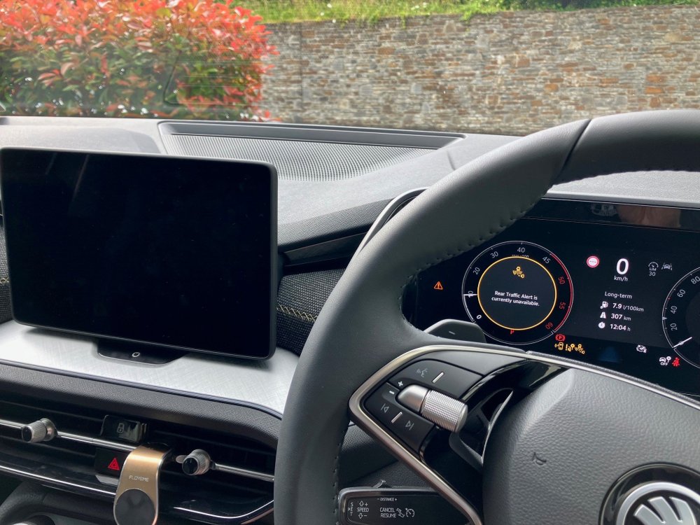

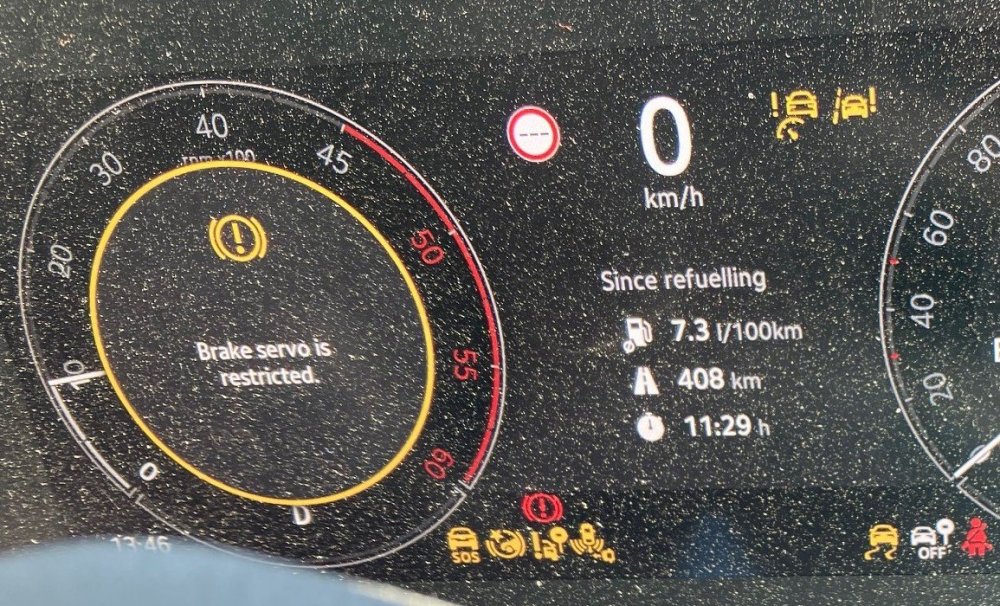

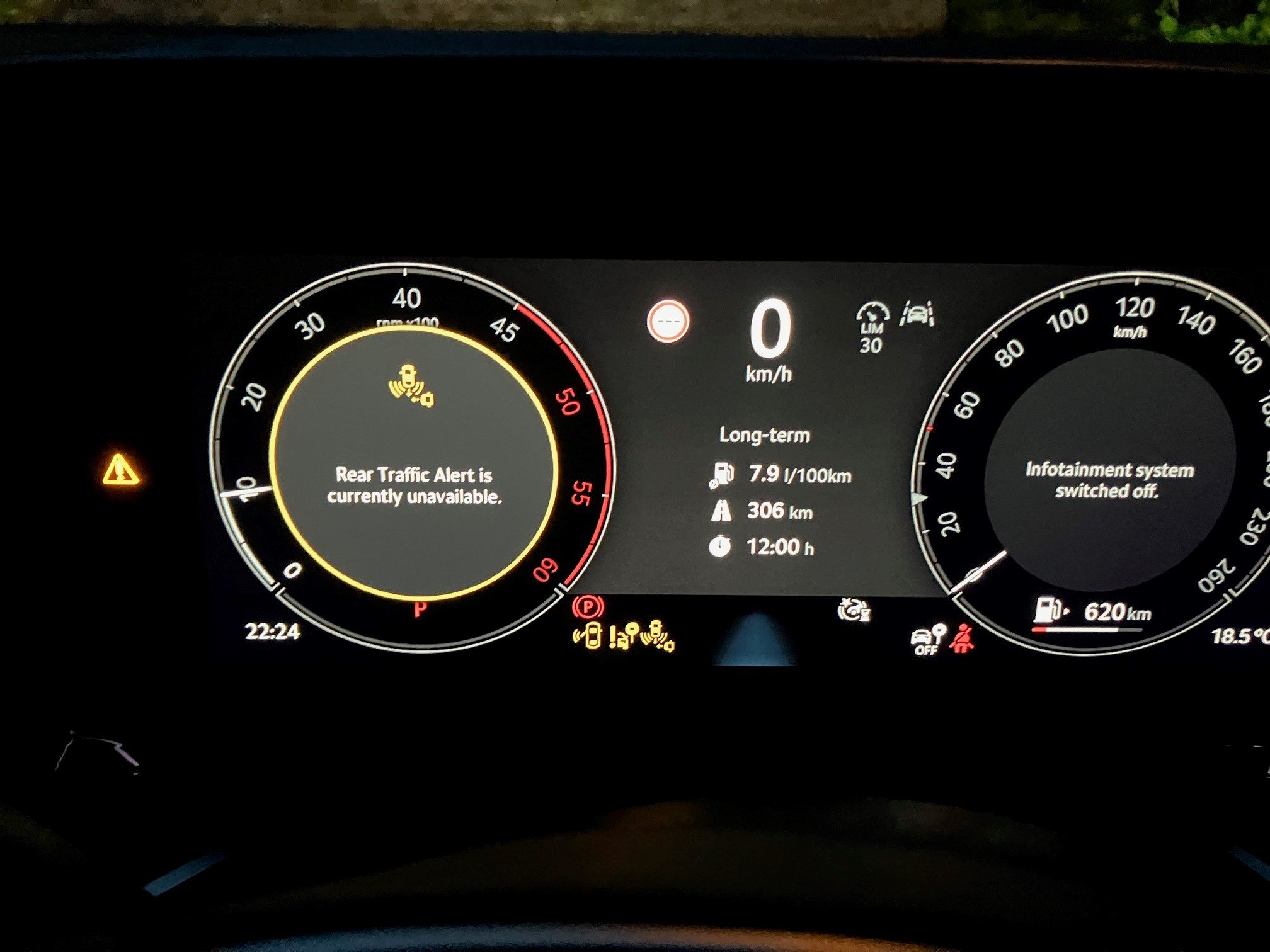

  2. Got some significant warning lights the other day when i started up car but didn't impact driving - see pic attached. Had to return car to garage last July after having it for a few days due to the Drive Assist sensors playing up and needed a full replacement of the 5F Control unit - Infotainment panel was non responsive also. If driving early on a cold morning, i get the the Lane Assist and Sensor errors but appear to go away once the car warms up. Anyway, the warning lights the other day obviously triggered the garage as i received an email to book it in for an appointment due to an error they are receiving "Error: engine control unit. Please visit workshop" Anyone else encounter this ?
  3. Did they replace the Control Unit ? That’s what my garage said they did and not to drive it. Had to order it in. Infotainment system was fully blank !

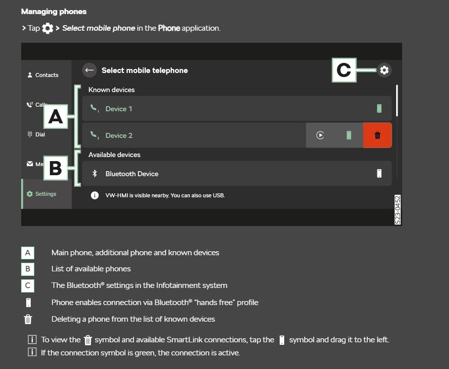

  5. Despite the instruction on the Online Manual, the direction on how to remove an existing phone doesn't equate to the steps provided ! Attached are the instructions but not useful ! I finally managed to remove the Android Galaxy. You need to go to the Car Icon (top right-hand corner of the display) - Settings - Connection - Mobile Devices & put the old phone in the bin. Any advice on how to troubleshoot the audio issues still appreciated.

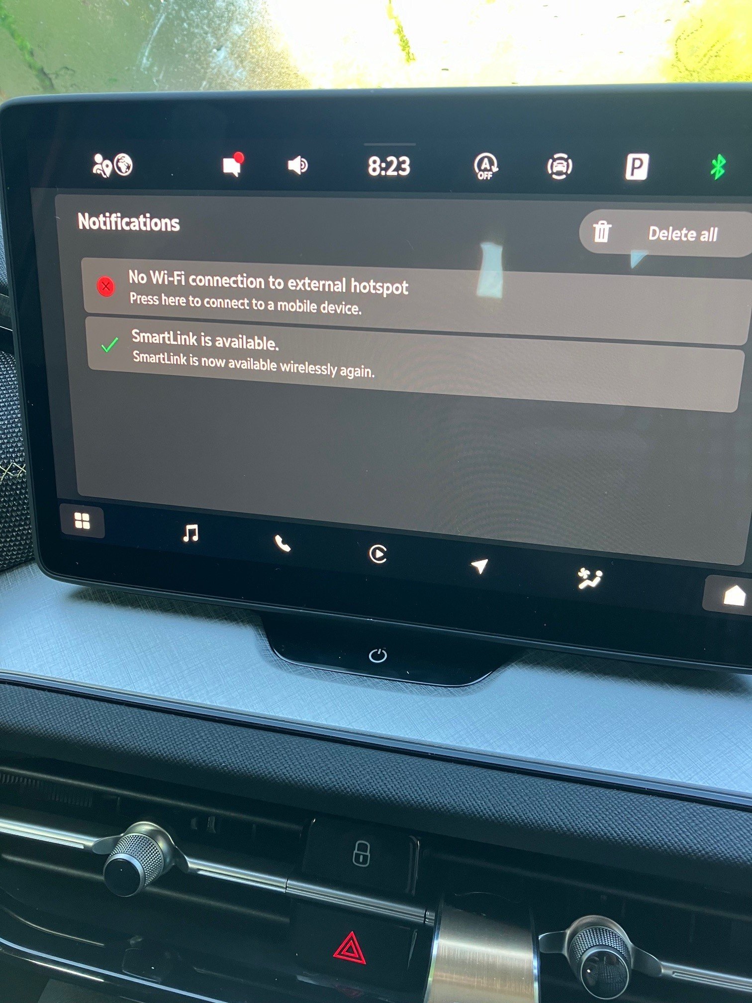

  6. Since the dealer replaced the F5 Control Unit, I'm having audio issues when listening to radio or Apple Carplay where a song might fade in and out after a few seconds and keep occurring intermittently. It's quite annoying and have been troubleshooting it quite a bit without any luck. Was able to re-create it with the dealer yesterday as well and couldn't figure it out. They are due to come back to me on it. It's like an Announcement might be coming through but this setting is turned down to the lowest at 3. Why can't this be turned off ? Have this error displaying "No Wi-fi connection to external hotspot" but this is required for Apple Carplay to operate. The dealer connected his Android Galaxy phone as well but it isn't straight forward to remove an existing connected phone !

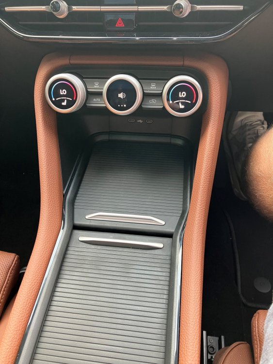

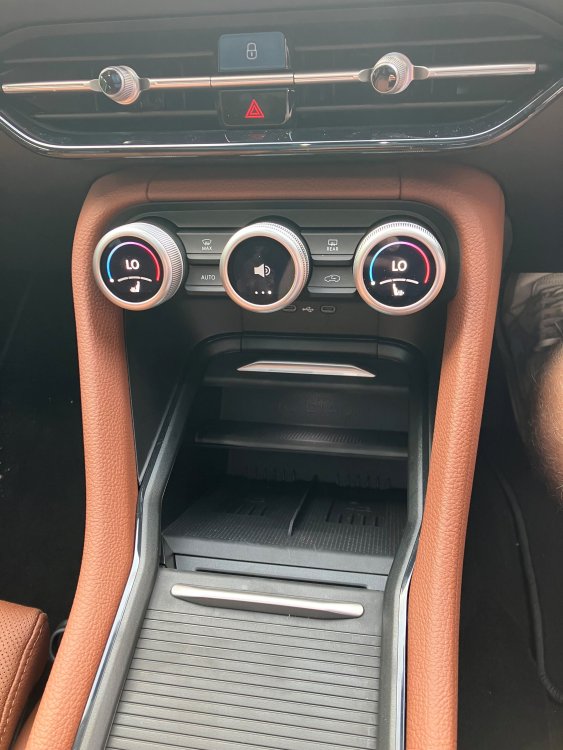

  7. Managed to see my friends Selection Plus centre paneling last night and this allows the closure over the charging bays - 1 difference between the Selection & the Selection Plus

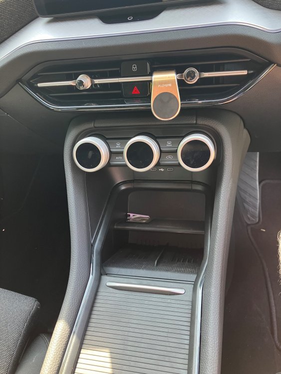

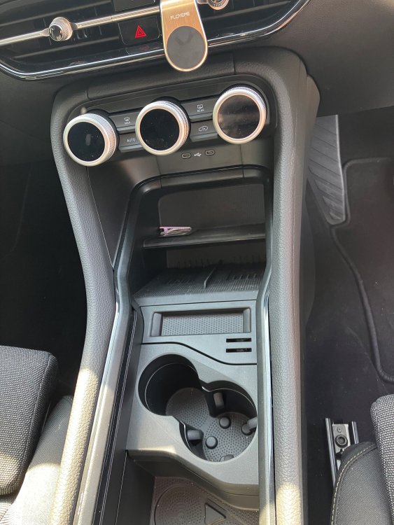

  8. See Centre paneling Open & Closed from my Kodiaq 2.0 TDI Selection picked up in July where you can see both Phone holders are constantly Open. Hope this helps.

  13. Hi Marietta….No nothing back yet. It occurred last Tuesday night and they have been aware since Wed 17th with no timeframe provided. When did your issue arise and how long are you waiting to hear ?
