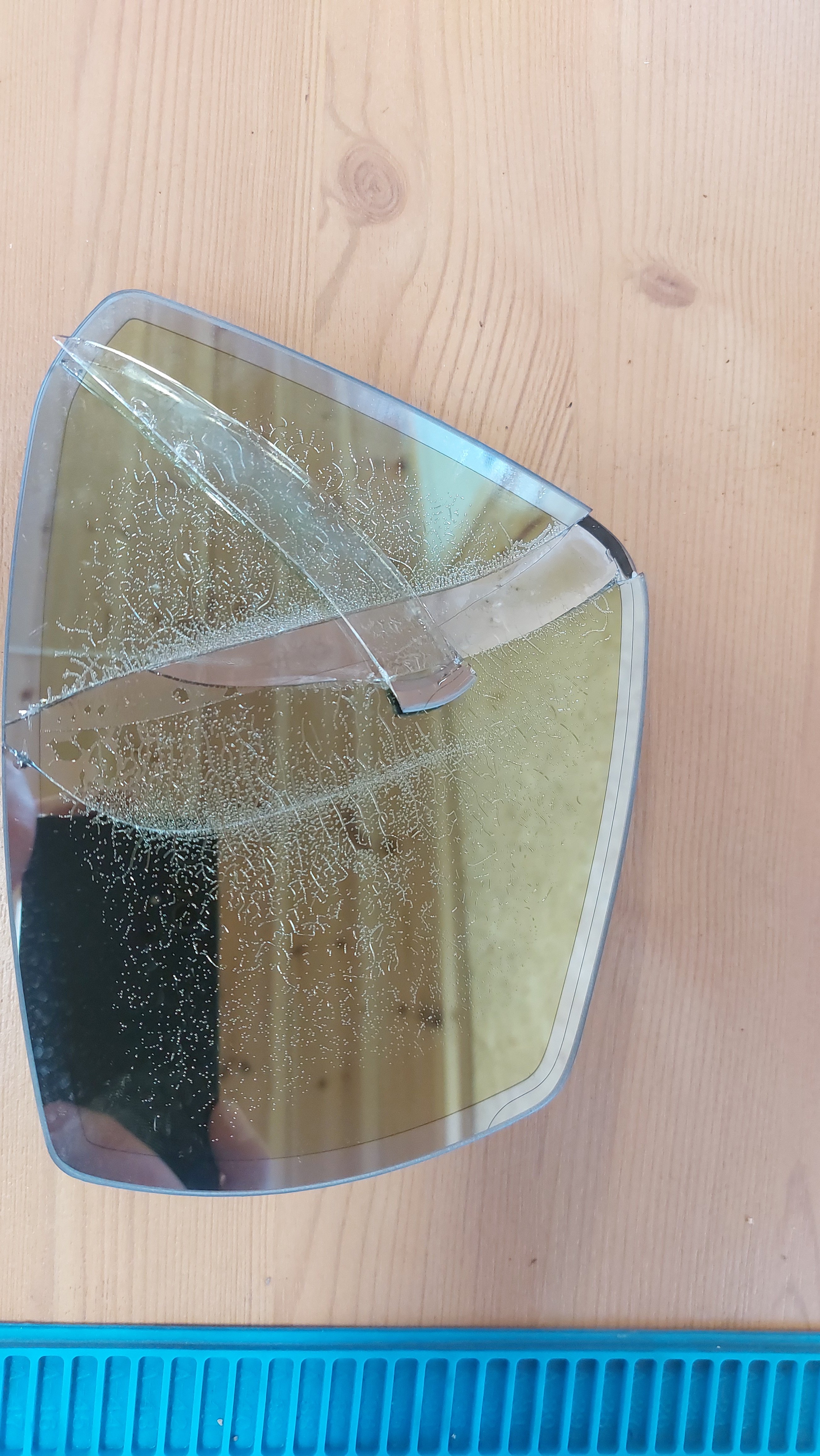

  1. Those parts are fairly inexpensive, but your mirror glass is not. Just use some caution when you pry it out, because you don't want to end up like this:
  2. I've done this swop myself this fall, and besides me braking one mirror glass the job itself is simple. I just got unlucky I guess, and I suspect age of the mirrorglass itself could cause them to be a bit more brittle than brand new ones. I'm just using a bit more caution when I remove the mirror glass from now on, and just simply work my way around it bit by bit, because my mirror glass are stupid expensive because they are heated and has autodim feature as well. Personally I felt it worked best to start prying from the opposite side of what's shown in this video, and just use caution no matter. Just going full wack can break the glass if the force is applied at the wrong spot, so just a little caution. I'd also check price for new mirrors for your specific car beforehand. Mostly it's autodim feature that cost an arm and a leg, so if that's not on your car then I'm sure it's not too bad.
