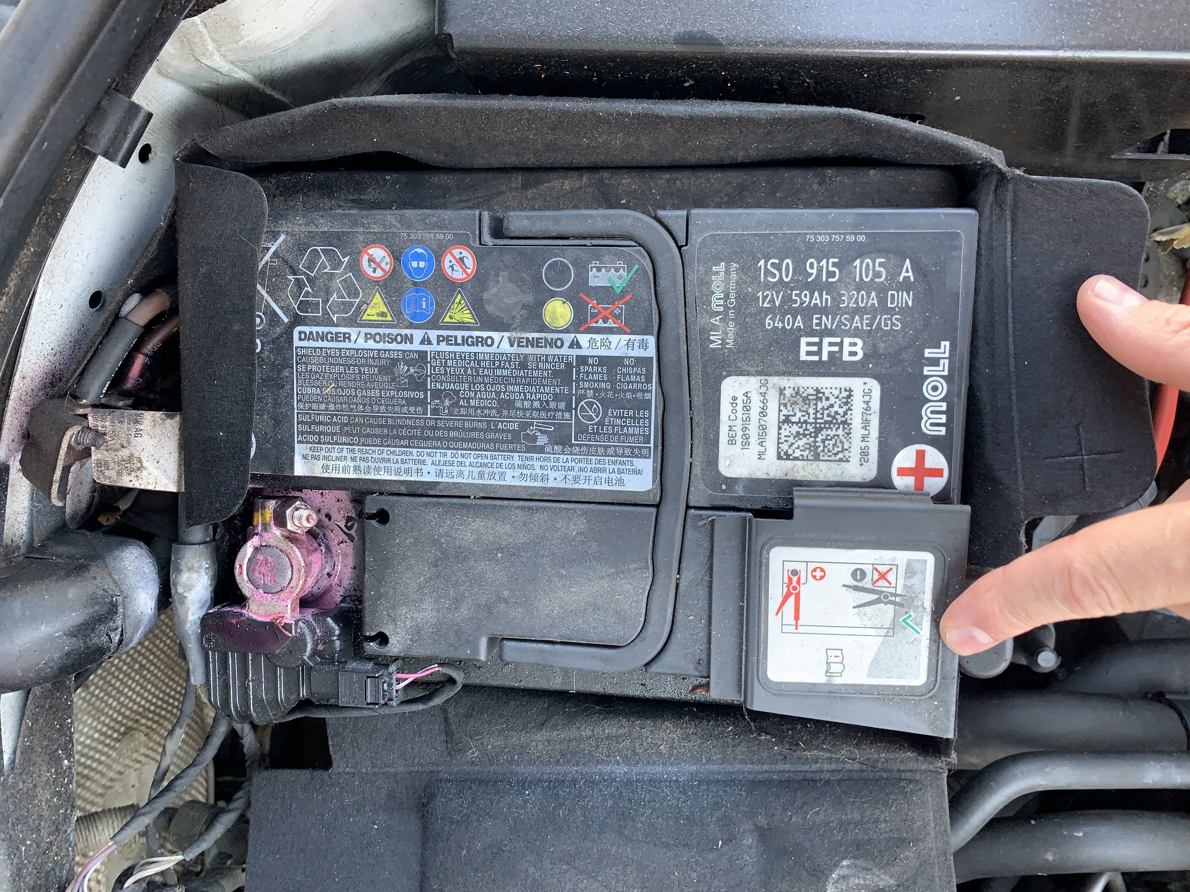

  5. 2nd UPDATE: Looking at the date stamp on the negative post 28 15, I think this means the 28th week of 2015. So it’s likely that it was the original battery fitted in mid 2015, so on reflection it had done quite well with 9years and 90,000 miles under its belt. New battery is fitted and the car is running smooth and all seems well. So fingers crossed that might be it for battery issues and judders for now 🤞 I’ll update if issues return
  6. Thanks mtwrallye, what should I look out for on the earthing points and would it be a good idea to refresh them? UPDATE: After jump starting last night, and taking on a 30minute drive, the battery was flat again this morning, so another jump start to get it to the garage. The garage recommended a new battery, the same size as the current one fitted, which is arriving later today. See picture of current battery, might this be the original battery fitted to the car in 2015?
