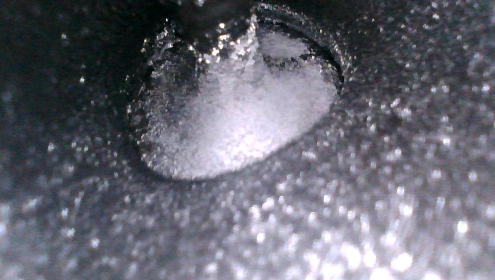

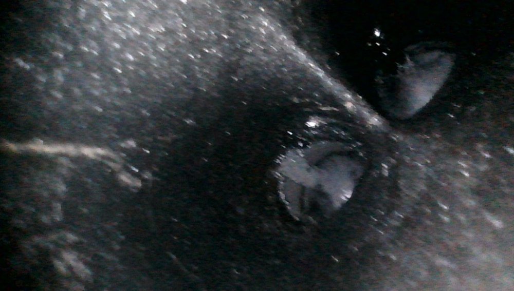

not familiar with the 1.4 but as a DI engine could carbon build up be an issue or does it have dual injector setup like the VRS?
1.4tsi is only direct injection so carbon build up on the inlet valve can be problem but I would expect it at a higher mileage and with different symptoms.
On the ea888 gen 2 I can tell you carbon build up is a real problem from 60k miles onwards. Sometimes less.
But I agree with most comments and suggestions in the last few posts.
The impact I had from carbon build up was more at light throttle / cold starts much less obvious on motorway and higher loads. But this was on a 2.0 ccza.
