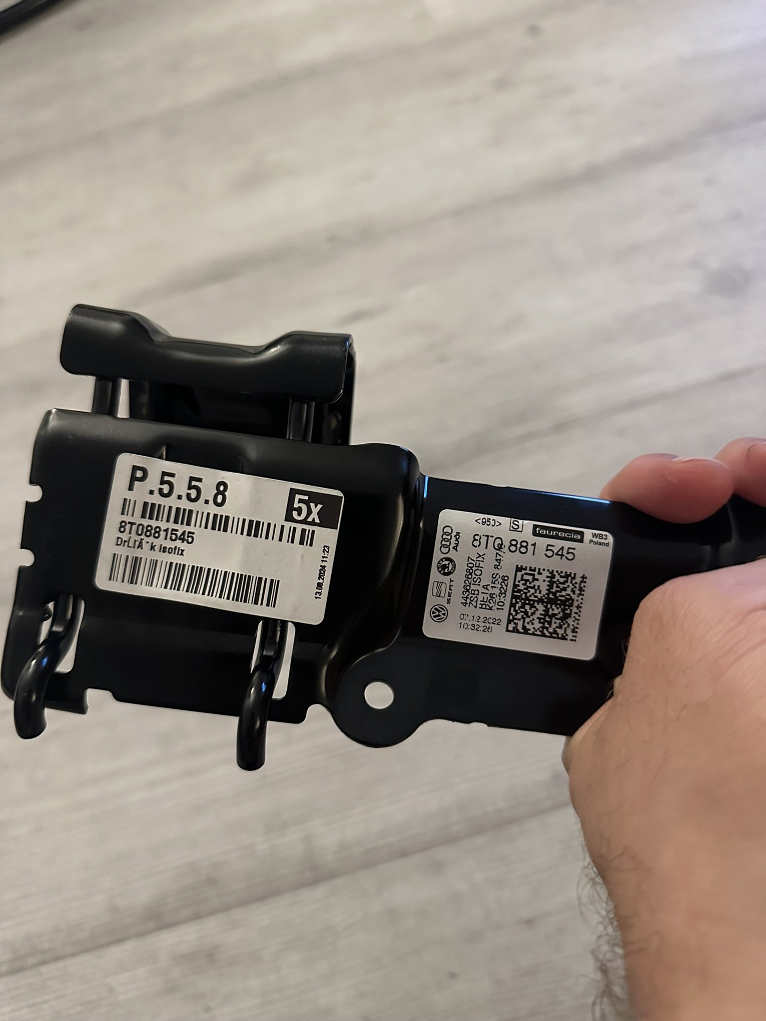

  4. I have tried to keep to the OEM parts/design however if it wraps around some proper structure in the seat then I may have a look at the aftermarket route although I think the structure is more under the split line of the seats than above. I have a feeling the leather thickness on the back of the seat is keeping the OEM bracket from fitting.
  5. I havent given it another go but I highly doubt it was going to work from my first try. I was speaking with someone at Vindis Skoda when my car was in last week and they said they could try to fit it but if I provided the parts then if it didn't fit then they would charge me the pleasure of doing so, however if they were to provide the parts they couldn’t charge me if the part didn’t fit when it was meant to. So as the part wasn’t terribly expensive and probably cheaper than them trying, I was thinking about going down this route. What model seats and trim do you have? Where are you located?

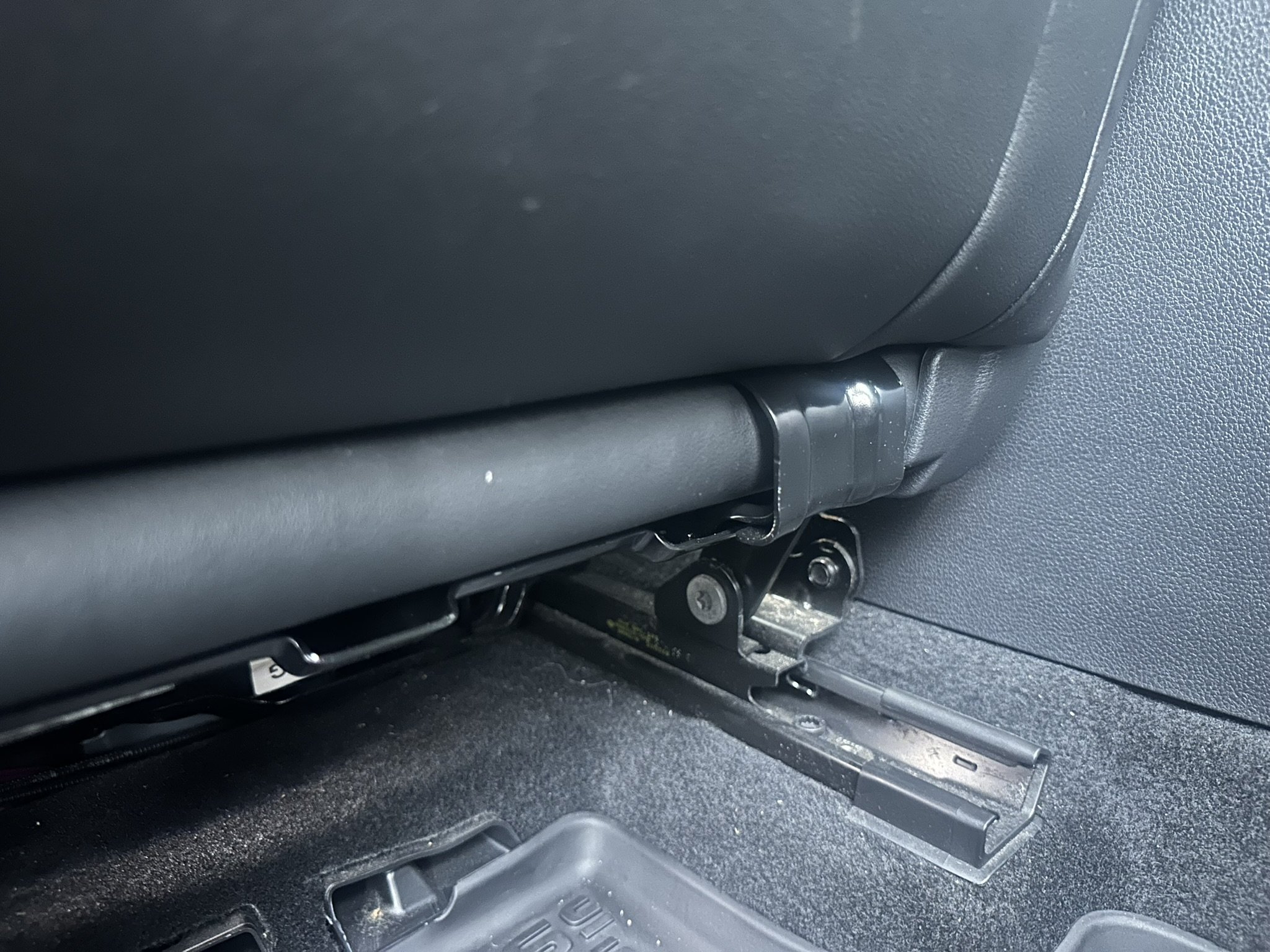

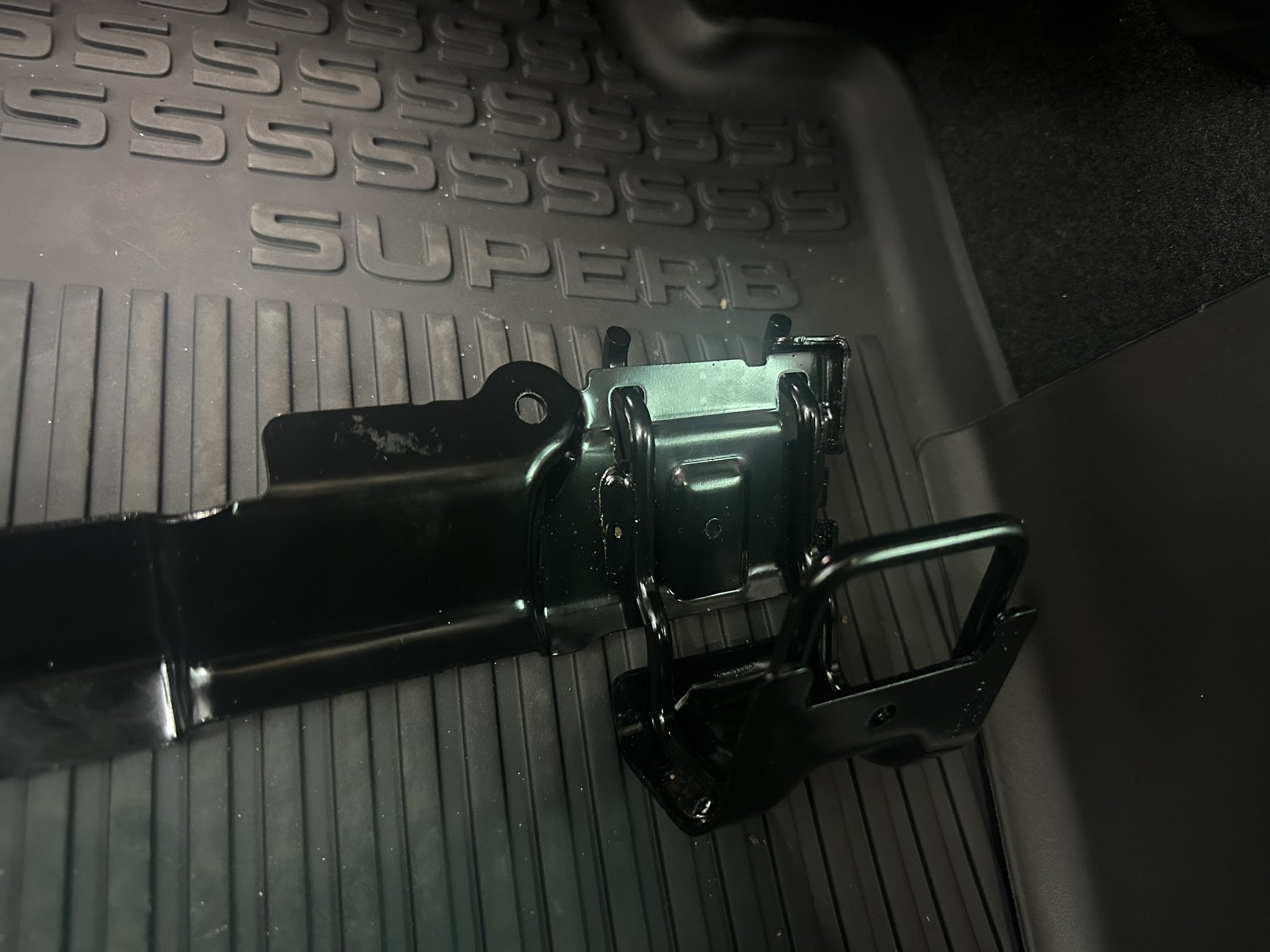

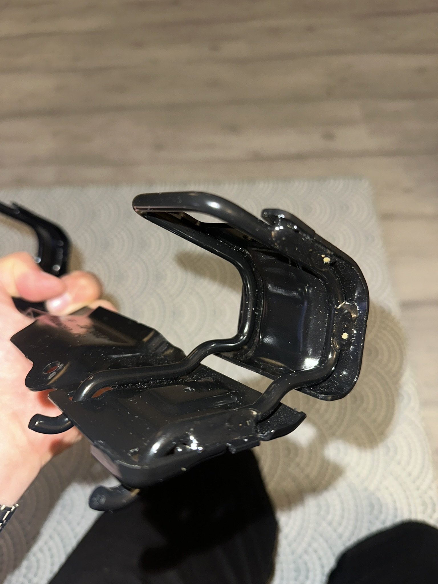

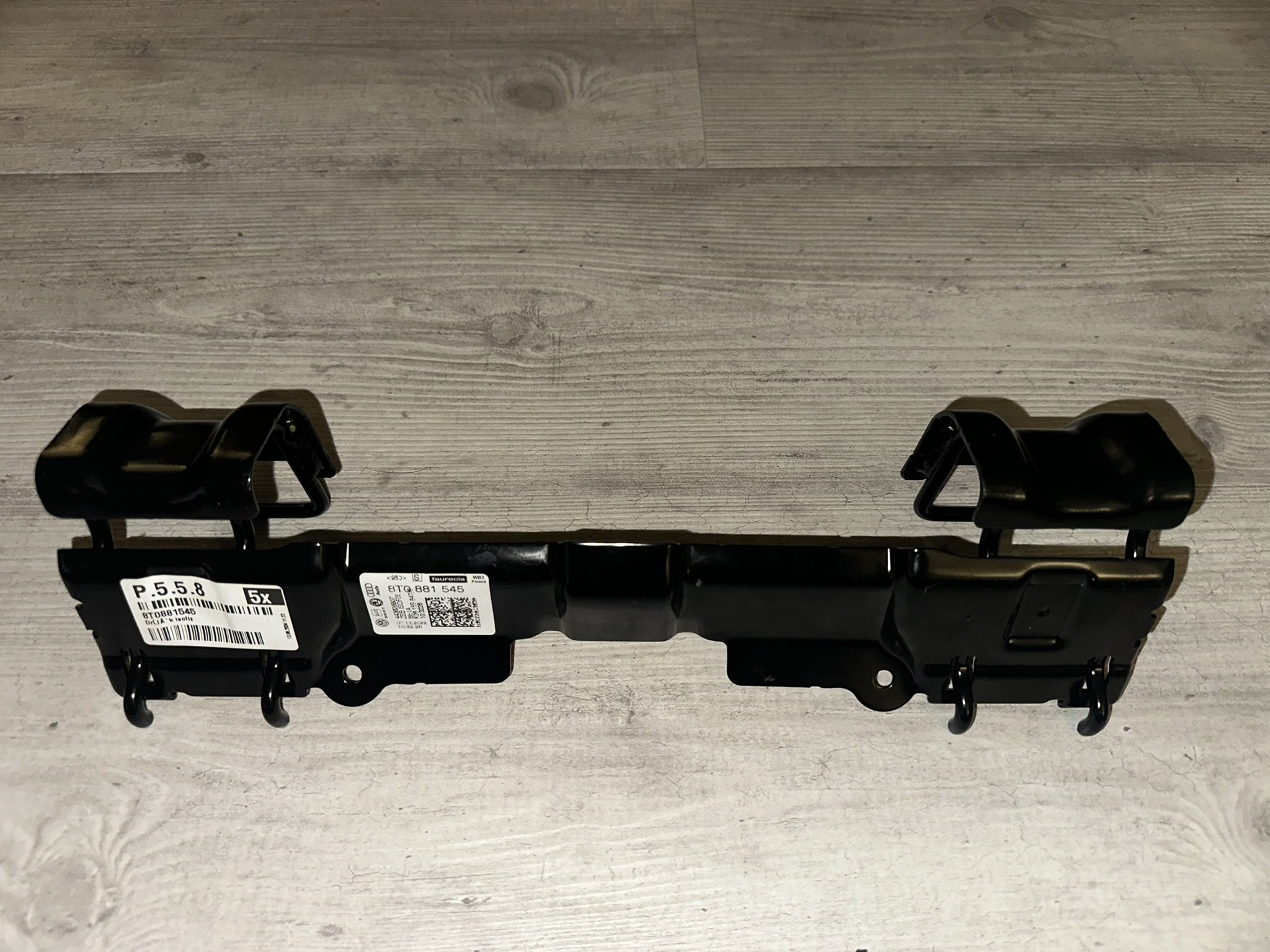

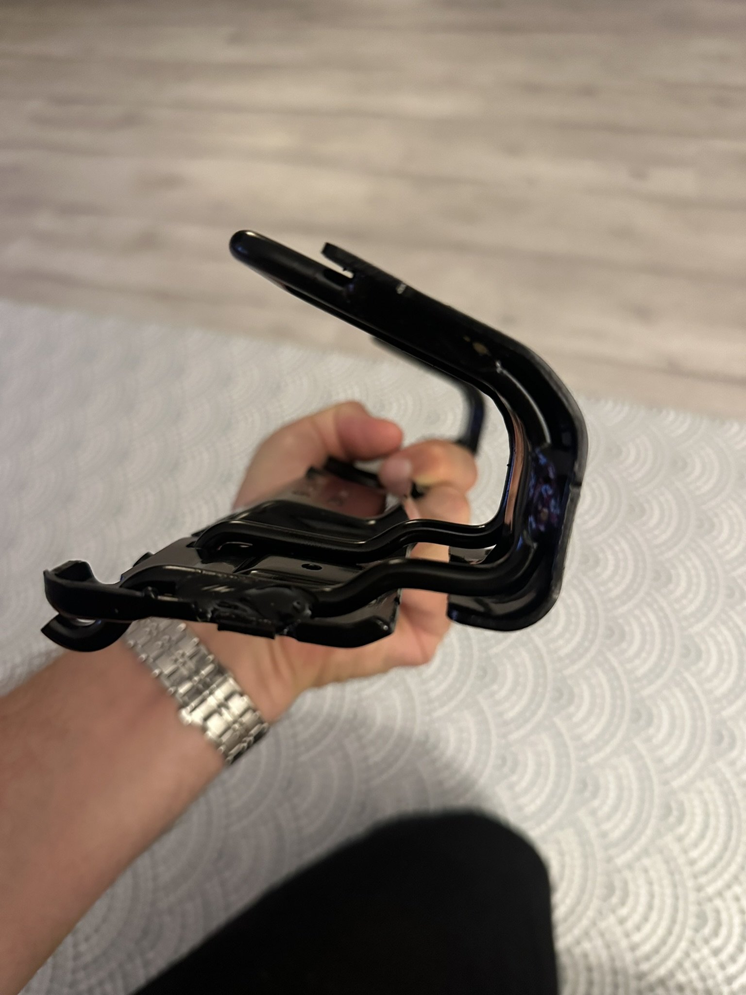

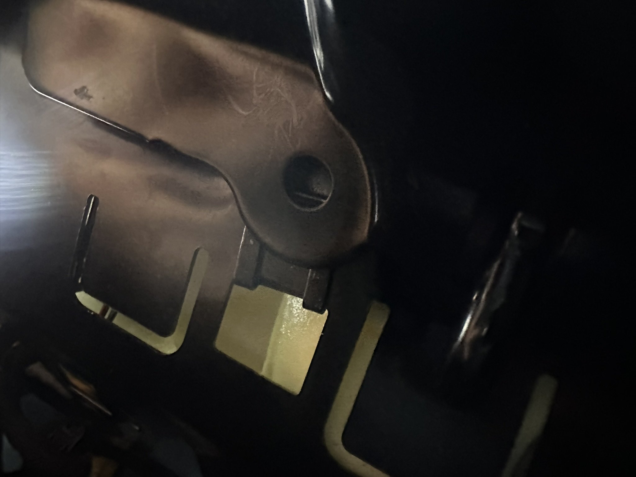

  8. Hello, I was wondering if anyone has actually carried out this retrofit? Per my car factory specification, it wasn't fitted with ISOFIX points in the front passenger seat (3G0 KSI Without child seat anchor in front (ISOFIX)). I have a newborn and sometimes if it is just the two of us, it is easier to have his car seat in the front seat (with the airbags off). Looking at ETKA, it was a possible option for my car when new and should be quite an easy fit, no longer than 5 minutes as it is just two bolts underneath the seat. Unfortunately, when I went to fit the bracket, I couldn't get the bracket pushed in far enough causing the two attachment holes to be about 10mm out from front to back. The width between the attachment holes is correct and it looks like the bracket should work. I am wondering if it is the padding holding it off or the bracket has been made incorrectly. All parts are genuine. I therefore bought: ISOFIX bracket: 8T0881545 Speed nuts 2pc: N 90088003 Bolts 2pc: N 90737101 My car is an L&K Superb mk3 2018 with perforated cooled electric seats.
