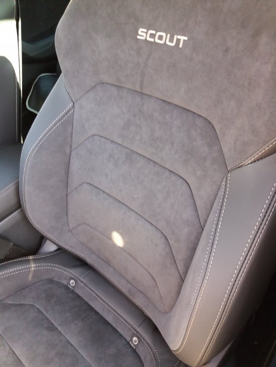

I have isofix on front seat, but I do not recall ISOFIX badges sewed onto. I can take picture of how they are located.
The ISOFIX badges might be a recent thing. This is my 2018 Kodiaq...

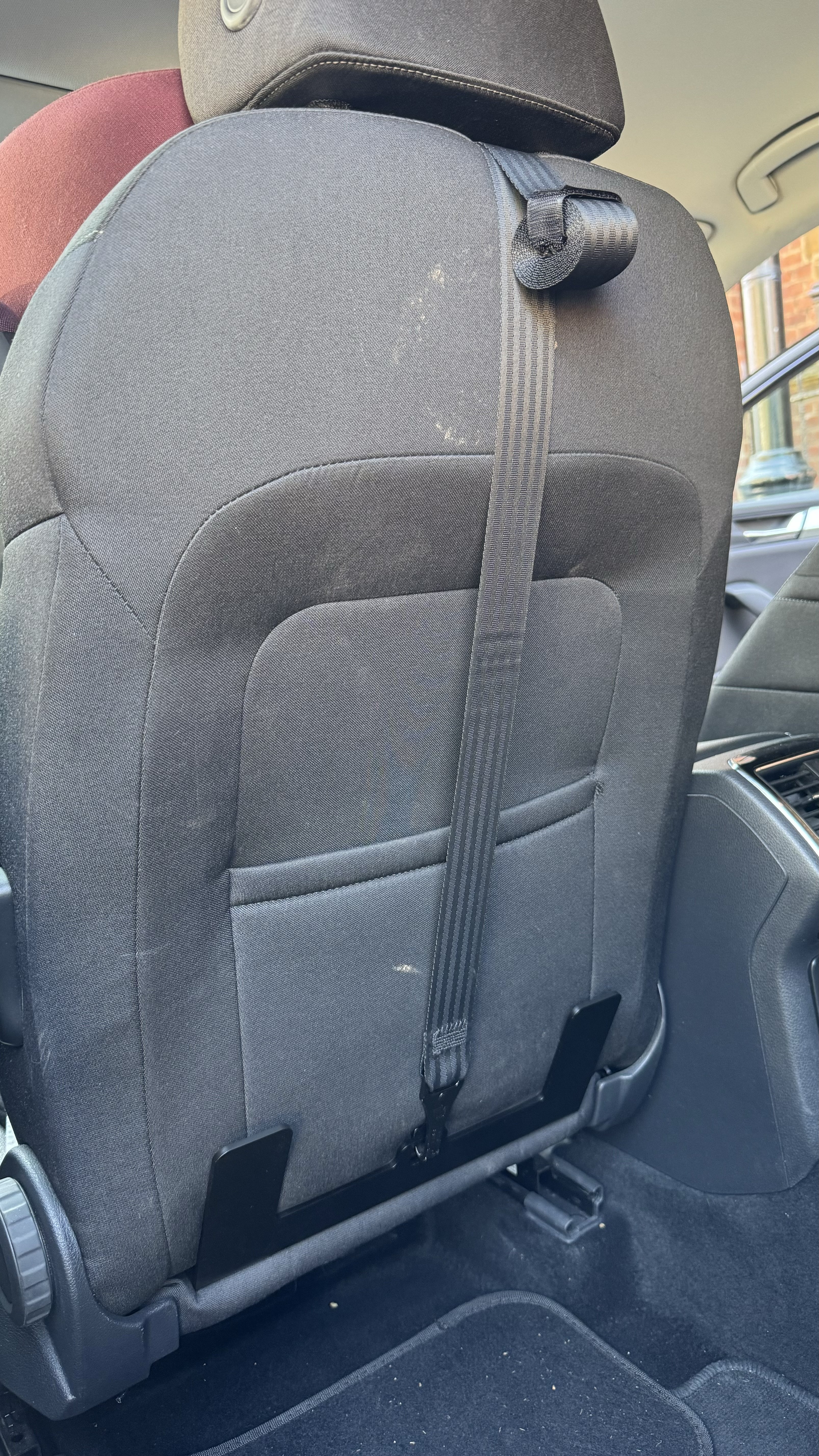

Right, so have installed the basic solution…
actually pretty pleased with it. I can’t fault how firmly the thing is held in place, that’s for sure.
Not super easy to install, the bar the isofix mechanism grabs onto is pretty deeply recessed in the seat so takes a bit of grunt to get it to clip on.
It’s a super cheap and simple solution but seems solid to me. Is a thick bit of steel
