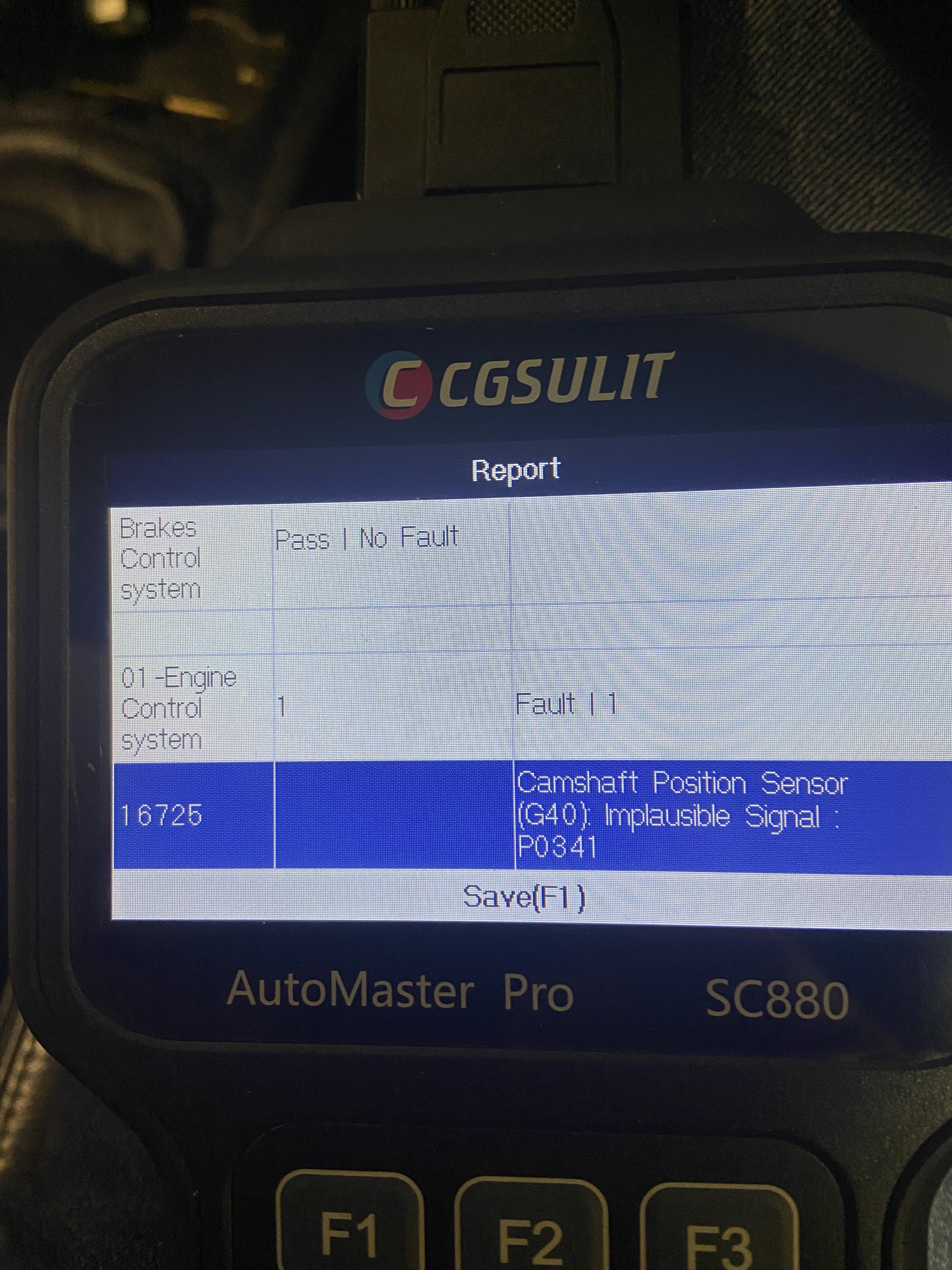

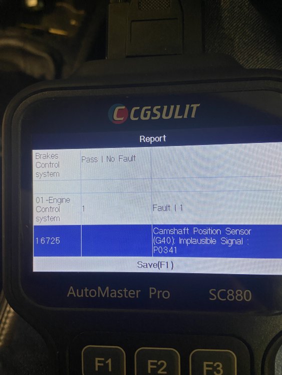

  5. Just did timing belt and water pump, timing was ok , but who ever fitted the new camshaft sensor never located it correctly in its locating hole, this actually bent the plastic bracket and it was not picking up the camshaft signal ring consistently, fixed the bracket, the car now starts perfectly, no long cranking time, fault cleared ……..hope this helps someone.
