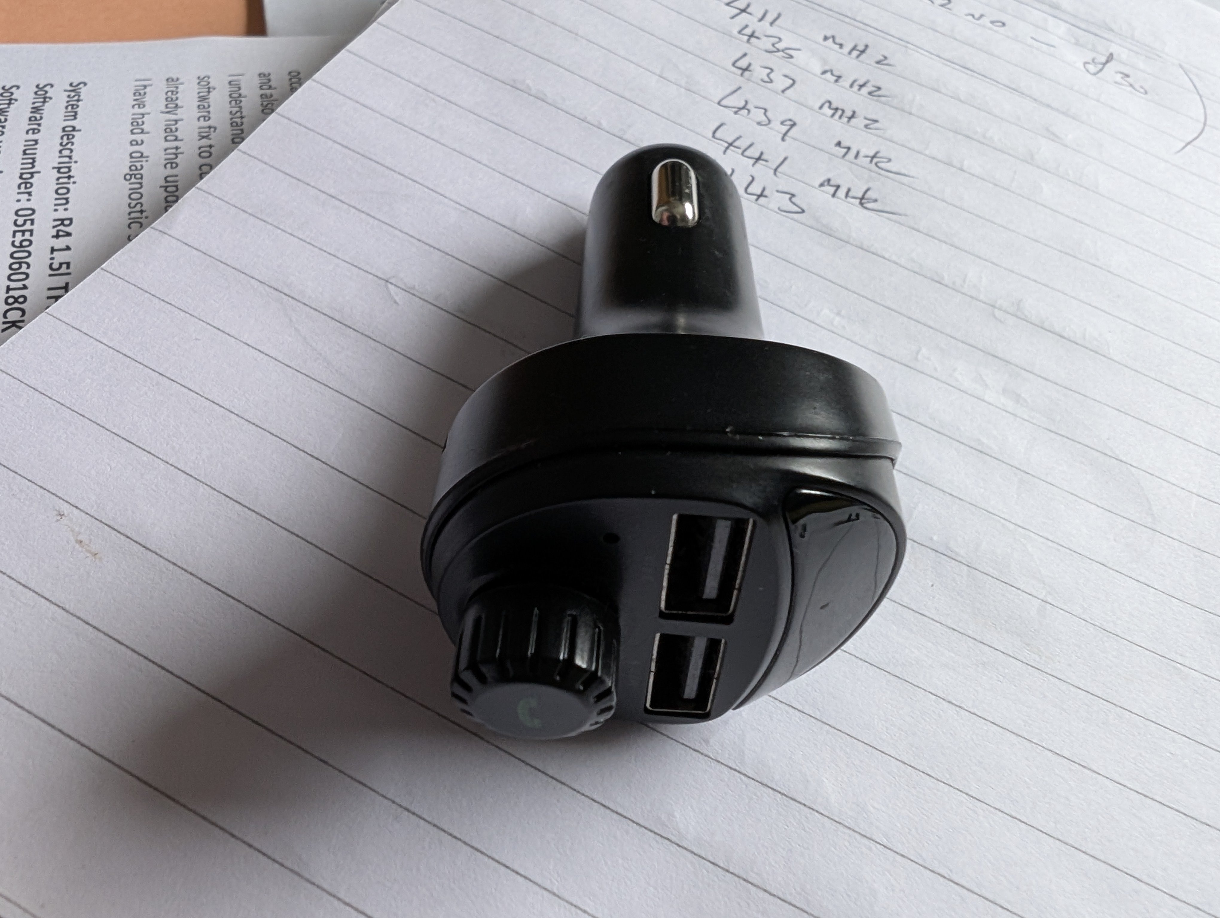

  1. I used a Radio Scanner and it was recieving a signal on multiple frequencies all over the band's including the 400mhz frequencies. When I switched it off they disappeared. It seems to interfere with infotainment unit as well.
  2. After months of intermittent problems i finally found out what the problem is which may be of use to any other members with a similar problem. The intermittent failure to detect my keyfob at any distance turned out to be a cheap chinese plug in Bluetooth/FM Transmitter / Battery Monitor that i had plugged into the cigarette socket which i only used to monitor the battery voltage. It was transmitting a spurious signal with harmonics across the FM band and up into the 400mhz frequency that was acting as a signal blocker to the remote receiver for the keyfob . I had ocassionally unpluged the offending device so as not to drain the car battery and i had not spotted that this is when the keyfob range reduced massively . I tested the horrible device and it was sending signals all across the keyfob frequencies.
