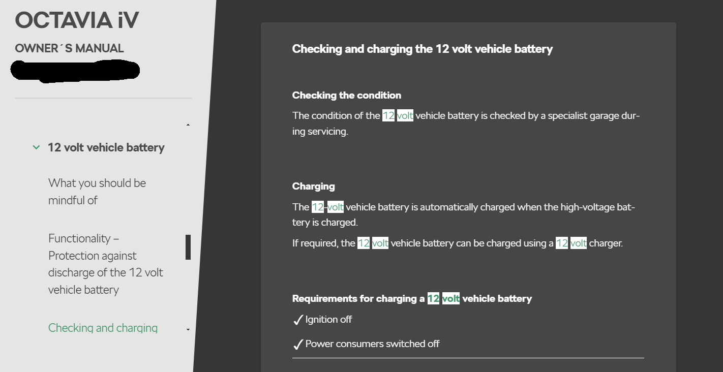

  2. There was a link posted in page 1 of this thread to another thread where it is suggested that these car's don't have an alternator. I have just checked the user manual for my car and that states the 12V battery is charged along with the HV battery. My HV battery gets charged regularly, so I can only assume that makes it either a fault with the battery or the charging system for the battery.
