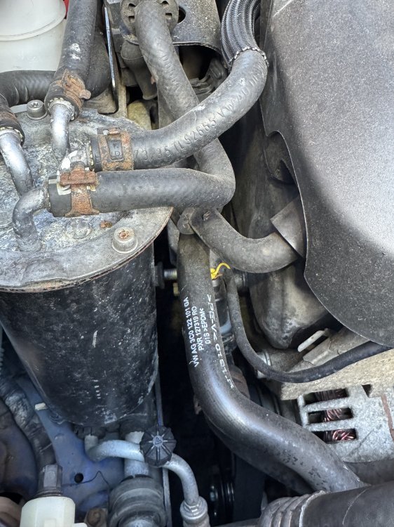

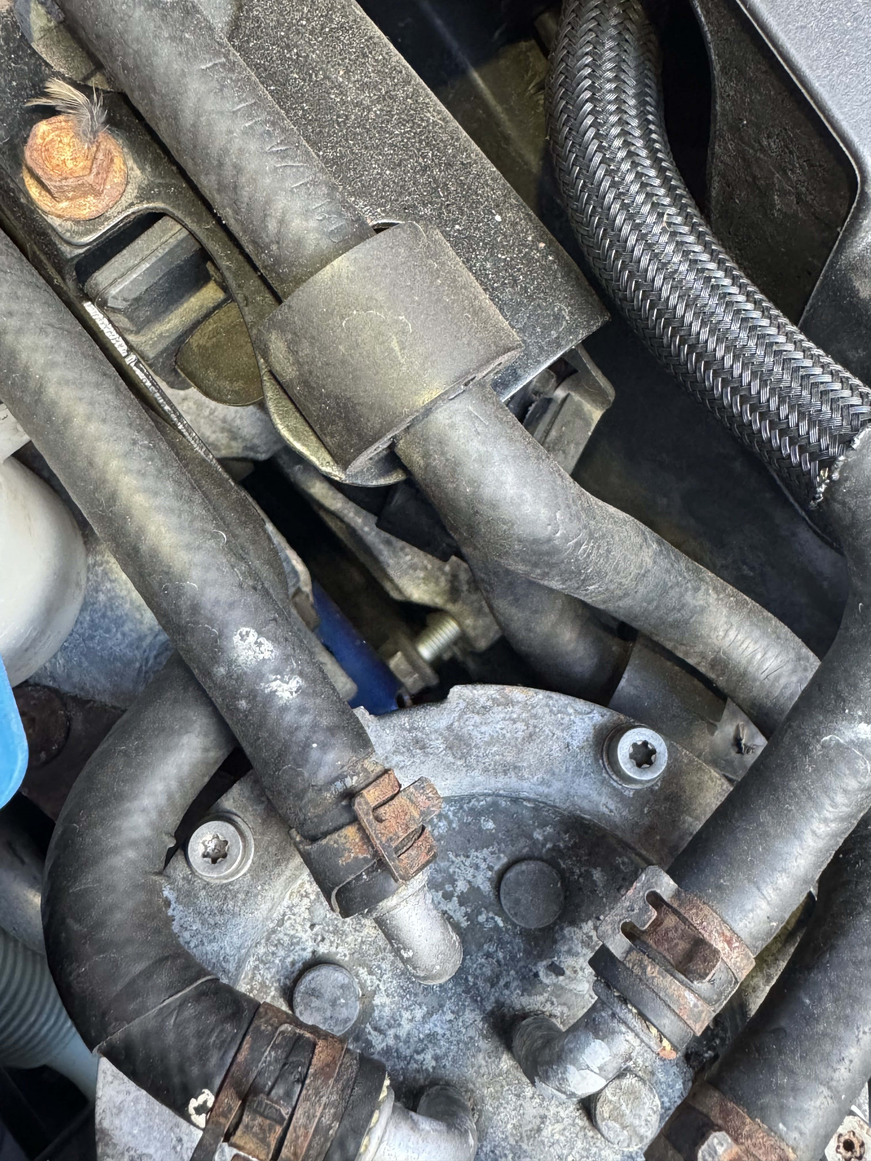

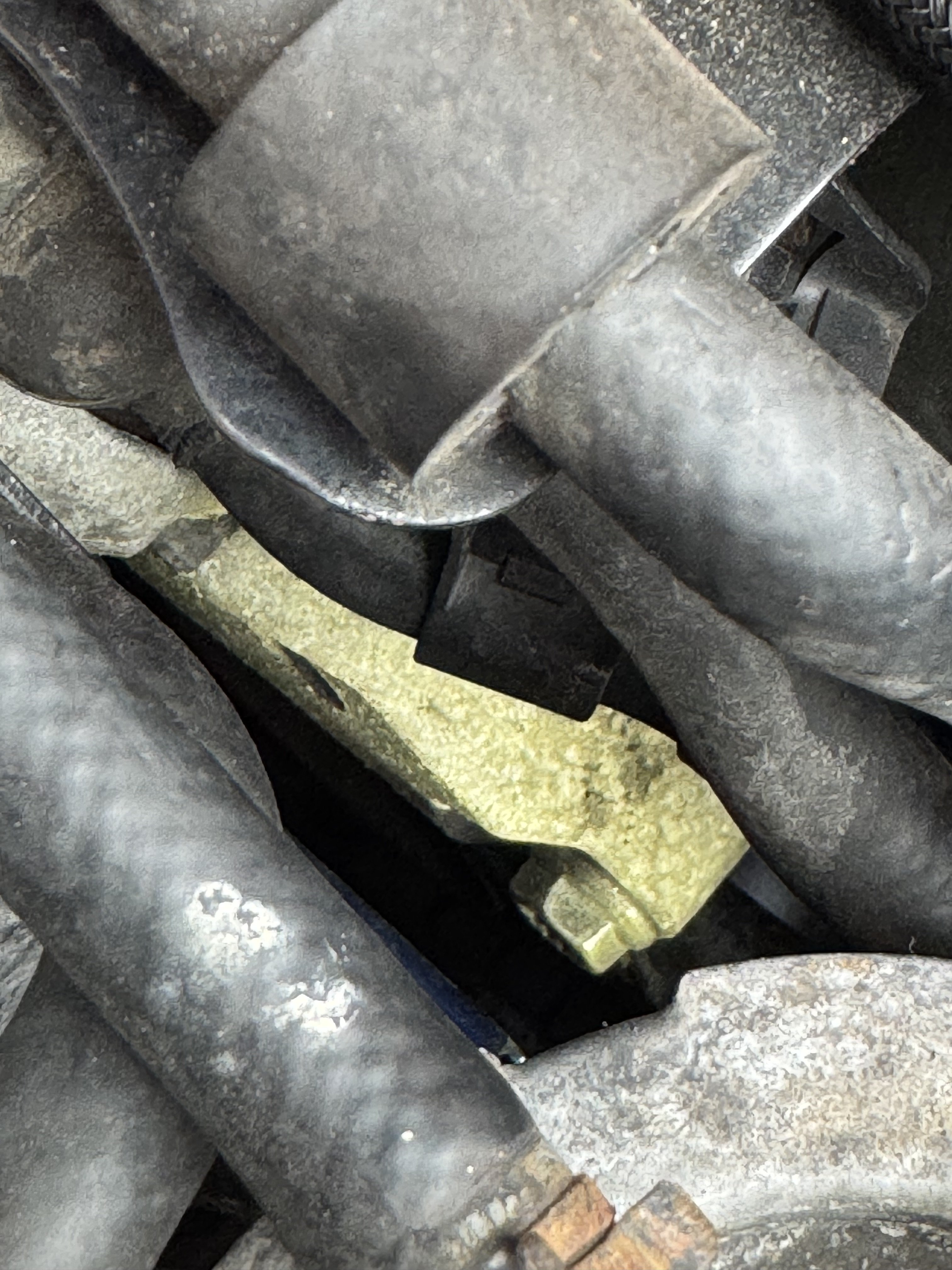

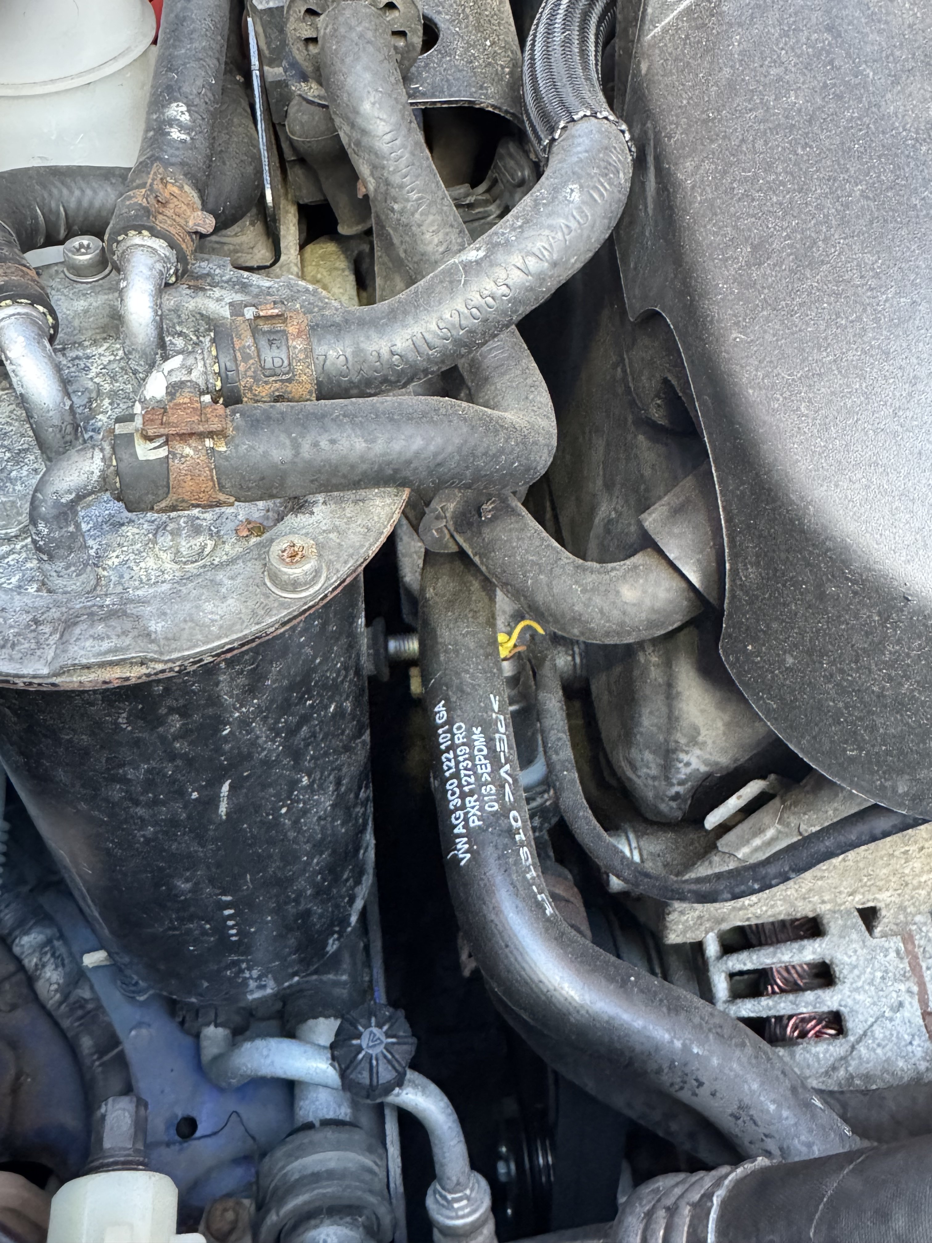

  11. It’s in a really difficult place to get a photo, simply because space is very limited. This is the best I could get. It is definitely the engine mount I have done 50 miles now with no noises. Not sure if the Octavia VRS has a different engine mount design to normal TDi’s but I have found a very similar design from a MK6 Golf.
  12. Everything you have said sounds like a regen. You won’t get a dashlight until it fails multiple regens and the soot level starts to rise. It then means you need to take action. Usually when I notice the revs sitting on 1,000 rpm I just take it down the motorway a junction and back again in 5th gear. By the time I am home it is idling normal. Speaking to a mechanic he said the majority of DPF issues people get are people disturbing regens turning the car on and off due to them doing short journeys. When I got my Octavia it had a an awful remap on it and the VAG correction software. I was getting passive regens every 100 miles. I had the correction software removed and then a proper custom map. I get them once a tank now. Usually a 400 mile interval. That’s on Sainsbury’s diesel with a squirt of millers ecomax fuel additive.
  13. I’ll try and get a better photo of the mount and bolt I tightened tomorrow. I am pretty sure it has to be removed to do the timing belt which was done in 2023.
  14. It is the engine mount by the looks and tightening it up has sorted the problem. My next question is what are the torque specs on it?
