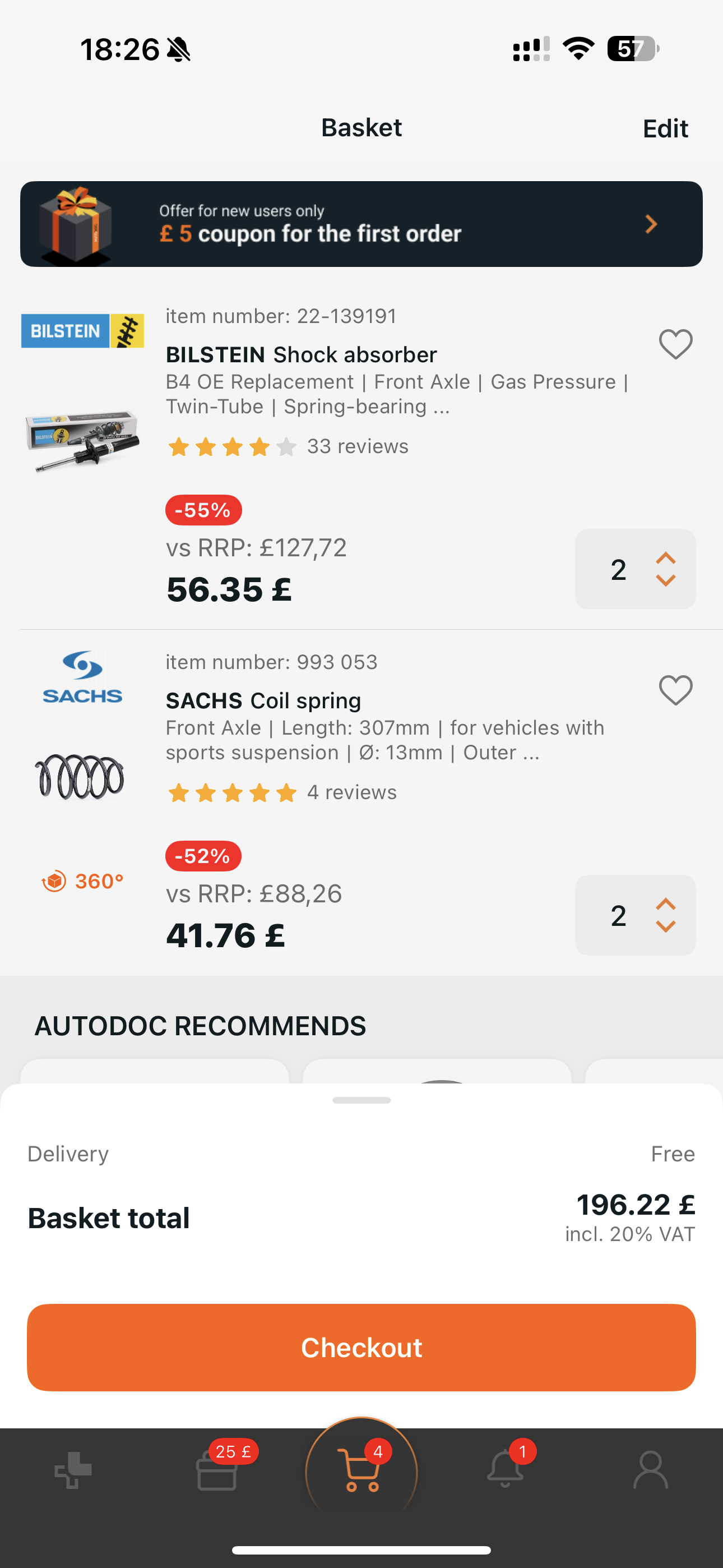

  17. Are these the correct part numbers?
  18. I am 99% sure my Octy has a snapped drivers side spring. I hit quite a big pothole yesterday and heard a clunk. When turning the wheel to the left now, there is a grinding noise and dropping down off a speed bump it is clunking and creaking, feels disconnected and on the brink of collapse! I have checked Eurocarparts and can see they stock a front shock for ‘sports variant’ but no mention of a sports coil spring. On AUTODOC they stock two front sports spring. A pink red and white 993 053 307mm and a pink white red 997 857 307mm. Which one do I need for my diesel VRS? Does the diesel have a different shock too!?

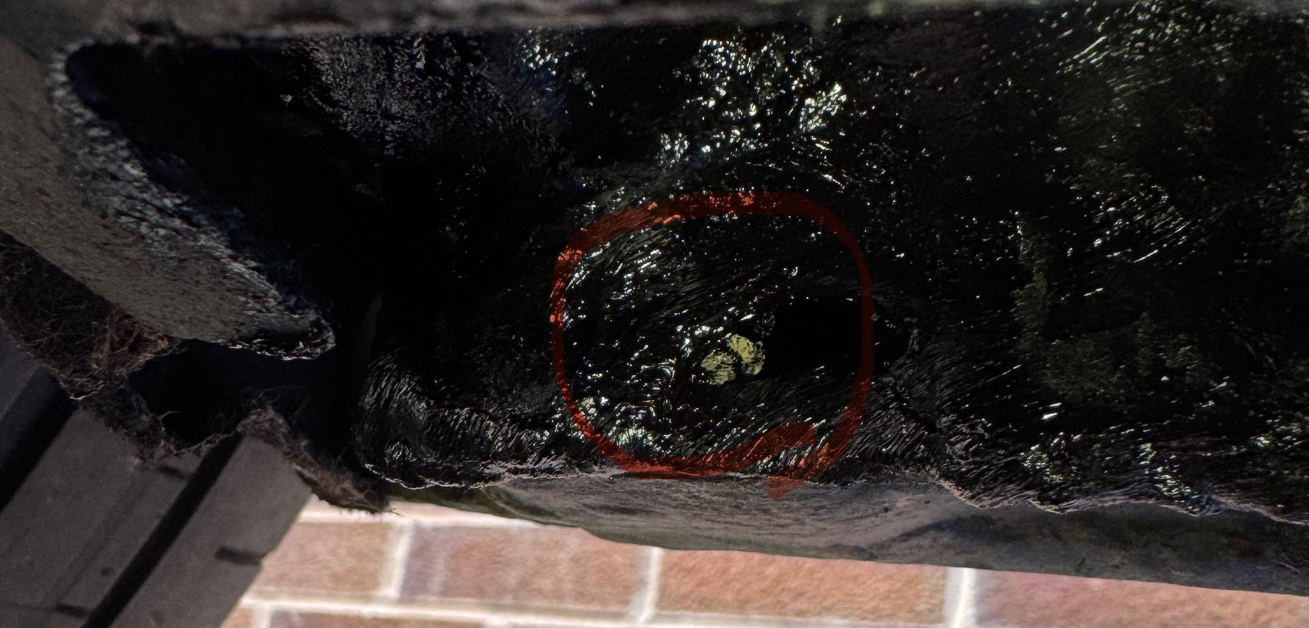

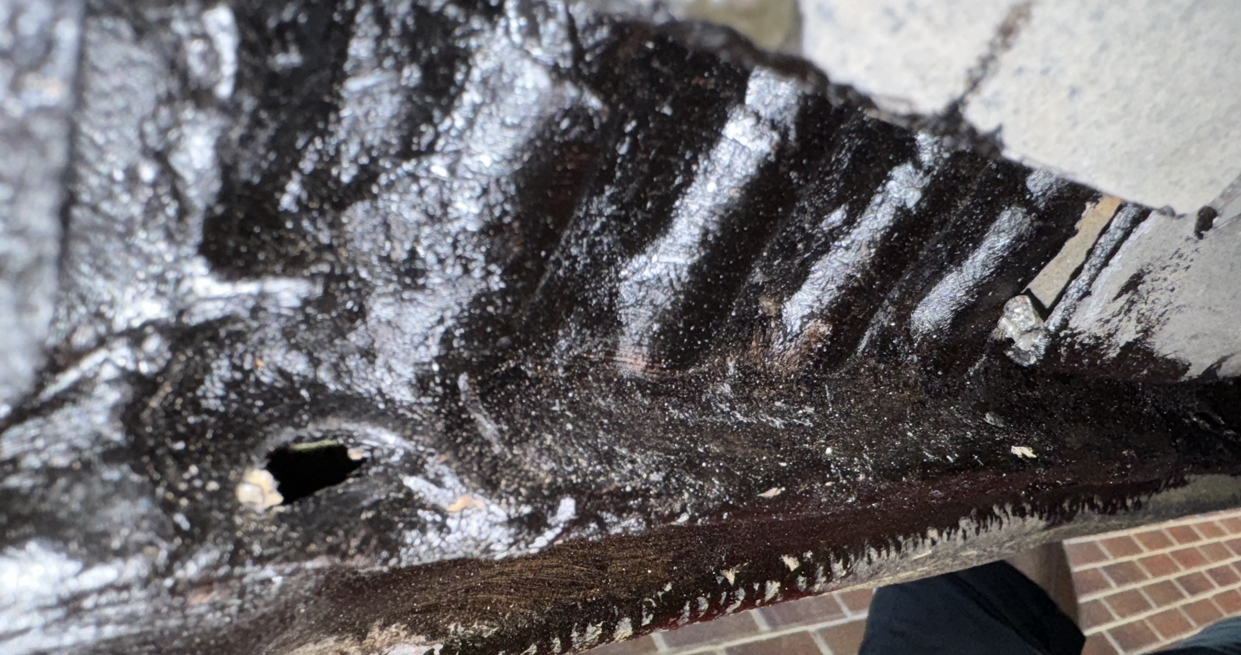

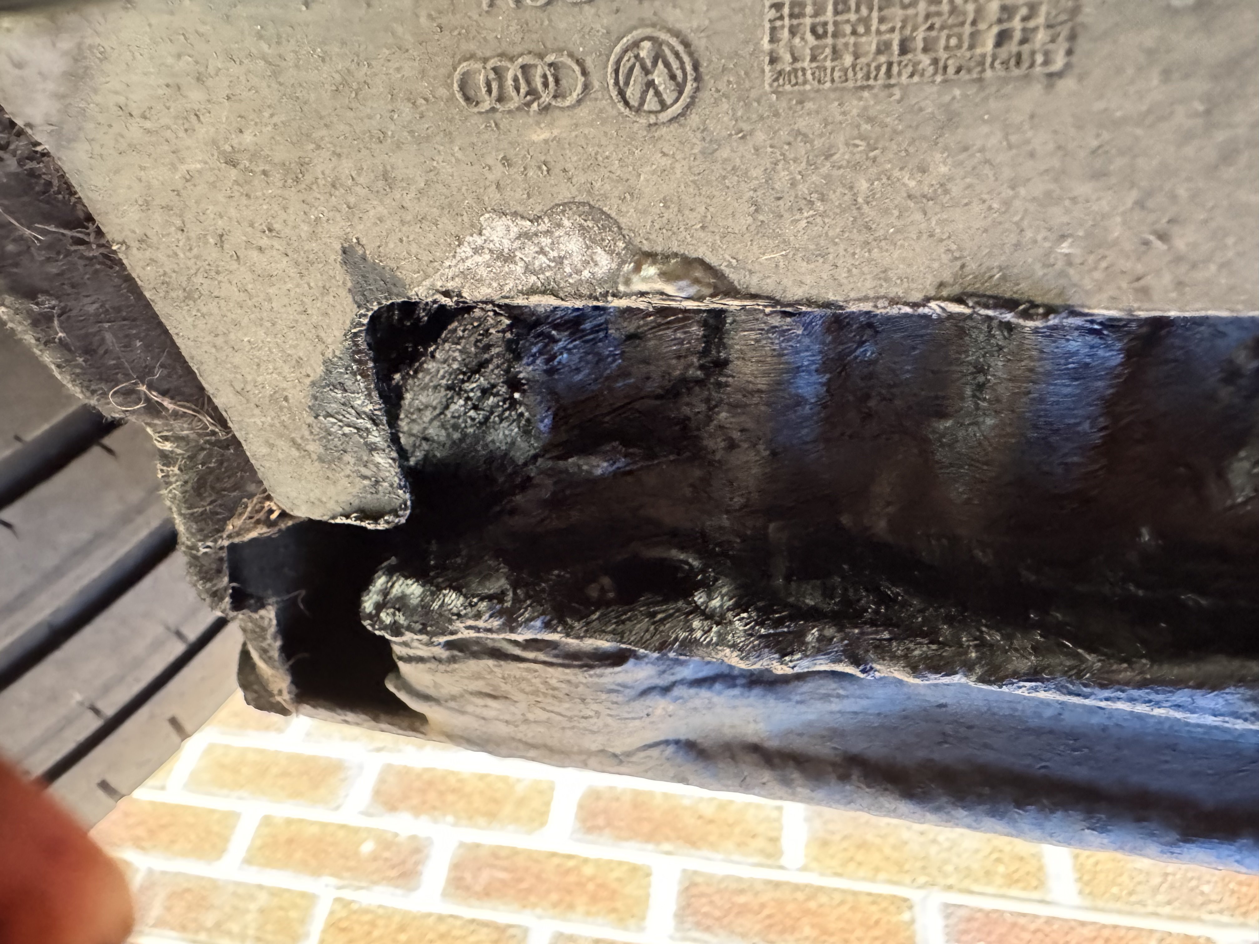

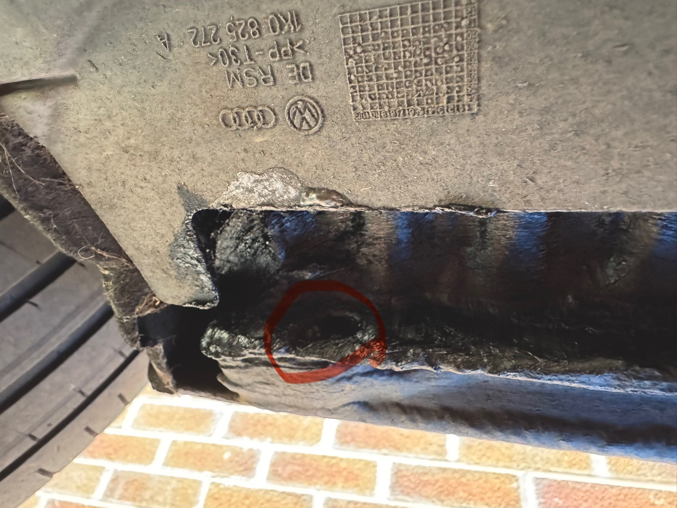

  19. This is at the front about 5-10cm in from the front box section. It’s definitely there on purpose. I think it’s covered in seam sealer on the other side as the hole is a lot smaller and you can peel it back. How old was your Octy when it started to rust? Good idea on the bung. I can’t believe how immaculate the sills are on mine, apart from where some daft tyre centre has jacked it up. Rear subframe has plenty of surface rust on it though.
  20. It’s the weird shape that makes me think it’s not a drain hole but there is no corrosion on that sill at all. Weird.
  21. I was thinking the same. The only reason I have my doubts is because the hole is quite jagged. Not a perfect round circle. I’ll let the waxoyl dry off and then try and get some better photos. It looks like there is seam sealer inside the one hole.
  22. I have circled the holes as they’re quite difficult to see on the photos.
  23. I have been waxoyling the sills and subframe on my MK2 fl Octavia VRS today. There is no visible corrosion on either sills they’re absolutely immaculate but there are two holes in each sill. They’re about 5cm in from the front sill, the same shape and diameter. Now looking at them, they look like corrosion but the metal is solid and there was no rust around them at all before I put on the waxoyl. Is it corrosion or is there a bung missing or something?
