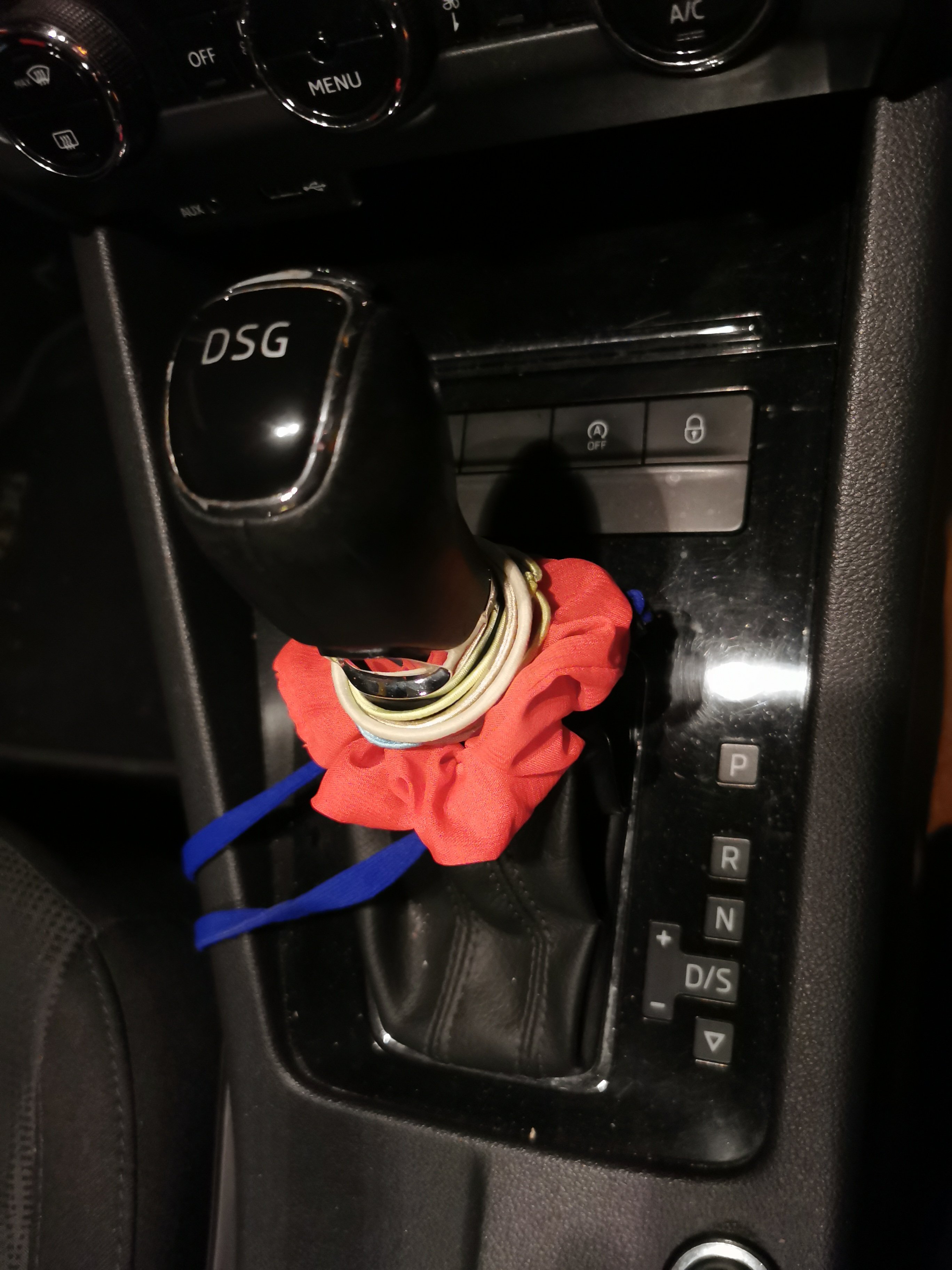

Well a week has passed. I made the amazing discovery of a sports mode earlier in week. Bit of a difference in the car ie a bit more responsive. Had no noise all week even when I was in the sports mode for the singular journey. (didn't need to be revving up as the area us full of 50 60 and 80 km zones) . However I was taking off on a hill after a short break from a previous 30 min drive and was stopped talking to someone while still in drive briefly and when taking off the notorious squeak appeared ever so briefly. Suspicions aroused I listened whilst I parked at my own place on a street with a hill. And while straightening up the car going forward to parallel park a little squeak again. Def sounds like a sloping fan belt but need to get checked. Anyway with that in mind I took of up the hill out of my soace and also switched to s mode and too' fit a little spin down the roads. No squeak was heard at the 2 junctions I took off from. Rrurned to my normal spot and as usual finished parallel parking by taking off or mznouvering up hill to straighten the car up and not a sound. Coukd this be a break calipers or disc and pads rubing I wonder as being the dsg I would have em pressed each time at take off and they'd be realising. I have noticed in past a bit of knarling in the breaks at the first stopping in the morning especially if it was wet the evening before parking up. Puzzled for now

Thanks for that. I would never have known I even had that choice until now. I was reading the book and when I hadn't the button I said I must not have the choice. Thanks a mil

I must try that later. I never went pase D ie flicking it down. I briefly tried the manual mode once just to check it out. Thanks for explaining to me. So basically flick it on down past D for sports mode and does it automatically go back to norm once I stop ie shift back up past D to say park P or reverse or R reverse.

That's it there. I assume the s beside the D is for the shifting the gears manually in the +/- ie manual gear selection.

You have me lost. On my car I only have a dsg box with the usual P R N D and the plus and minus to side. Around thar I hava a button for lock doors abd the start stop immobiliser. Iv read a few places re the driving modes and liked at the book but couldn't find where one can select these modes from. Be glad to know and also try your suggestion.
