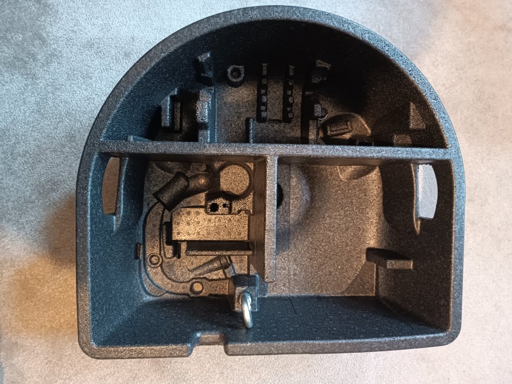

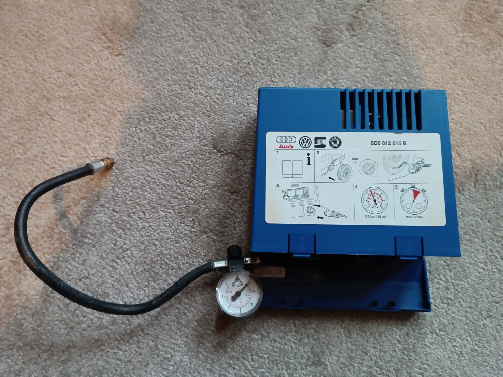

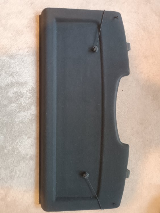

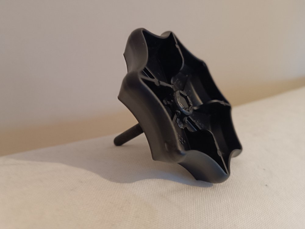

  2. Styrofoam Boot Storage Compartment – Includes a tyre inflator, screw-in tow hook, and other small items. £30 Parcel Shelf – Used but in good condition. £30 Boot Divider Grille. £10 Spare wheel attachment bolt. £5 Free with any of the above items: Original Fabia mat set (used but still has some life left). Collection in or near Reading, Berkshire or Swindon, Wiltshire.
