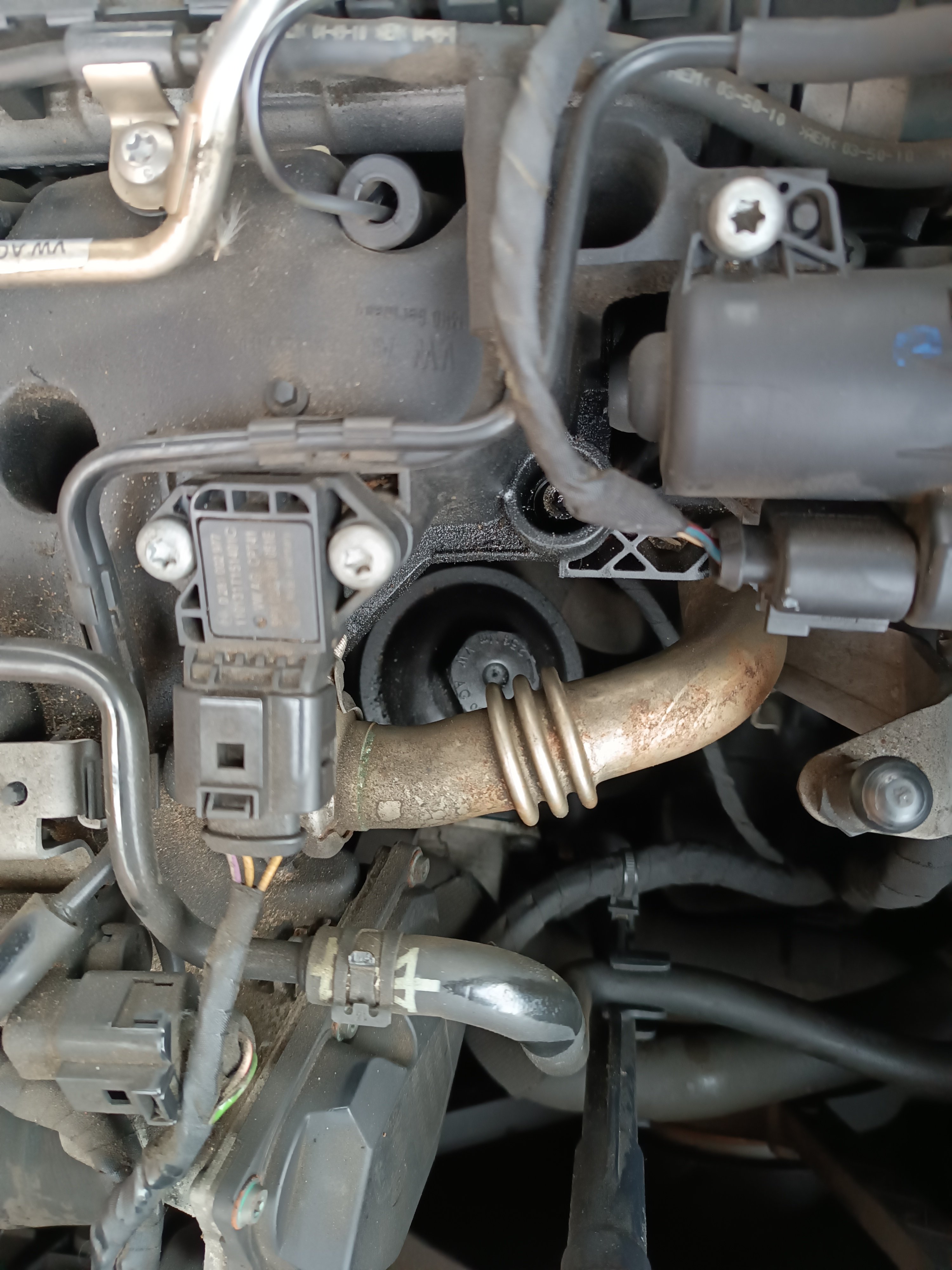

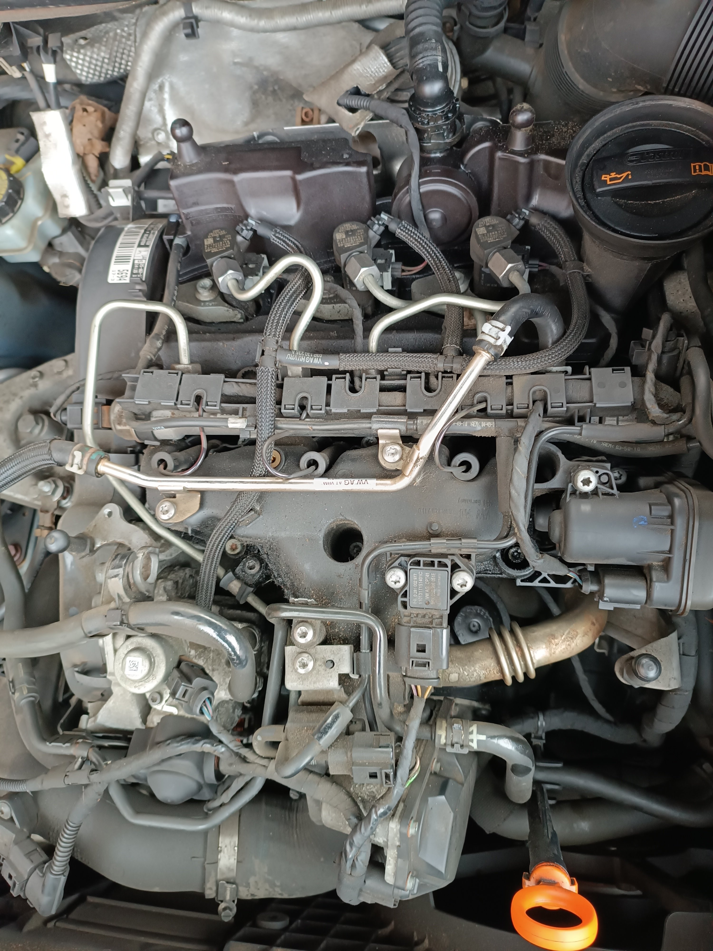

  9. Thank you Murdockman. I think the swivel knuckle adaptor was the key element missing in my plan.
  10. Hello fellow Skodians, I have a Fabia MkII 1.2 diesel and would like to change its oil filter (as part of an oil change, of course). All the videos I found online describing the process focus on the 1.6 model, where the filter is easily accessible after temporarily removing a small part. However, in the 1.2 model there doesn’t seem to be an obvious way to reach it. There's a pipe (EGR?) in the way so the angle is too tight to get a ratchet extension bar down there. Please, see the attached photos. I'm a noob when it comes to oil filter changes, so I might be missing an obvious step. Thanks for your input!
