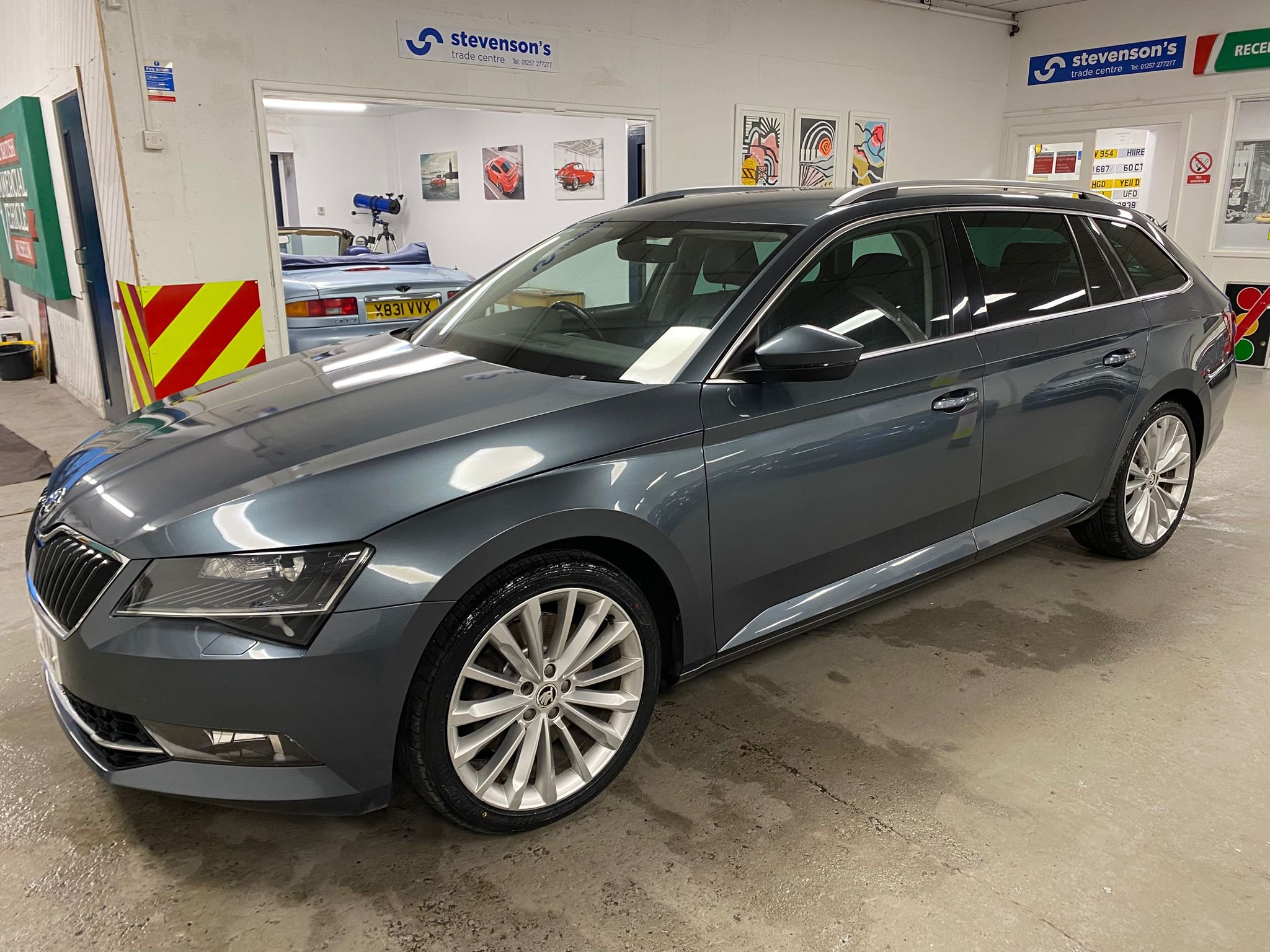

  2. Haven't posted for a while but thought I'd give you an update.. so the car has been down to Retro Resus near Taunton and had a PowerMax 1 fitted and an Ecotune remap and DSG map too. Target was 400 bhp but so far we've only made 380. Temperatures were running very hot, limiting power so the car is booked back in to have a new Aircon rad fitted. Plus they found a couple of other issues.. The coil packs needed replacing and the injectors need sorting. So fingers crossed, after another visit we should get there. Can't report back on how she drives as I'm having to keep a light right foot until the other bits have been fixed. Plus, I'm finding the power delivery very jerky. Like, head yanking off your shoulders jerky. I asked if there was a problem with the DSG map but the suspicion is the DSG needs a service so that will get done too. While it was in there I got them to fit the Golf R rear ARB I bought on eBay.. I can definitely recommend that as a low cost mod. The handling is much improved. They've recommended replacing the shocks.. they're pretty much shot.. not surprising after 100k miles I guess. Bilstein B6s are the recommendation. Need to save a few more pennies before I do that.
