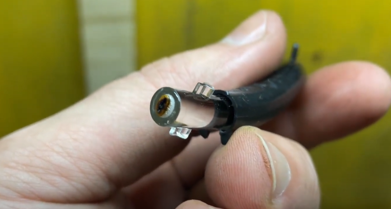

  13. Has anybody successfully replaced the LED strip? Controller didnt work for mine (LH is yellow, right is still white).
  14. Was hoping to get out of this cheaply by buying a new DRL controller, no dice. The actual LED driver is dying. Has anyone successfully repaired theirs? Going to have a crack at it next week and would love some insight into what was involved if so
