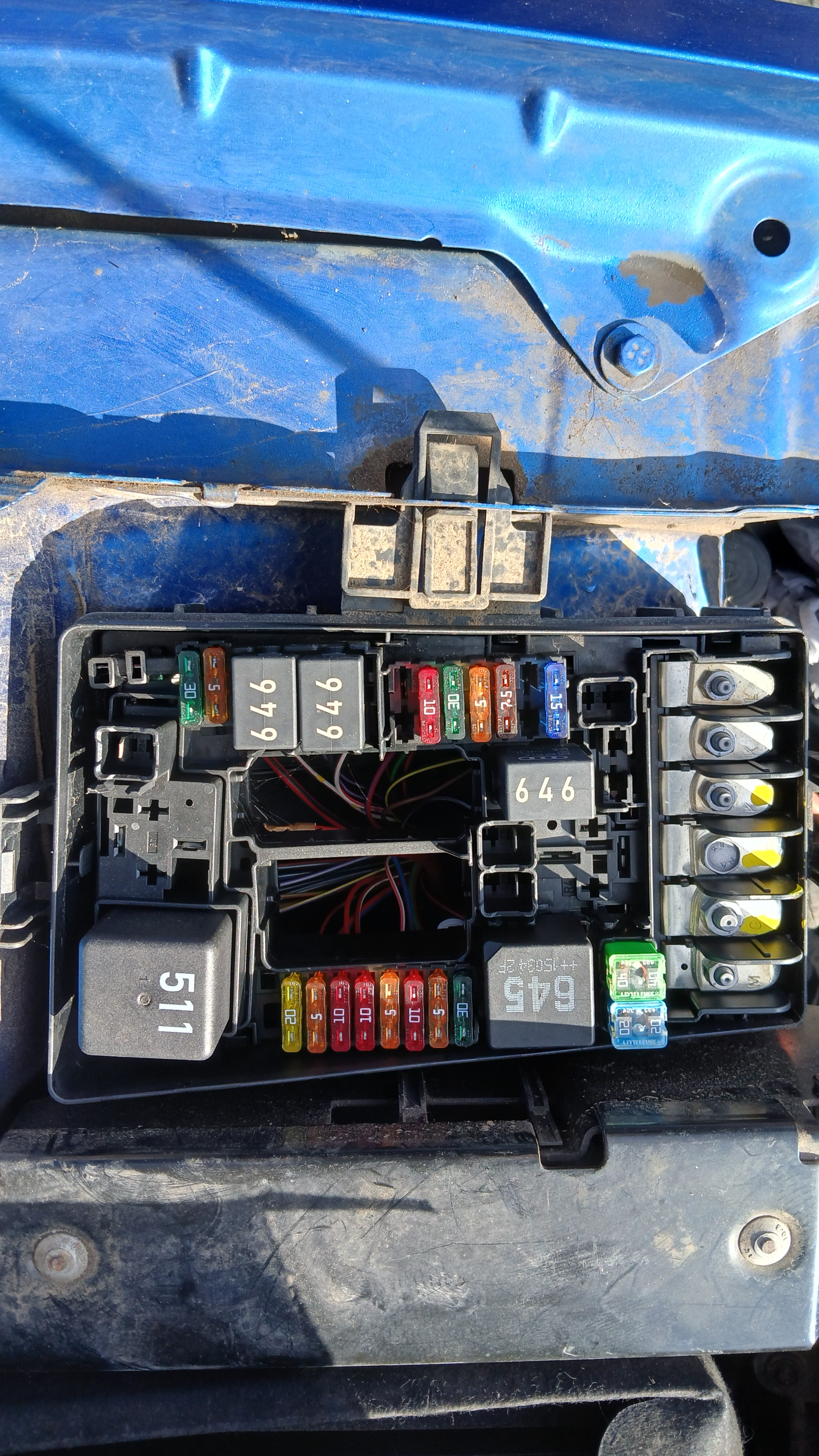

Hi all, Could anyone tell me the location of the fuel pump relay on this fuse board please. When switching on the ignition I'm not getting any noise from the pump but when I bleed the system (via OBD with Carista app) I can hear the pump work & fuel comes through, all be it not very quickly. I would appreciate any help as I've replaced the fuel pump & it only lasted 4 weeks before packing up again, this was replaced under warranty & now this one isn't working either, on top of that the battery is now running down so I'll remove it to give it a good charge before attempting anything else Thanks in advance
