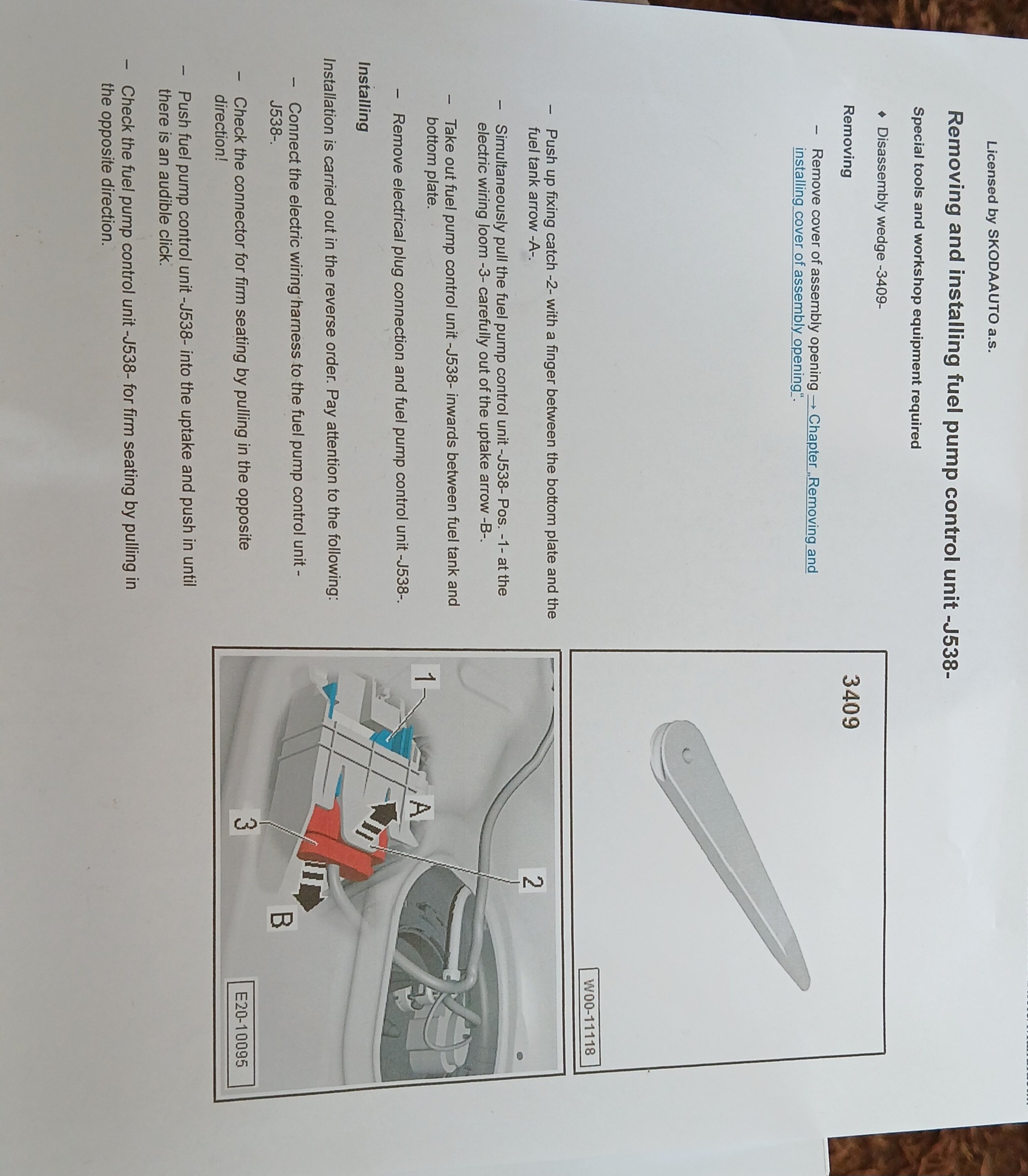

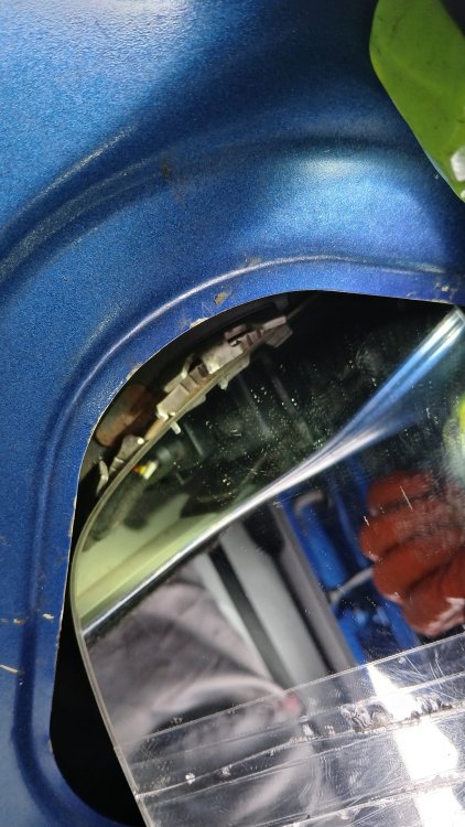

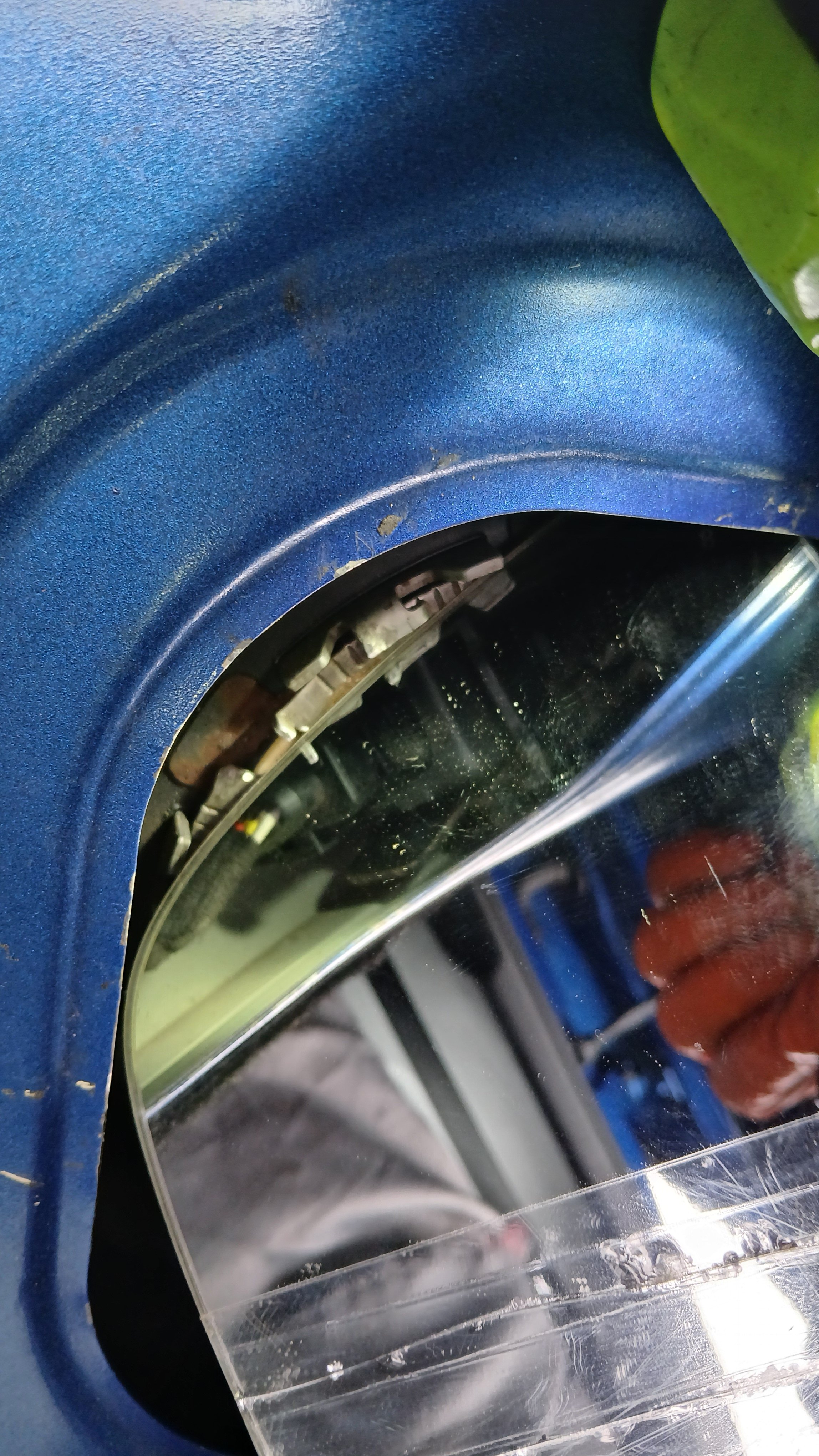

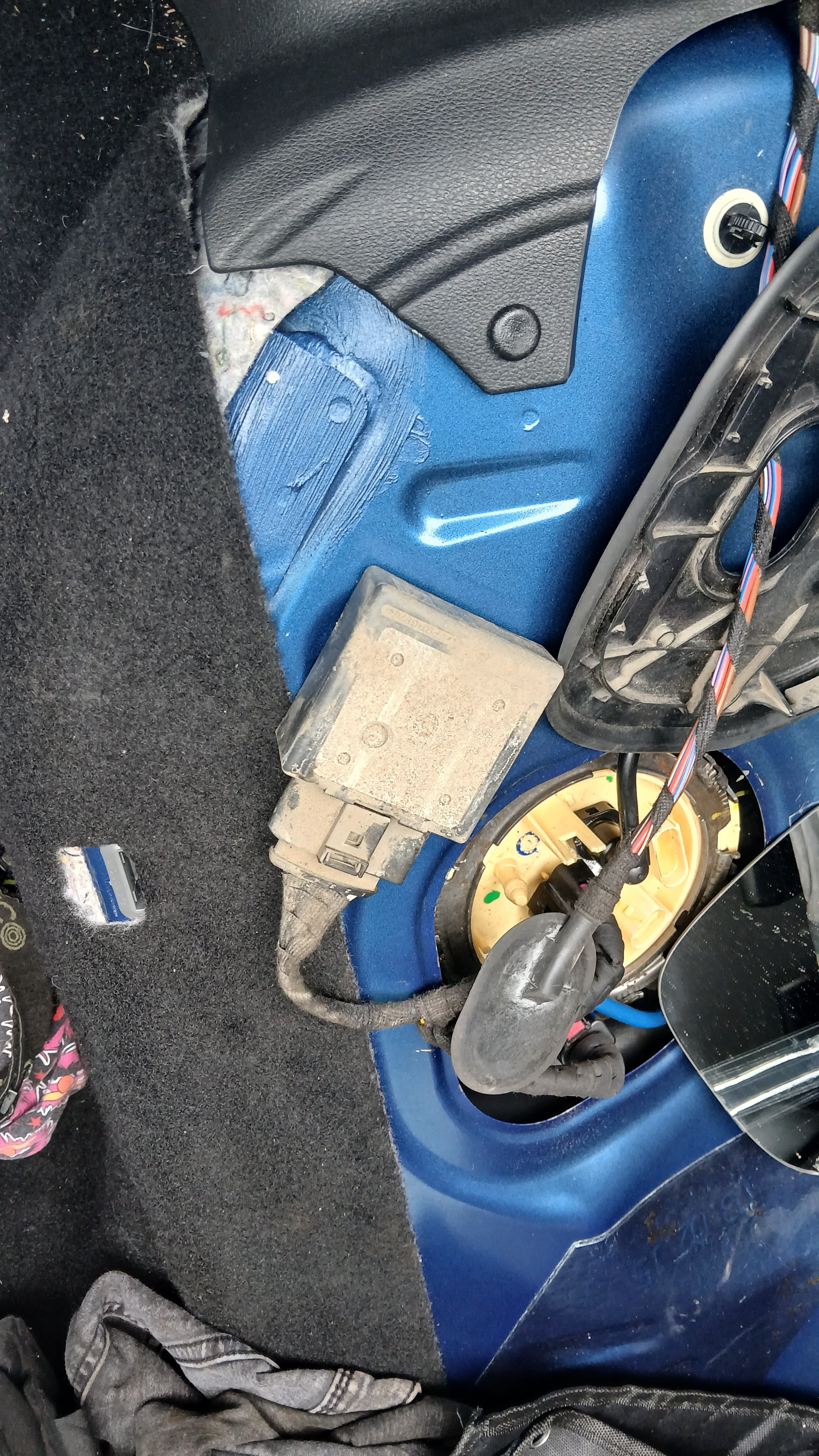

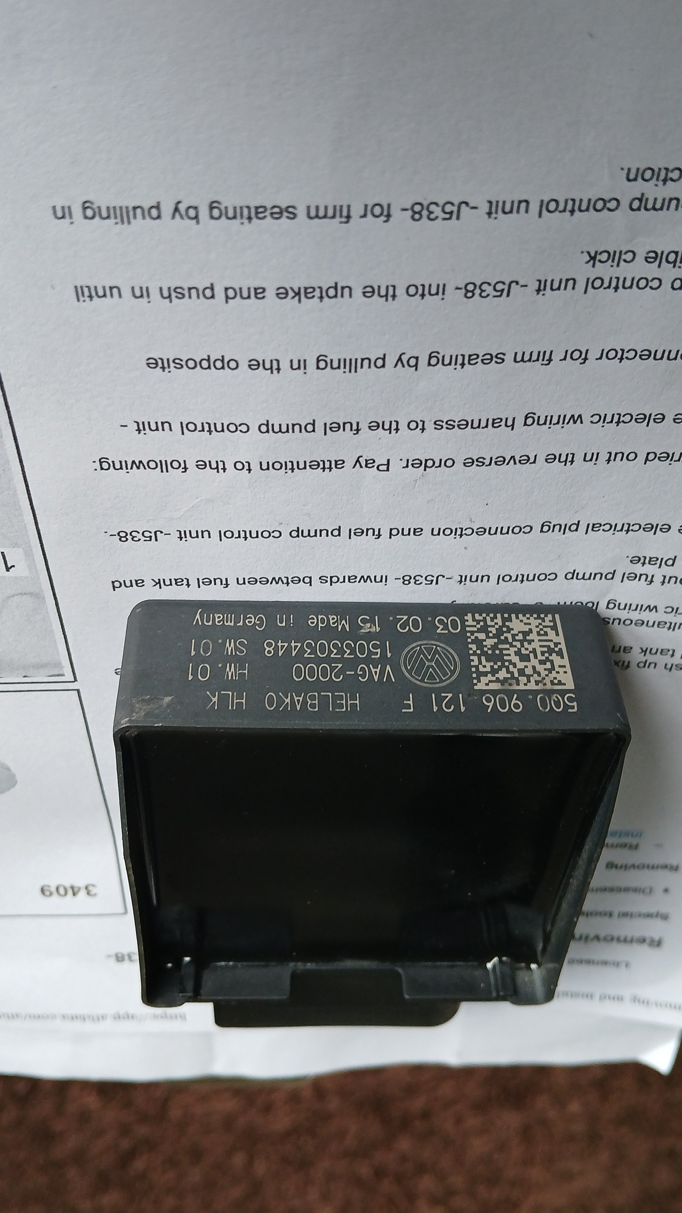

After some advice yesterday I'm about to order a J538 fuel pump control module which I hope will solve the issue
Update on the pump issue, having replaced the fuel pump control unit with a genuine 2nd hand one off Ebay £54, it primed the fuel through with ease & fired up straight away.
Previous fault codes included P0087, P3043, P304300, P3073, P308D,
After replacing no fault codes were found.
I've attached some photos incase it helps someone else.
