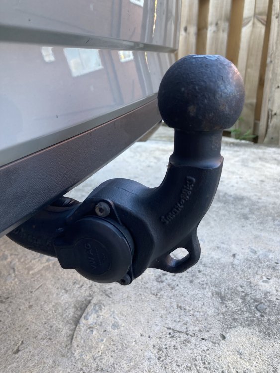

Is this the factory fitted towbar?

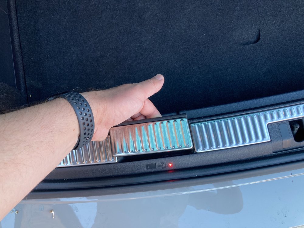

Might seem a daft question, but I only bought the car from Cazoo today. (Couldn’t find the spec I wanted anywhere else.) Was advertised as having a fixed towbar and was looking into replacing it with a detachable one as I only need it very occasionally for bike rack. The more research I did the more I thought maybe it’s the retractable factory one and it’s just not retracting. Nothing happens when I pull the bit up in the boot.
can anyone confirm if it is the retractable one and any ideas why it’s not moving and tips to get it fixed?
Thanks
Hi, welcome to the forum,  Yes, that is the factory fitted tow bar, there is a video in the Skoda Superb Guides on this forum. Pull the lever  in the boot up and the tow bar drops down. You need to manually move it into the locked position and again retraction is the reverse operation of pulling the lever up which releases the lock and you manually push it up into the rear bumper. The green light will light up when it is locked (either in the stored or towing position) if the red light flashes it means that the tow bar in NOT locked.

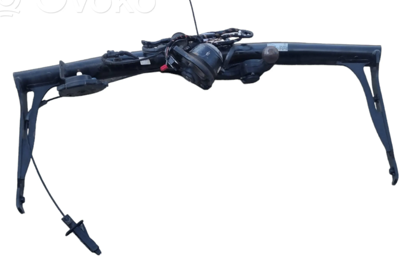

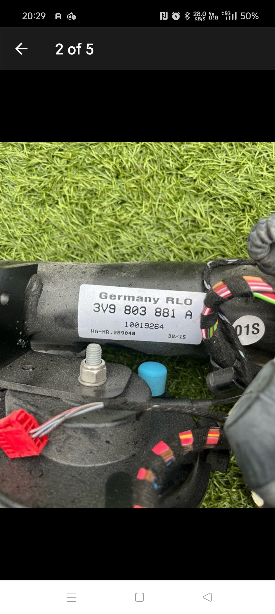

Do you know the part number of the tow bar. Im planning to buy one similar to it. However not sure if it is the genuine one.. Model number on the picture.. Thanks

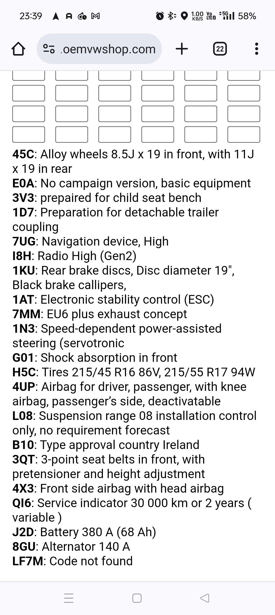

I've opened and checked the code 1D7 - preparation for trailer detachable coupling.. (only problem not sure if is just trailer or should be more for caranavan coupling)

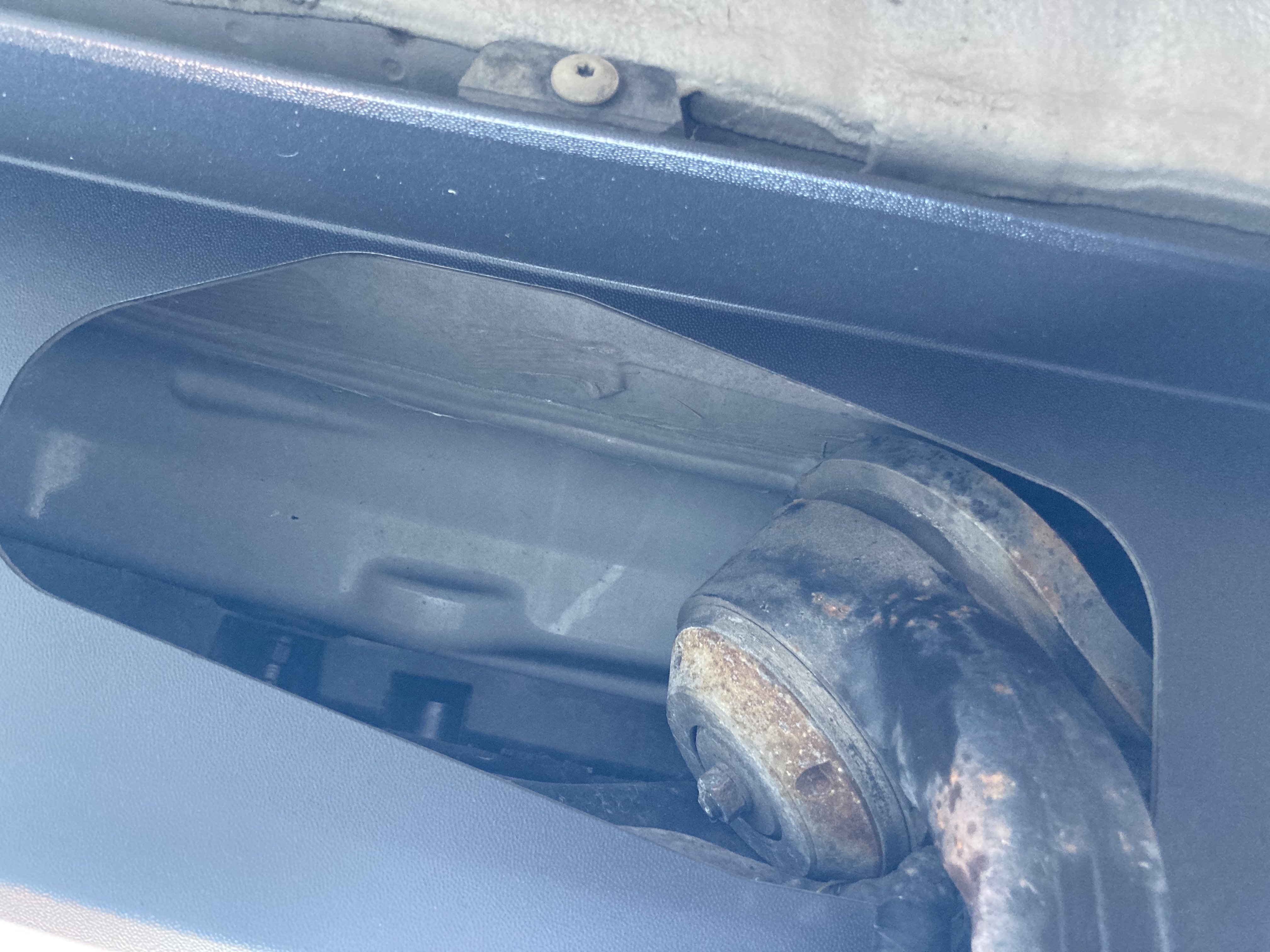

Does anybody know, which part on this picture is probably freezing, causing the hook in the boot to get stuck, when there´s minus degrees outside and is it a quick fix, or should i visit my local dealer to get it sorted out?
I think there're 2 possibility:
- Latch (to keep it in stow position) gets stuck.
- Rotation axle of the hook itself...
May be you can try to use some anti-humidity spray, because based on your sayings, I think there some water drops caused by humidity, which freeze and make your hook stuck. I don't think it's gripped, otherwise it wouldn't move as expected once it gets a bit warmer.
If you can get the car to a clean and elevated area, try to spot the pivoting mechanism, as mentioned above by Bap that would be the first place to look at.
Soon I need to replace the tires and when I lift it will look also, you got me curious ...
