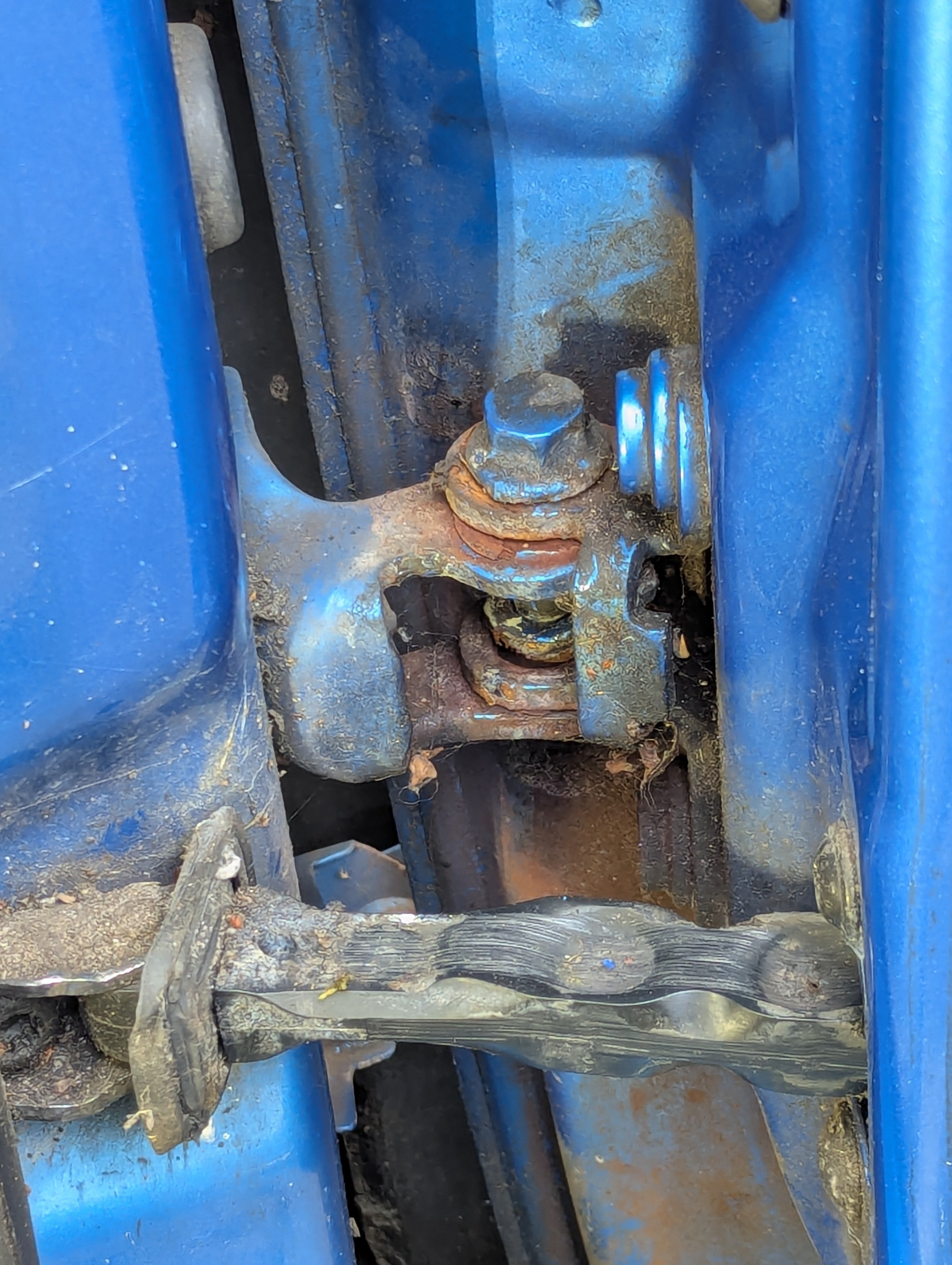

  1. Hi. Does anyone know of any detailed video or instruction on changing door hinges on a Roomster. I want to replace the bottom drivers door hing as it has worn and catching on the body work.
