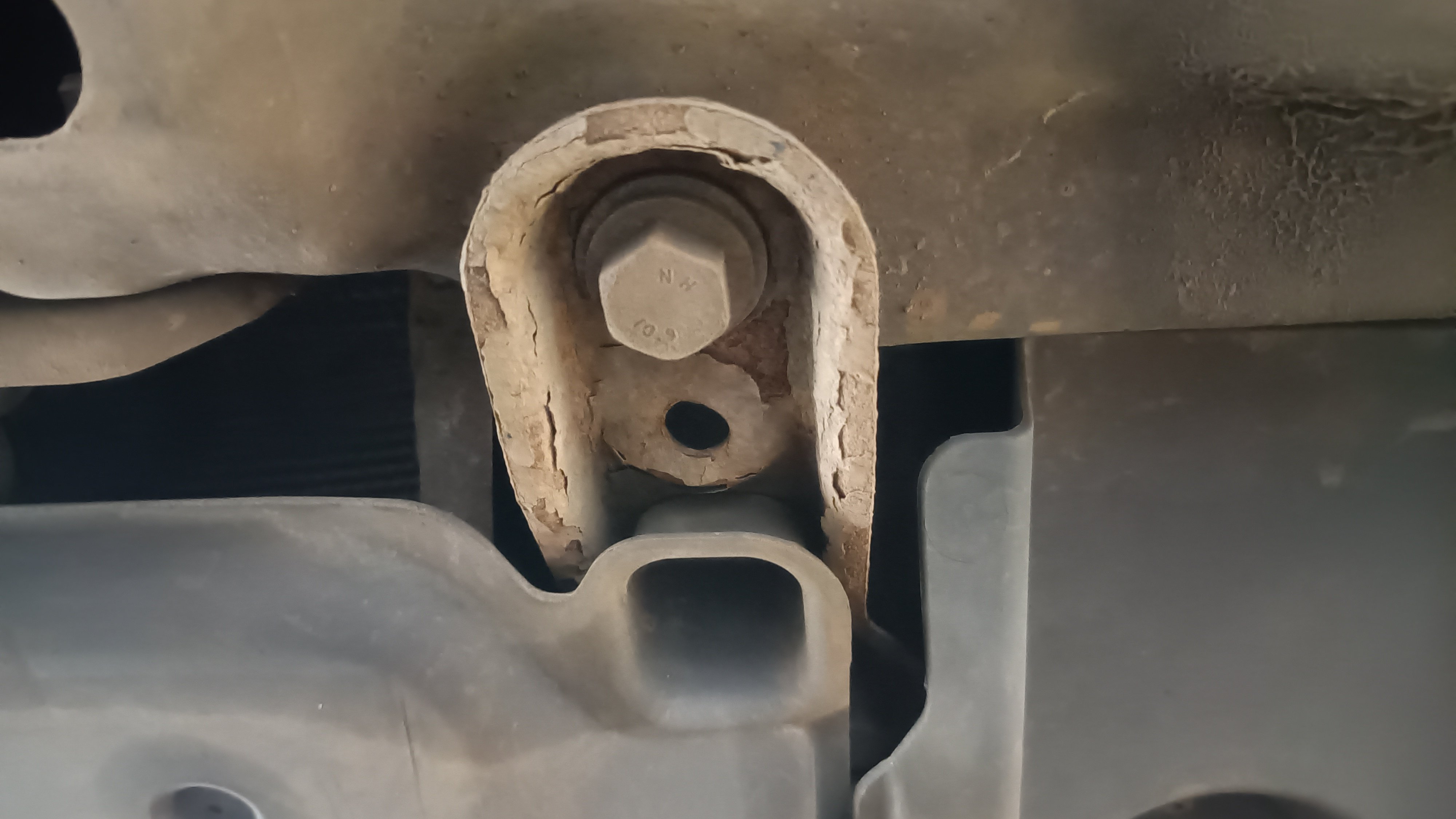

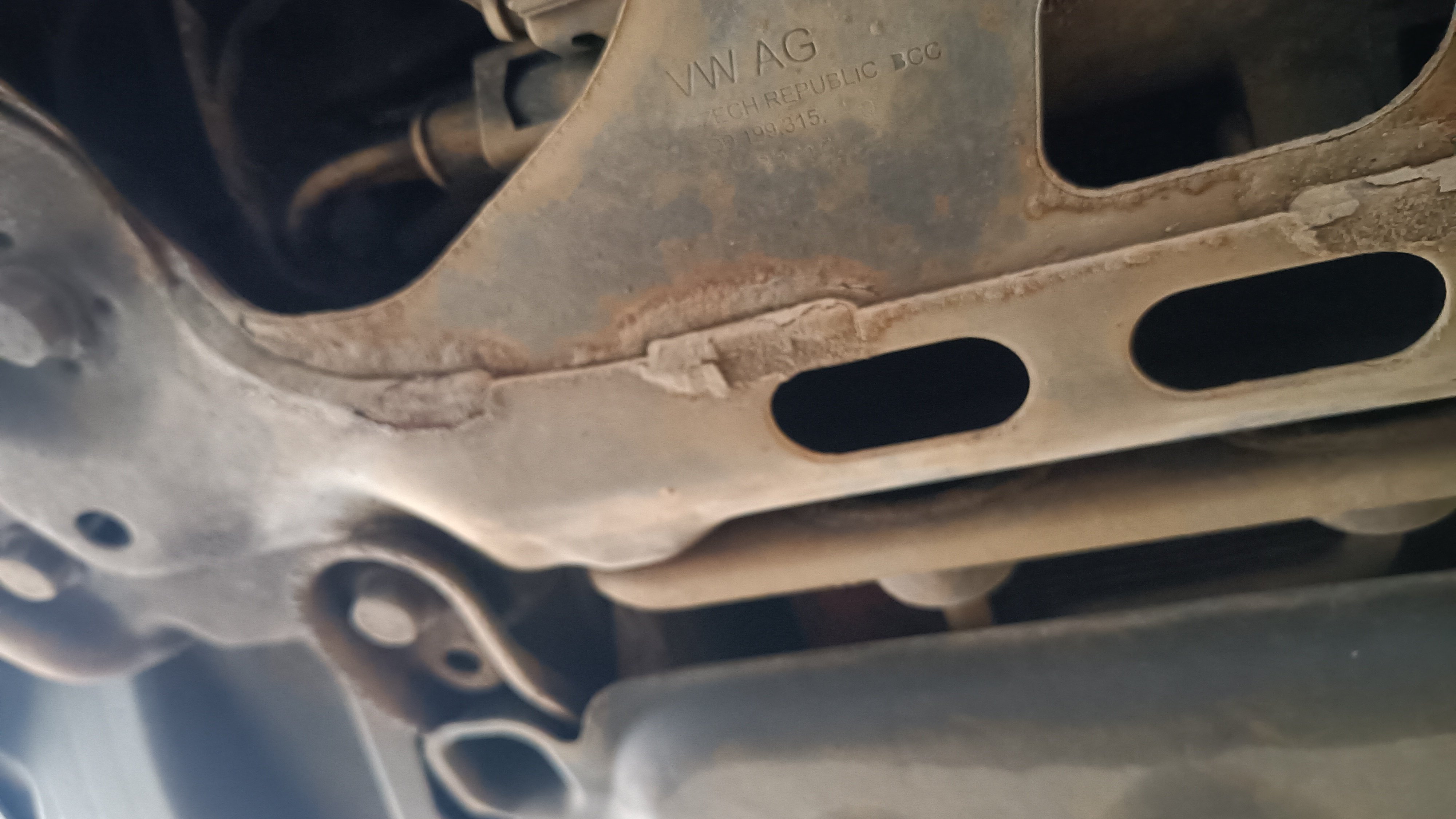

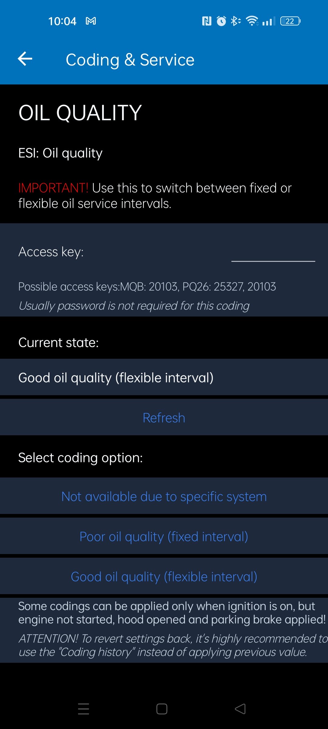

  1. I think not, those are the ones that hold the tray under the engine that I took off for oil change

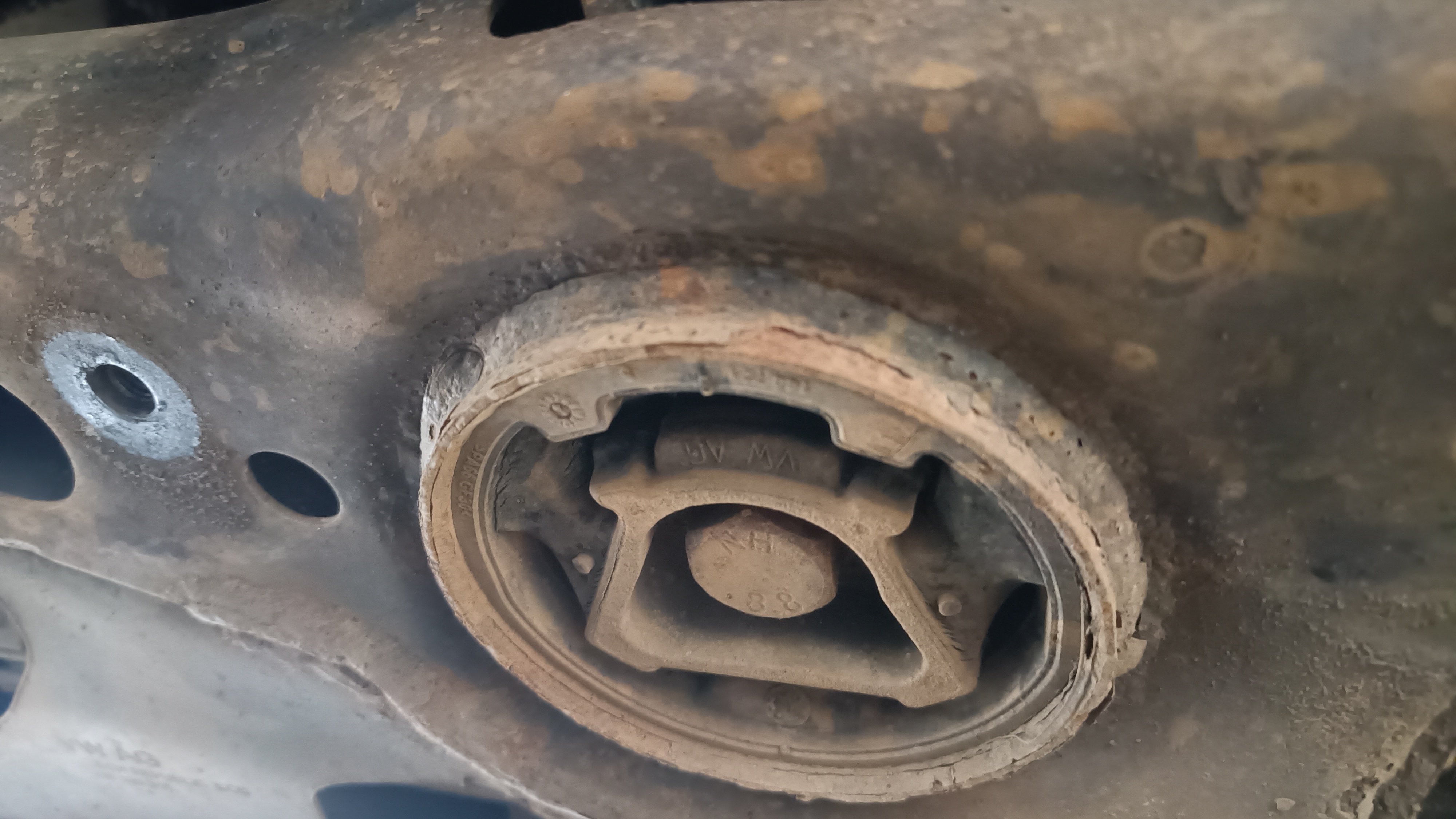

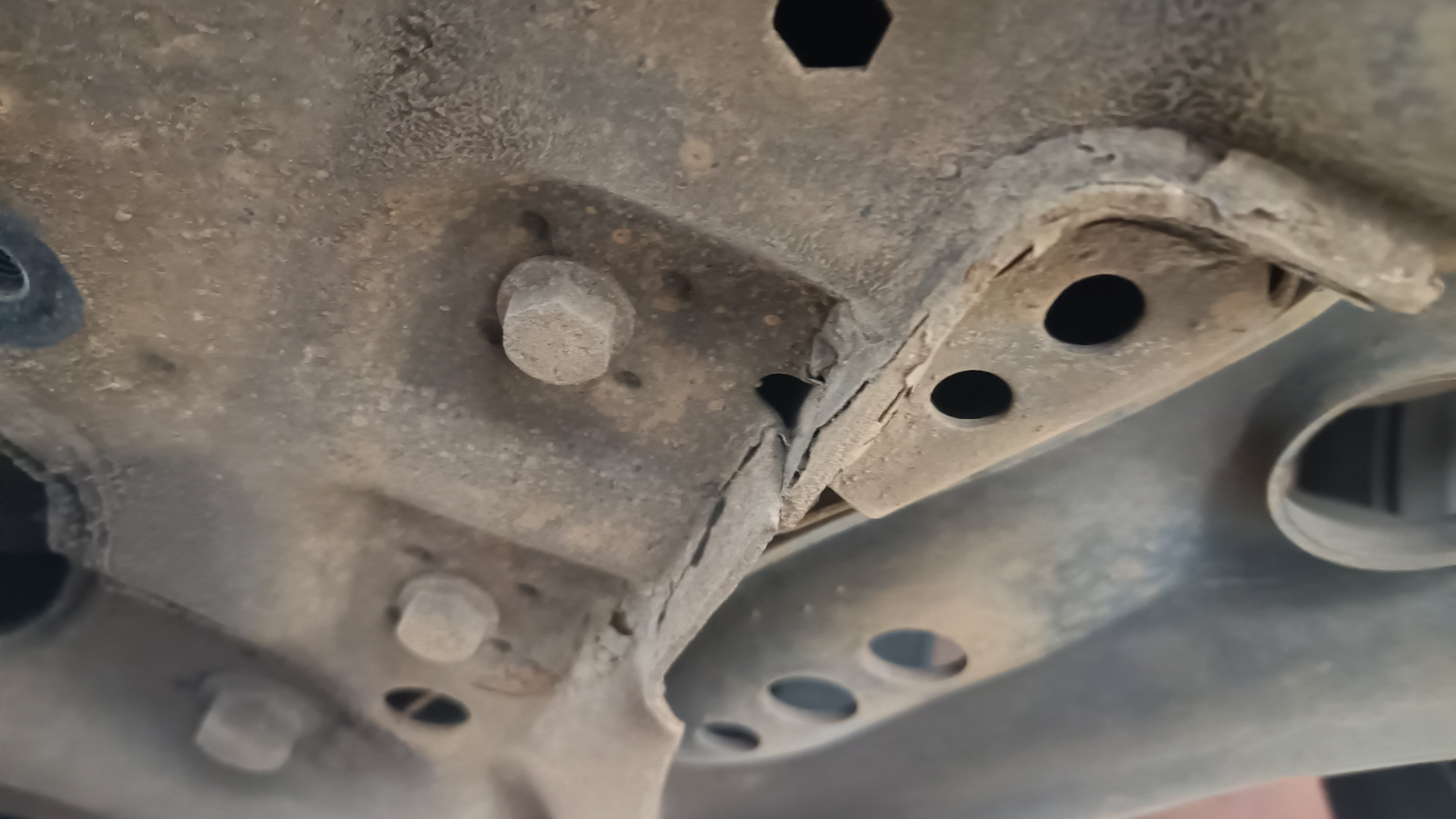

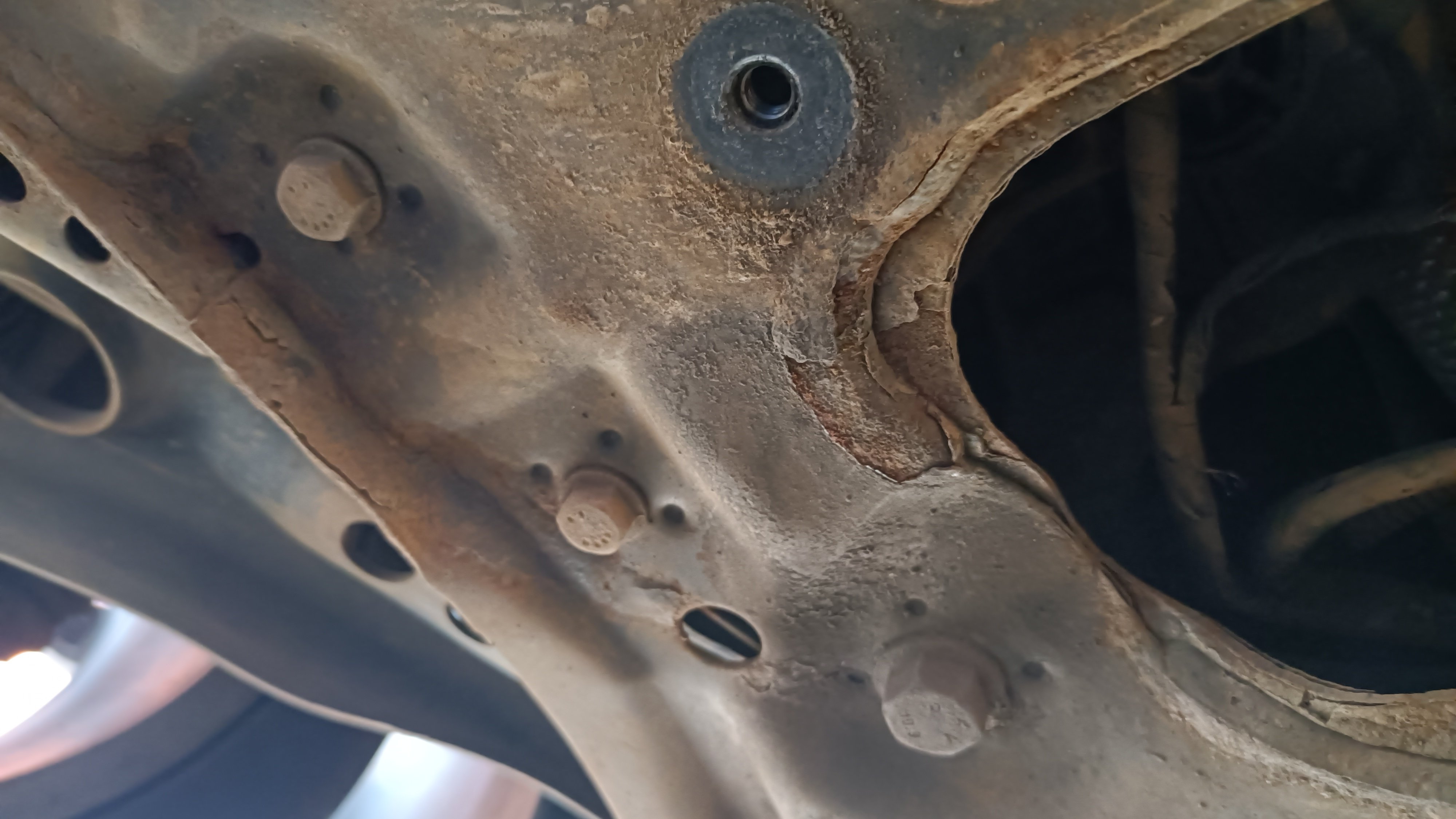

  2. After changing oil and getting very close, I could see some rust and shedding metal. How bad is this and what can I do?

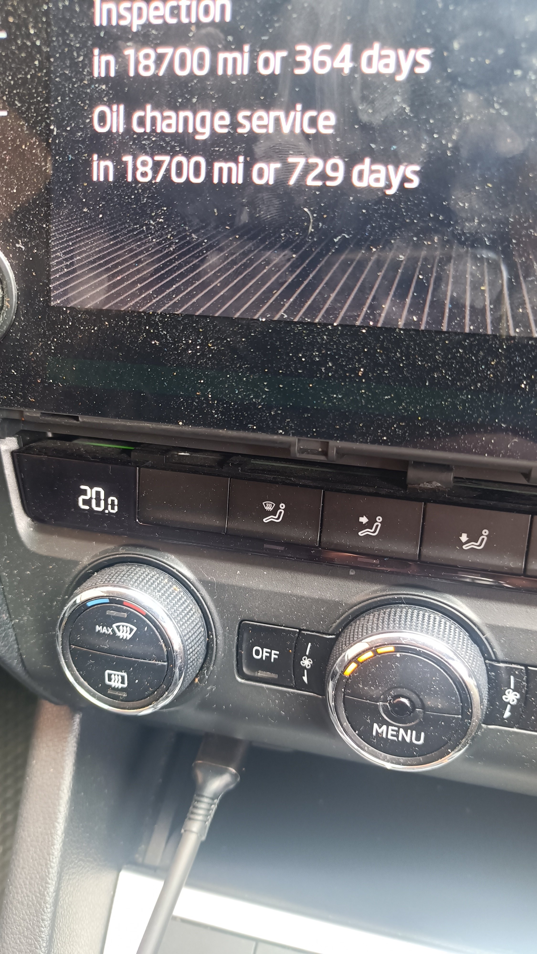

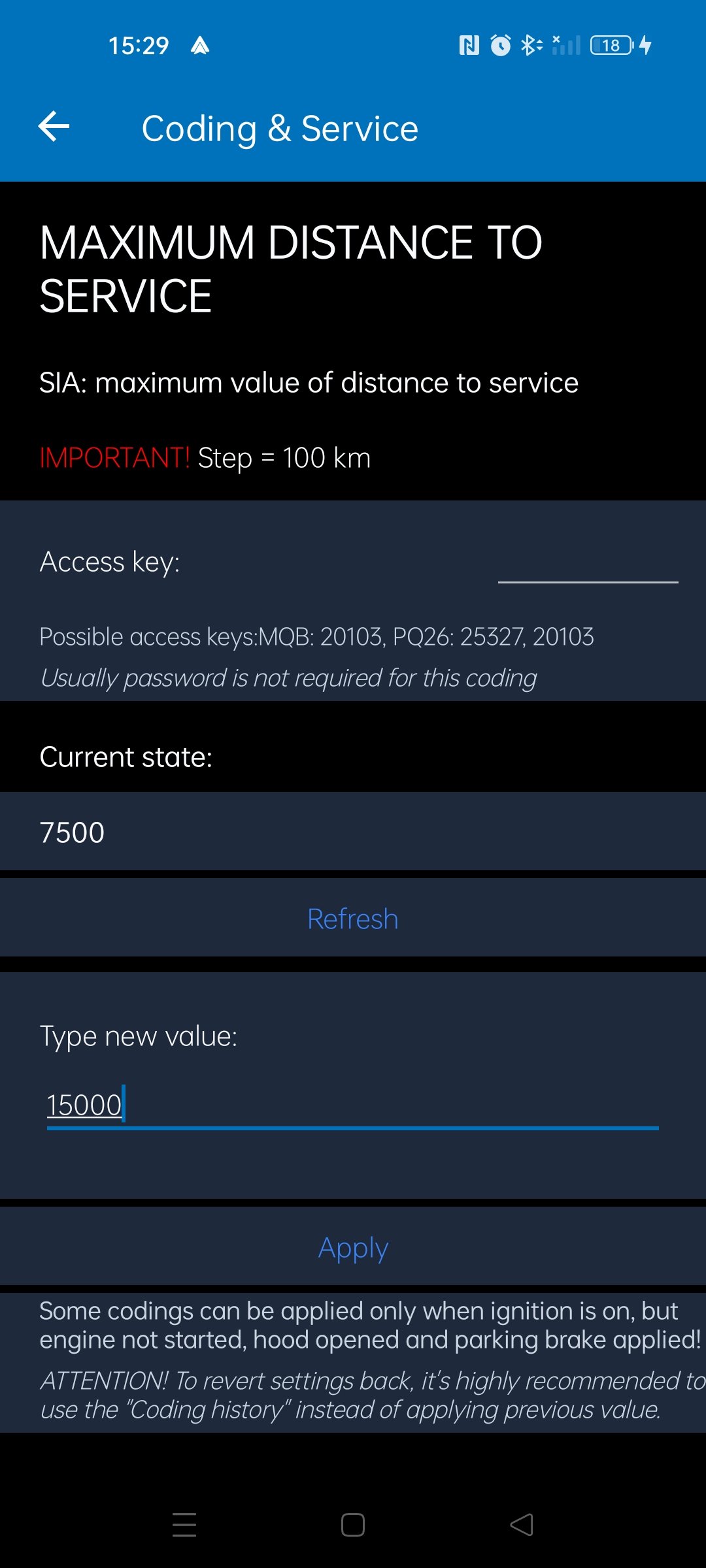

  3. Ok, I've got it. I've missed it because it was called "service" and I was looking for "oil" Set it back to "bad oil / fixed" and increased the mileage for next service Now it shows 9400 / 365 I'm using android "Car Scanner" and Veepeak OBD2 Scanner, in case this helps anyone in the future
  4. Yeah, I have only two options, good / flexible 18700 and bad / fixed 47 00
  5. Thank you all, have just done oil change and all filters as well (oil, air, fuel, pollen) Have also done the mini flushes, very nice tip, thank you @nta16 Now one thing I don't get is after resetting the service, it shows next due in 4700 / 365 days I connected to the obd2 and could change the"quality of oil" from bad to good, but then the interval jumps to 18000 Any idea how to set it to 9400??

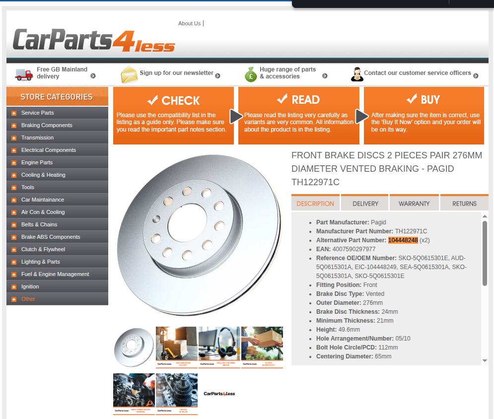

  11. thanks for the advice. I added my car to the "garage" in skoda-parts.com and it confirms the correct disc size is 276 x 24 I was looking for a Pagid brake, but checked other brands in auto-doc as you said and indeed they are in the expected price range. Part numbers are 5Q0 615 301 E and 5Q0 615 301 A. So I guess as long as I match this with the ebay or whatever cheaper seller I'd be good ?
  12. Hi, so I've been doing my research to try to find the right parts to replace my front brake discs and pads Car is a 2016 1.6 TDI 5E5444 CXXB I've tried https://carinfo.kiev.ua/cars but it is not working anymore it seems. I've checked my boot and there is only the code for my rear brakes (1KD) Then I paid for this ebay seller to get me the codes, and finally it is 1ZF: https://www.ebay.co.uk/itm/226517872578 So, looking at other posts, specially this one: https://www.briskoda.net/forums/topic/523409-octavia-10tsi-2017-disc-size/ And checking pics of my caliper as well, I believe I have the 276 x 24 disc I checked ECP, Halfords, Autodocs for Pagid and they seem quite expensive, around 100£ per disc :( And then I found these ones in Ebay, which seems to be the right fit, but I am just suspicious because they seem way cheaper than others. What am I missing here? https://www.ebay.co.uk/itm/297097800580 and https://www.ebay.co.uk/itm/405418704508 Can anyone confirm these would fit my car? Thanks!
