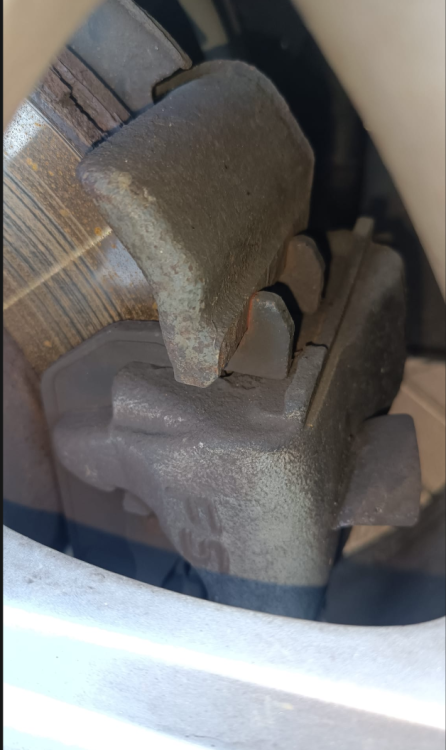

And checking pics of my caliper as well, I believe I have the 276 x 24 disc

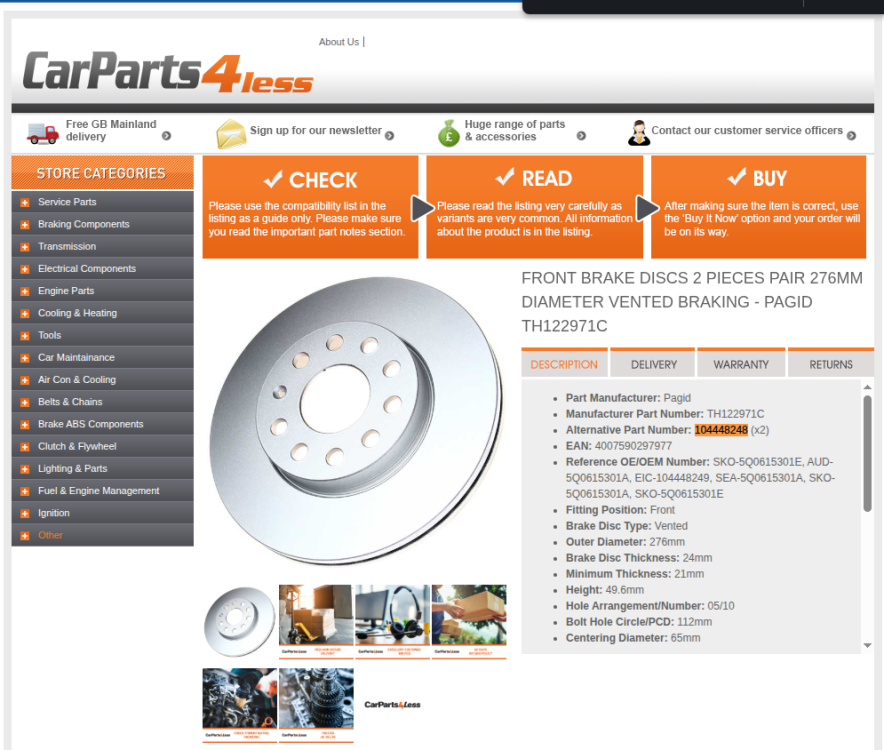

thanks for the advice. I added my car to the "garage" in skoda-parts.com and it confirms the correct disc size is 276 x 24
I was looking for a Pagid brake, but checked other brands in auto-doc as you said and indeed they are in the expected price range. Part numbers are 5Q0 615 301 E
and 5Q0 615 301 A. So I guess as long as I match this with the ebay or whatever cheaper seller I'd be good ?
