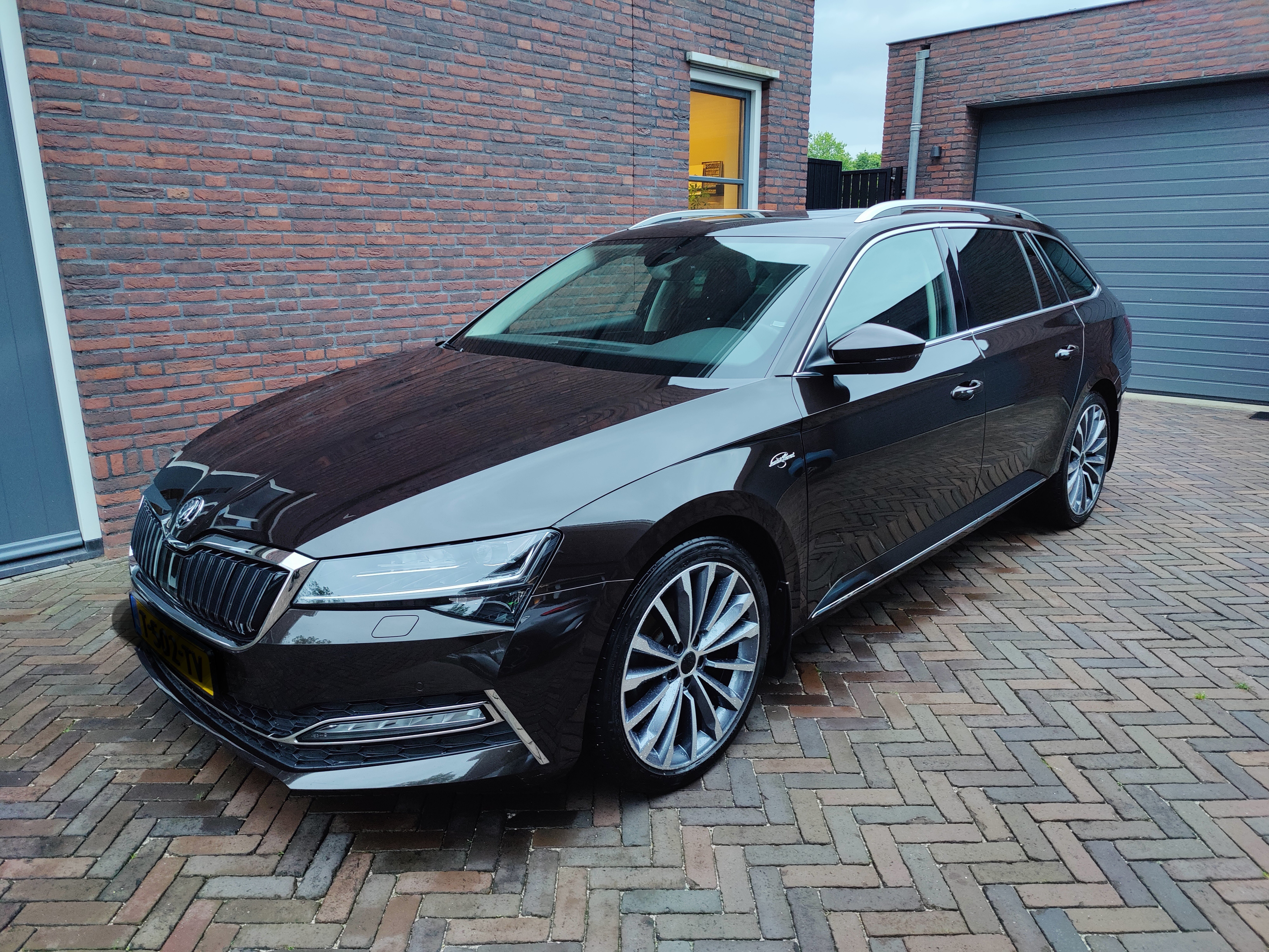

  4. My 2020 Magnetic Brown Superb IV, with in my opinion the best wheelset 19" Phoenix.
