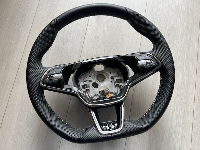

I have a Skoda Superb 2015 L&K and had desire to install a new sport 3 spoke steering wheel from new Skoda :)
Parts:

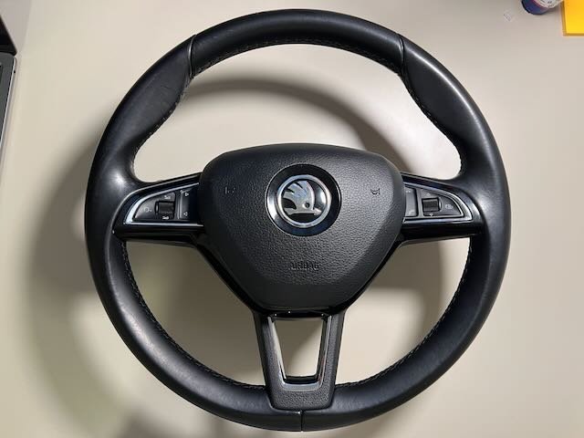

1. Steering wheel from Skoda Octavia A8, bought used, like new ~93 EUR

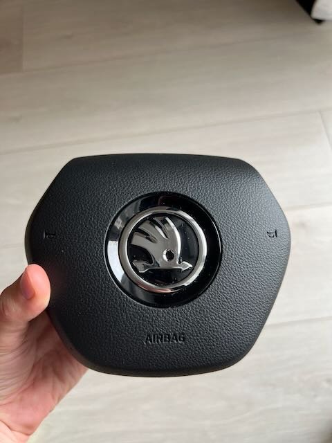

2. Airbag from Skoda Octavia A8, like new ~185 EUR
3. Steering Wheel Plaque / Badge (5E3419685G041 — black, 5E3419685FDPJ — SportLine) cars-equipment For 2 spoke wheel it's different

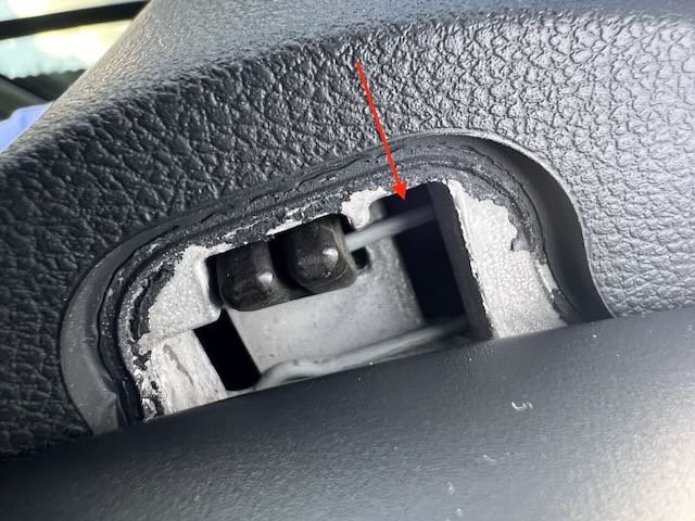

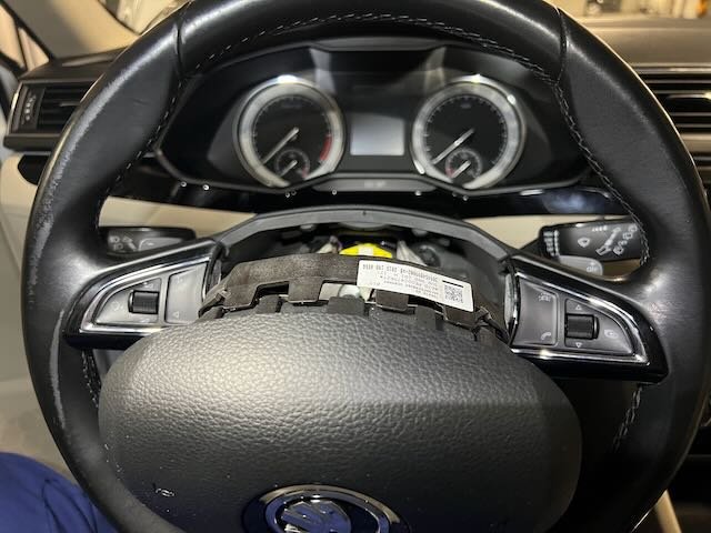

Removal is very simple, turn wheel to 90 degree and unplug with short screwdriver; and then from another side.
Disconnect battery.

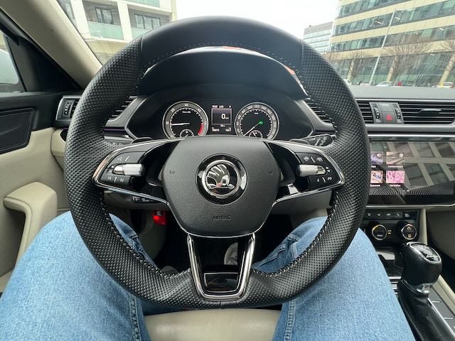

Final result
All buttons work except TravelAssist(top right), because 2015 Superb doesn't have it. But I switched it to Phone by changing coding.

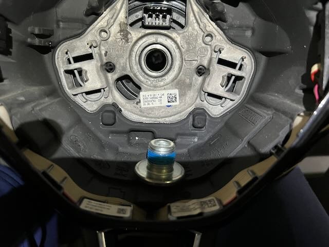

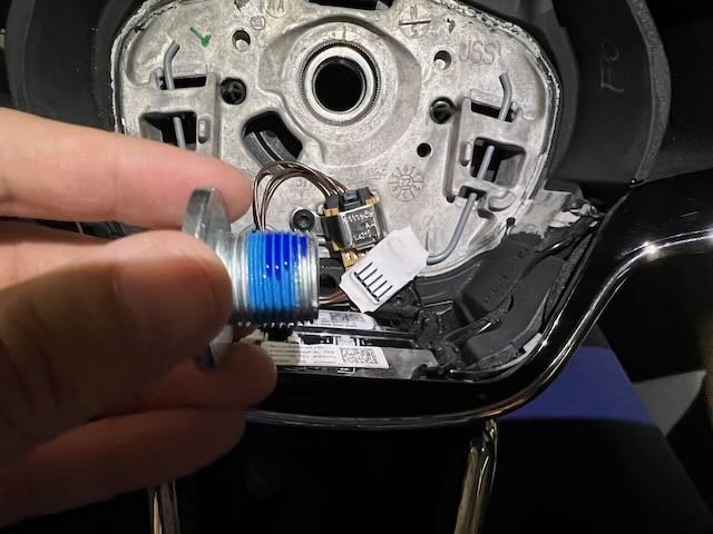

Very good thread and guide.
the only thing id note is the main screw for the steering wheel. Don’t put fresh loctite on it! The correct method is to mark the face of it with a centre punch and refit with no fresh loctite. The screw is good for 5 reuses (a centre punch per reuse) and only after that does it need replacing.

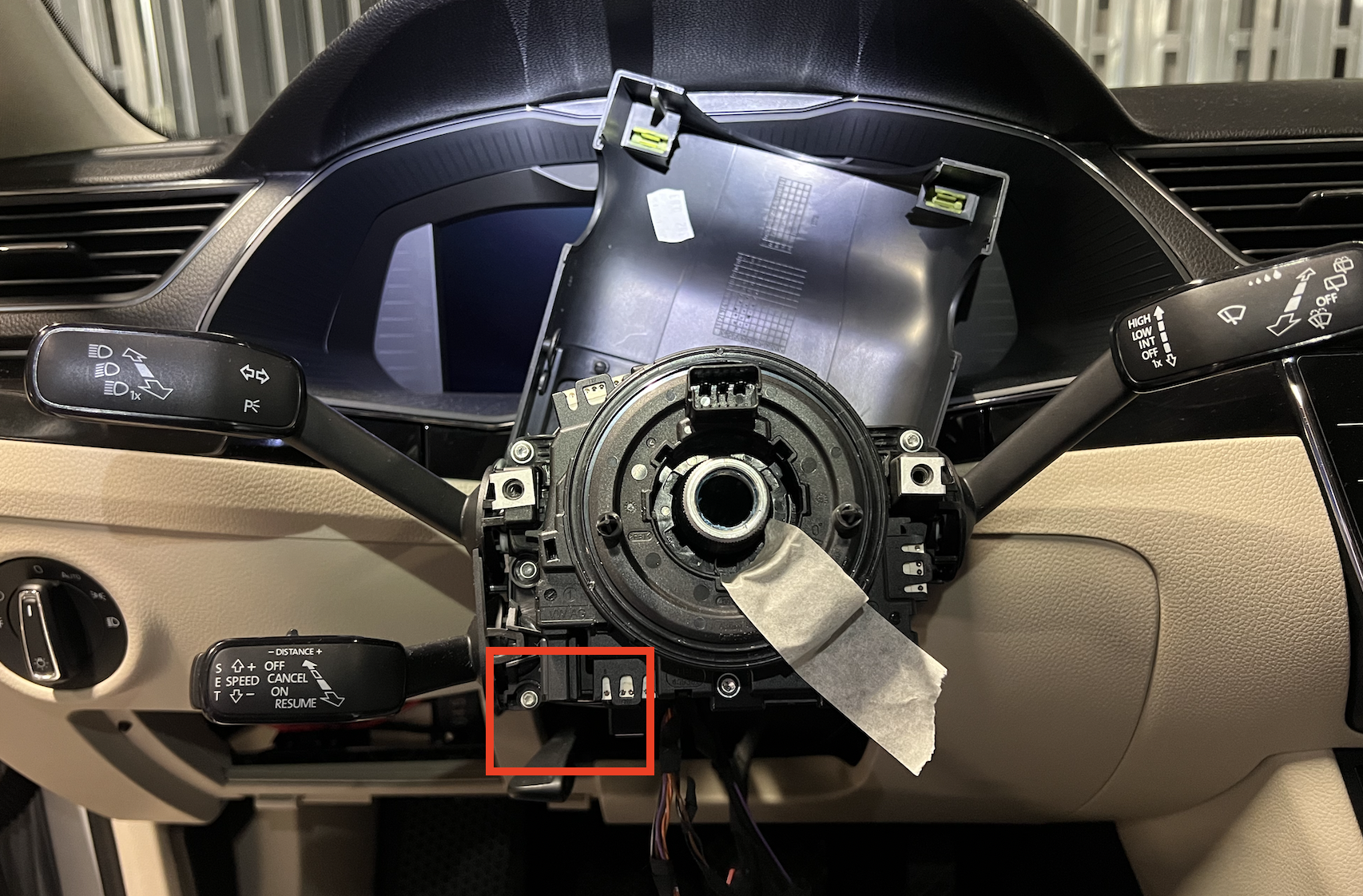

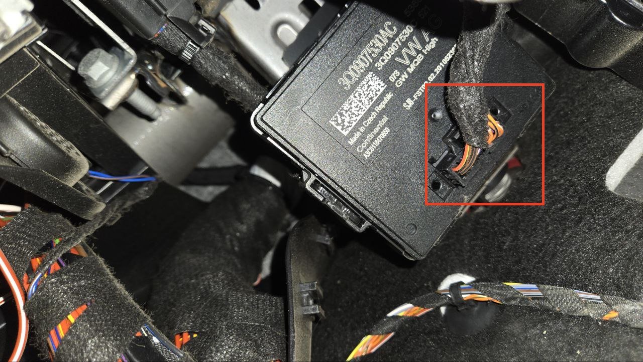

Hi Zacko, thx for the reply. Seems like a decent fix. One question, do you have pictures where either of these locations are in the car? The Gateway connector or by rewiring the connector of the steering column electronics control unit (J527).
Gateway located above pedals
(J527) - is a steering wheel tape unit
