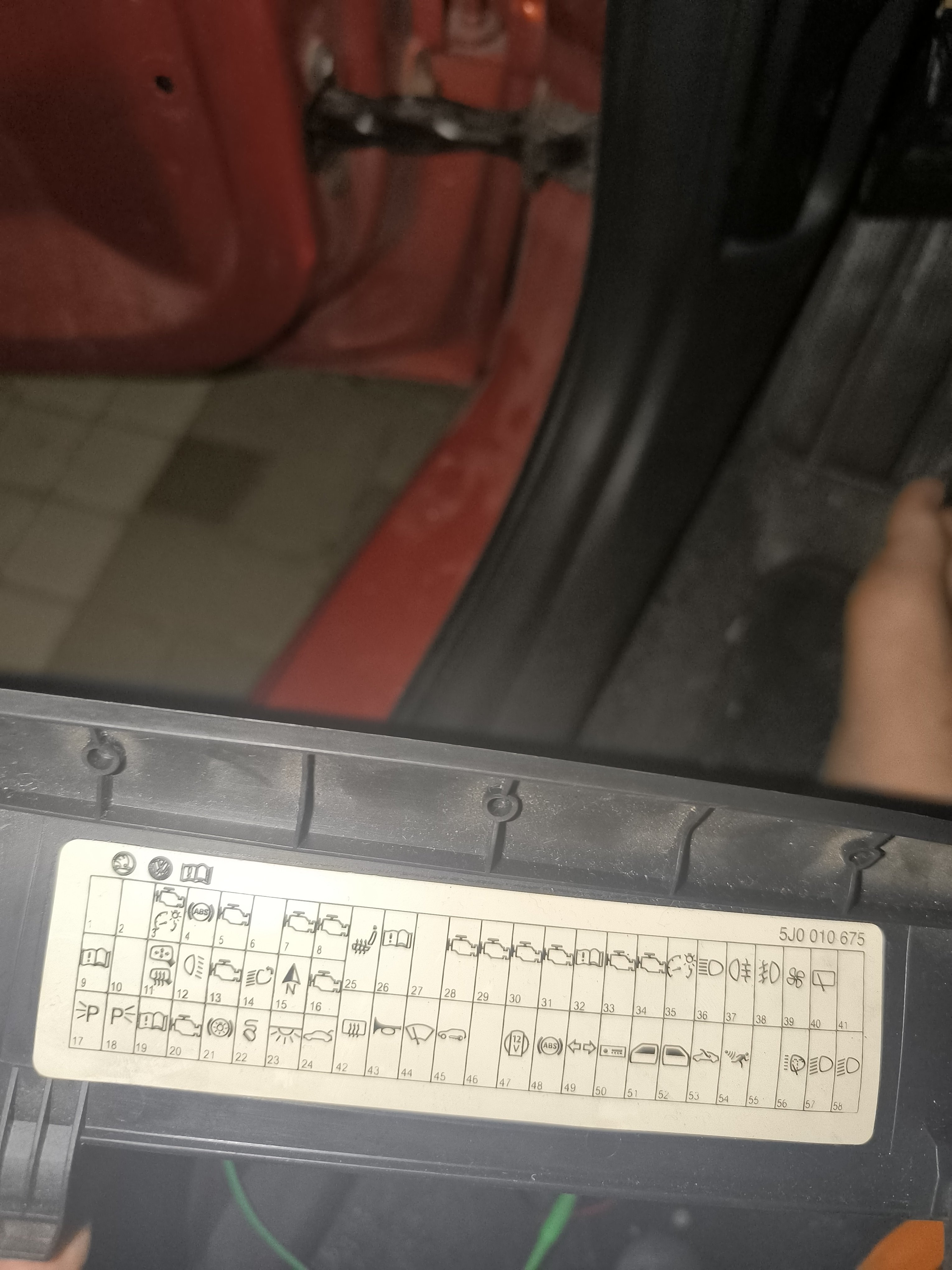

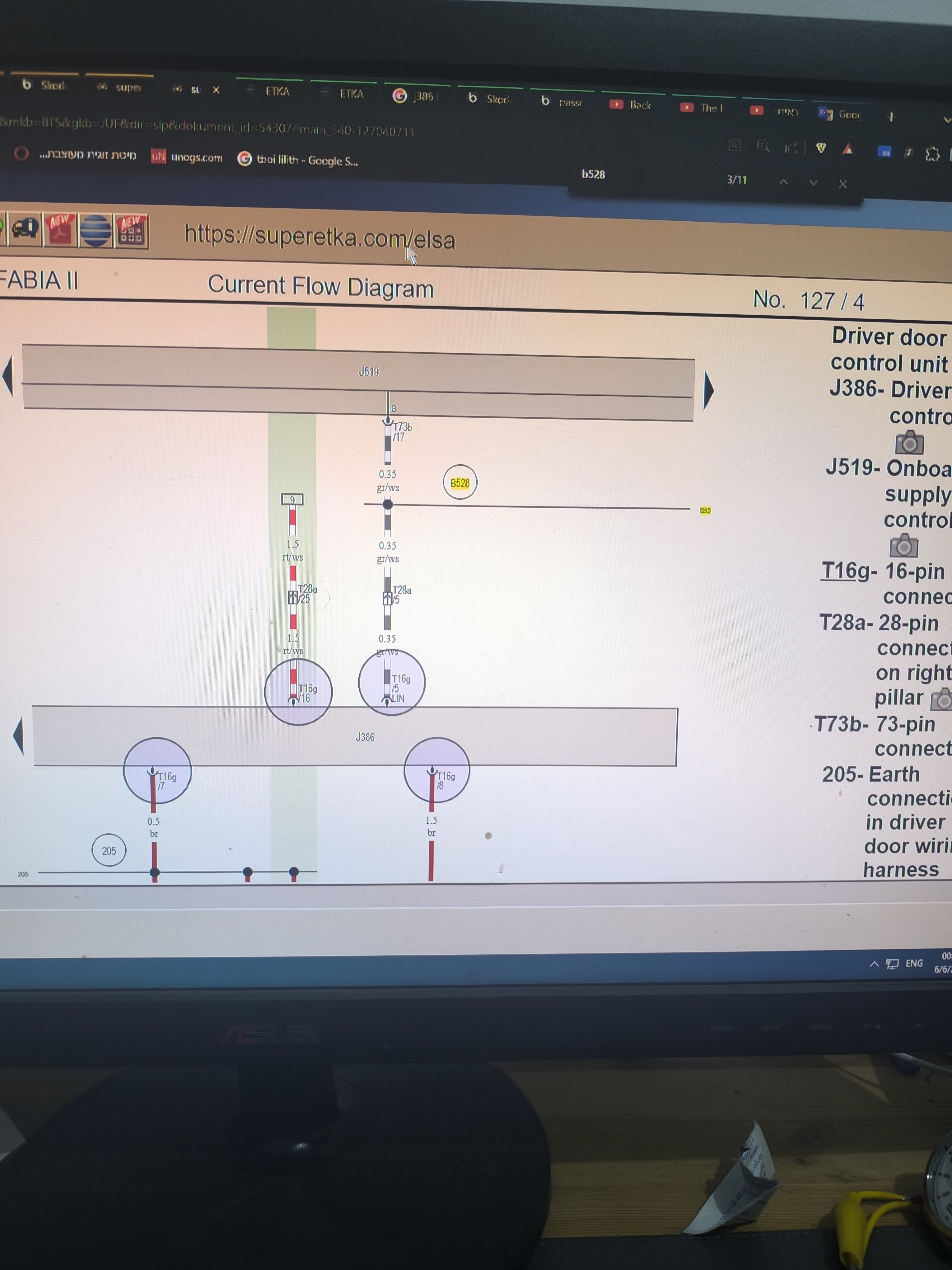

  4. Thanks alot for the new and correct diagrams, i have just checked fuse 11 and unfortunately it is fine and no problem there

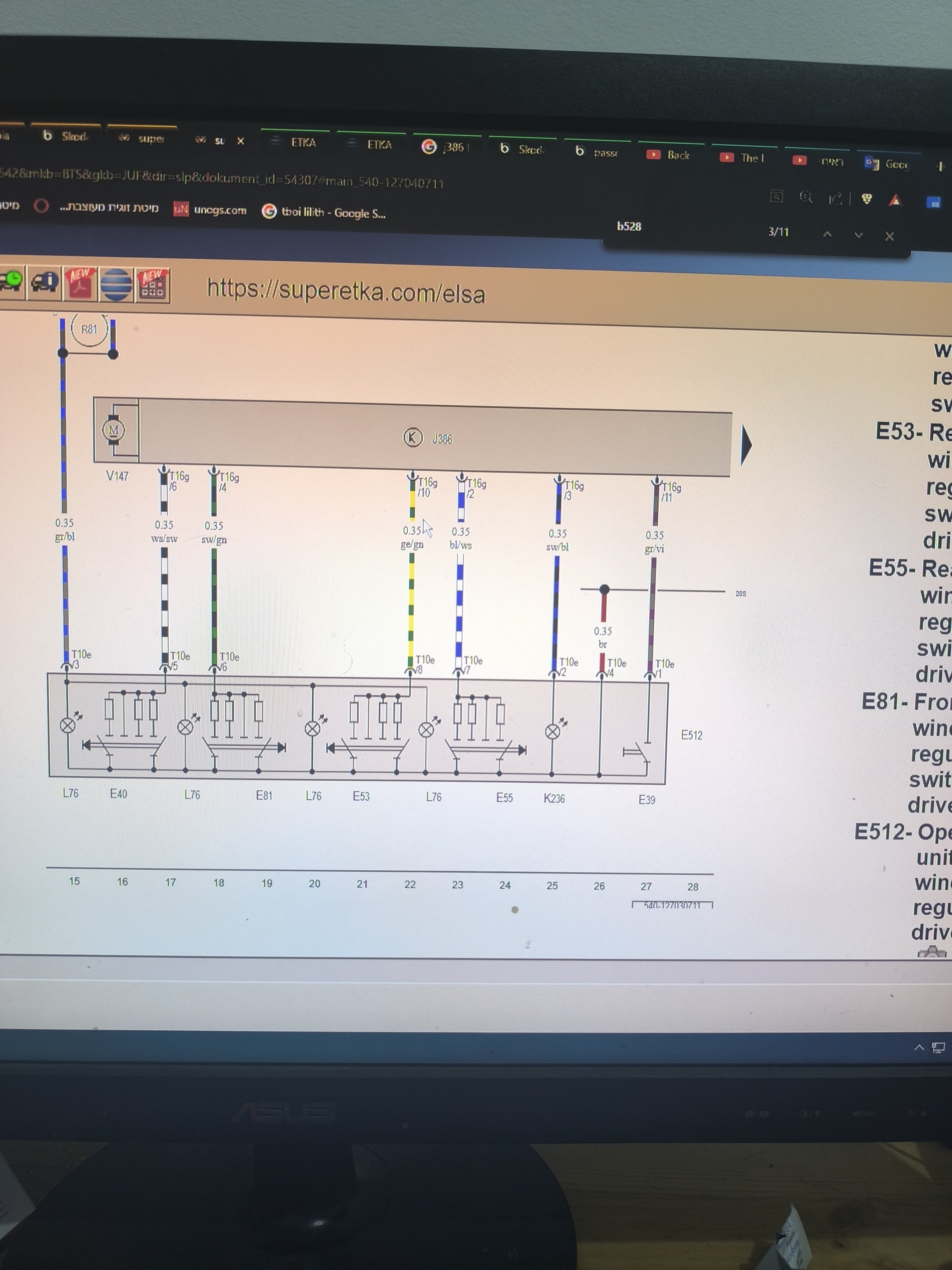

  5. All relevant cables to 28 pins connector are fine Did not found the lin pin at the bcm (j519) but i found it at 28 pin. Tomorrow/later Tonight ill check again when i have day light. I attatched the schematics i found for driver window wiring
  6. Fuse 11 in my car is the mirors motor fuse, are you talking about other set of fuses? I already checked all fuses in my car and they all have contentiuty between both terminals. Fuse 11 in my car is mirror motors Could you send me the diagrams/good site to vew them? I am using superetka and it does not work all the time cor me

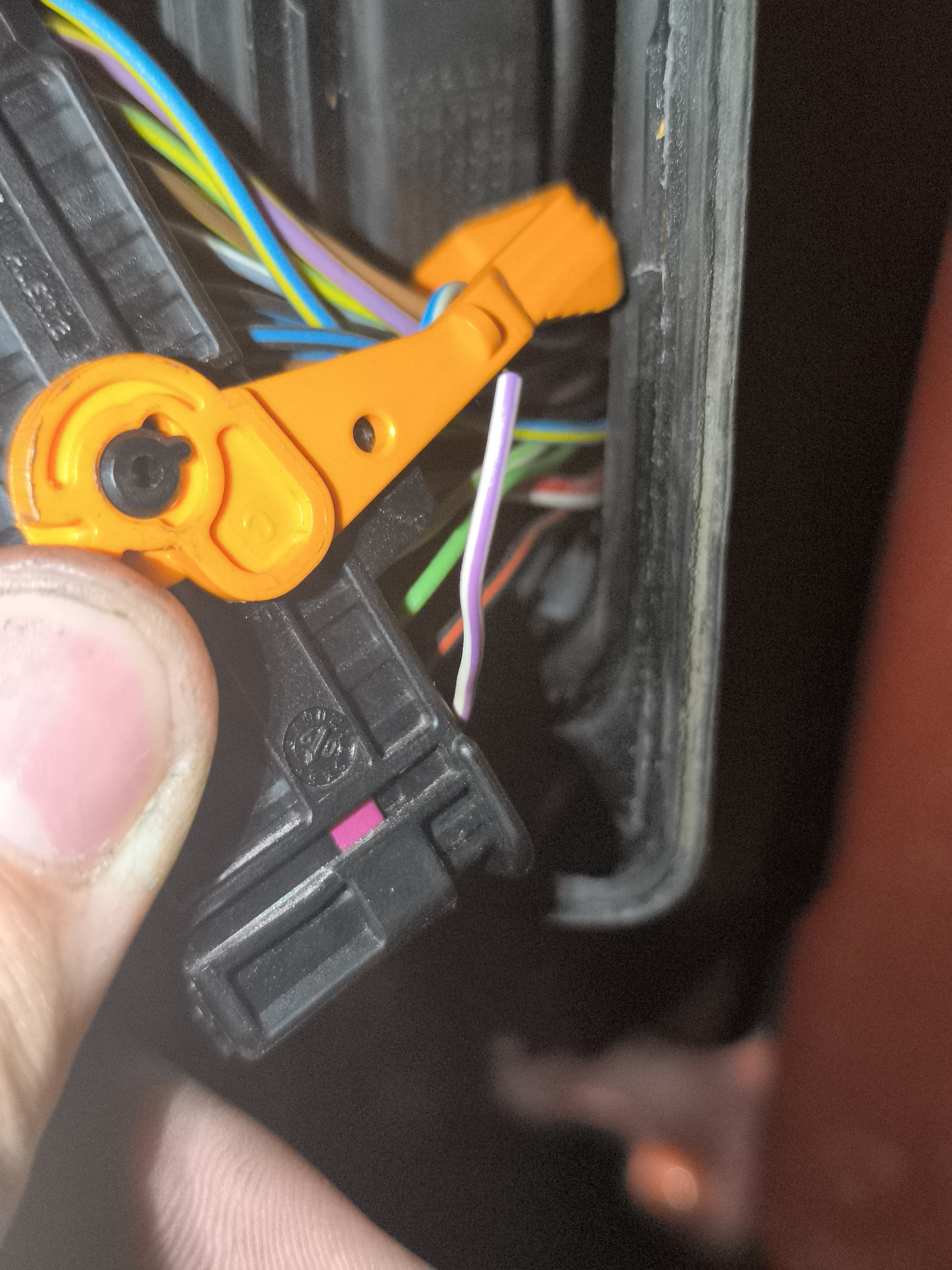

  7. Im pretty sure that the broken wire was cut well before the window switch short acured, to fix that will take a ton of time so i wont do it rn but maybe tomorrow. Ill check all cable from hinge to motor and update in 5-10 minutes
  8. The broken cable is purple + white. There is a cable like this at the ir sensor and the motor module but the one at the module lead to the driver switch. Ill try to check where the broken cable lead but it will take a while. Regarding the black and white cable i checked and there is contentiuty between driver door module and driver window switch but i didnt checked the other motors
  9. "only" 1 broken cable there and if i remember right its related to the ir sensor. But ill check again rn and update in a few minutes. I also checked all window switch cables for contentiuty and they all behave like you'd expect. Just checked rn and when you roll the windows up/down via the key the 12v goes to the cables and windows works fines

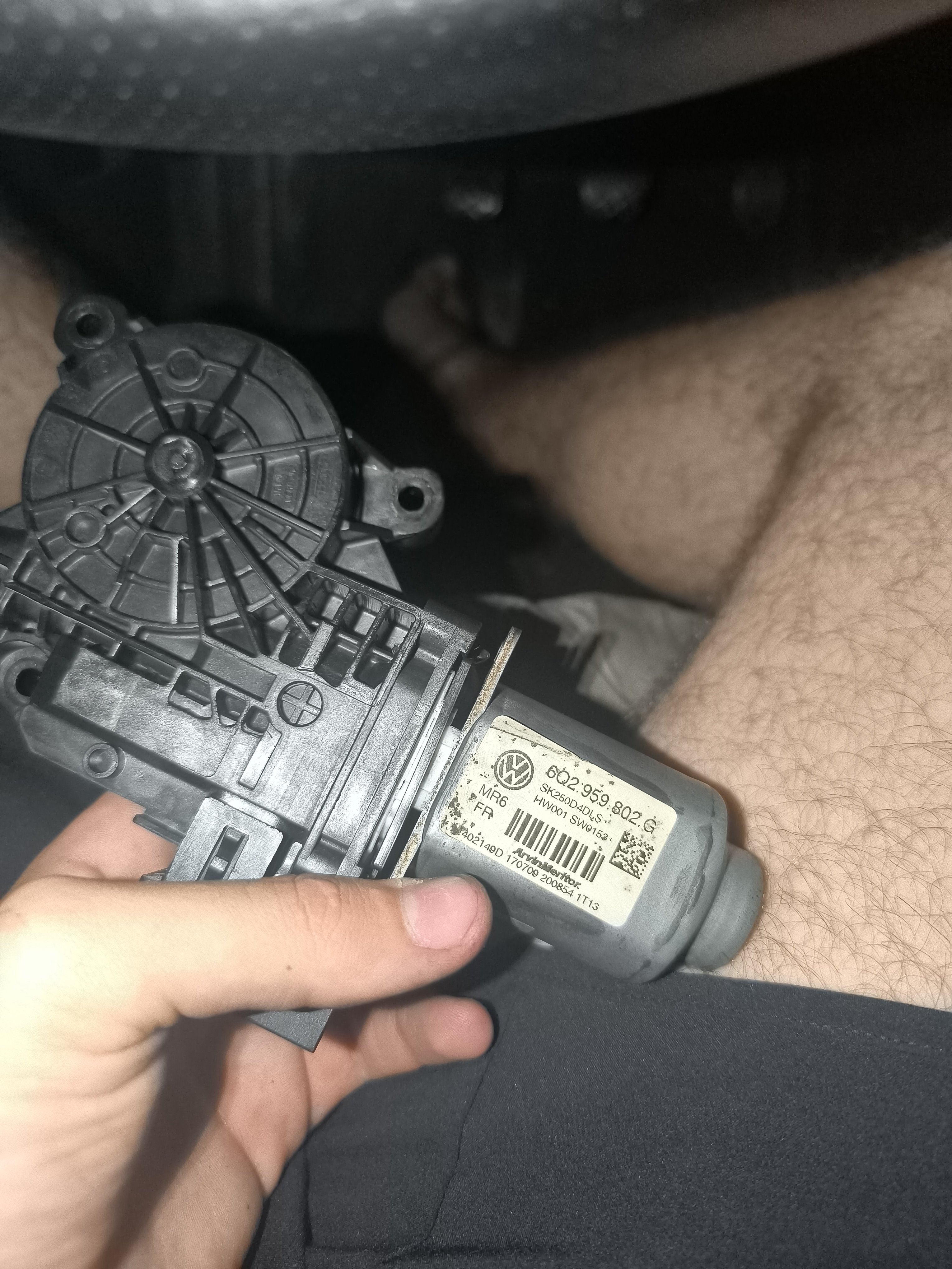

  12. My fabia is 2009, 1.6l sport edition My moms fabia (the one with the good motor) is a 2008 fabia 1.6L diesel combi. Bad window motor part number: 440881d0 0906222235381 Module number + microcontroller Ill have to wait for suterday until ill be able to check the good window motor part number
  13. Hi, I've made a short in my car driver window buttons about a month ago. Ive tried to look up the bcm then I found out that it is fine. Then found car wiring diagrams and saw that the fuse is lined up to the driver door module which is combined with the window motor. I have in my house another fabia mk2 car and decide to take the good window motor+module for the good car into the bad car, then i noticed that the driver buttons receive 12v for a few seconds before going back to 0v (there is a direct corolation between how long you wait before reconnecting to how many second the window button get 12v. I tested the module in the good car and there it has constant 12v no matter what. Do i need to code the module or mayb i didn't diagnose the correct problem.
