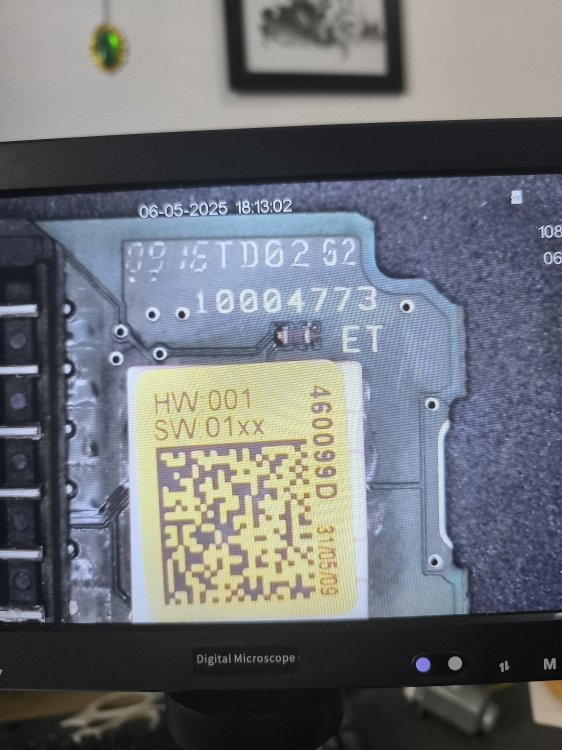

Module number + microcontroller

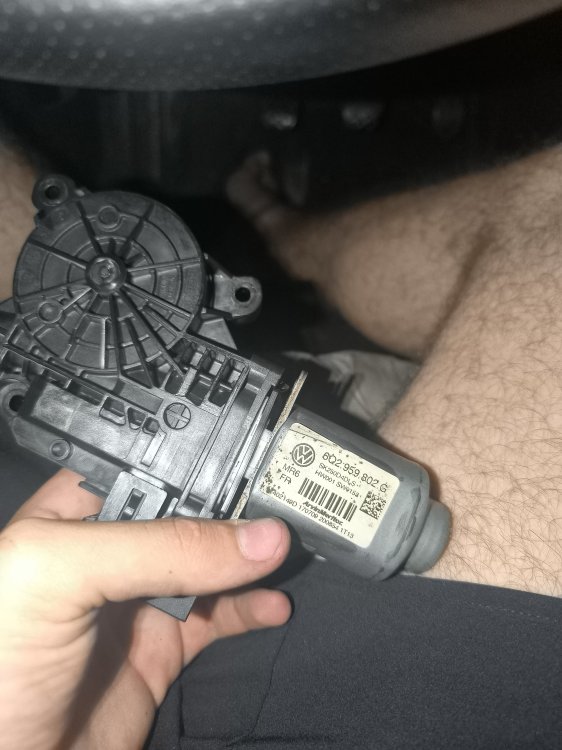

I meant the part number on the outside of the motor, 6Q1959801F, I think for those two cars?
Edited by Breezy_Pete
1 hour ago, Breezy_Pete said:
Sorry, I was working on one of our cars.
Of its 6q2 959 802 G
  • Sponsor
I see, you are in a country where you drive on the right hand side of the road.
So 6Q2... instead of 6Q1...
Both motors same part number?

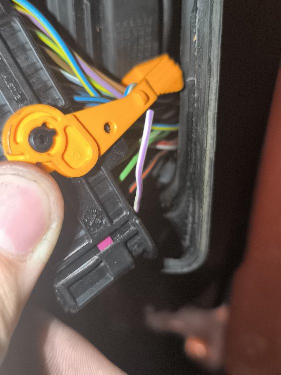

Have you checked for broken wires in the door loom, under the rubber cover in the door hinge area?
"only" 1 broken cable there and if i remember right its related to the ir sensor. But ill check again rn and update in a few minutes.

The wire that might be broken supplies an ignition switched 12V to a thin black/blue wire going to the motor connector.
When you work them by the key, this ignition switched 12V isn't required.
The broken cable is purple + white. There is a cable like this at the ir sensor and the motor module but the one at the module lead to the driver switch. Ill try to check where the broken cable lead but it will take a while.
Regarding the black and white cable i checked and there is contentiuty between driver door module and driver window switch but i didnt checked the other motors
  • Sponsor
Repair all broken wires and check from 28-way connector at hinges to window motor connector, referring to circuit diagram.
Im pretty sure that the broken wire was cut well before the window switch short acured, to fix that will take a ton of time so i wont do it rn but maybe tomorrow.

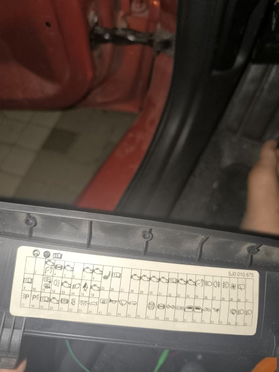

Check fuse #11, which supplies that ignition switched 12V to wake the motor.
Fuse 11 in my car is the mirors motor fuse, are you talking about other set of fuses? I already checked all fuses in my car and they all have contentiuty between both terminals.

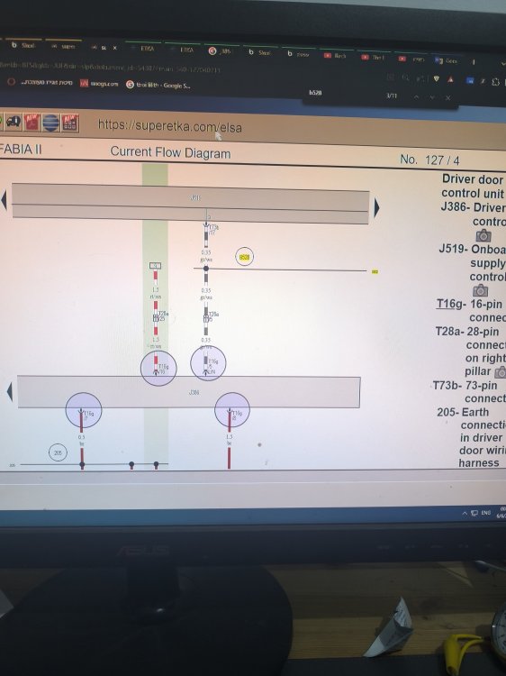

Could you send me the diagrams/good site to vew them? I am using superetka and it does not work all the time cor me

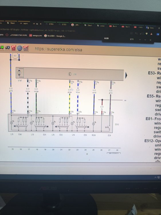

I attatched the schematics i found for driver window wiring
  • Sponsor
That's the next generation wiring diagram, from March 2010. No LIN connection to BCM on previous one, like yours, or the one before. So BCM isn't relevant.
Fuse 11 checked? That wire isn't on your diagrams.
Will add correct diagram shortly.
  • Sponsor
This should match what you have. You can see that fuse 11 does matter here.

Thanks alot for the new and correct diagrams, i have just checked fuse 11 and unfortunately it is fine and no problem there
  • Sponsor
Measure at the connector for the motor with ignition switched on, to be sure that 12V is actually getting to that pin of the connector where the black/blue wire goes. You said you had checked/tested all the wires from motor to 28-way, but that was with incorrect circuit info.

Magnificent news!!!! Ive just decided to replace all of the relevant fuses just to get it out of the system so i would not need to check the fuses for the 4th time and aperently one of the fuses was the problem!!
Now i kind of feels stupid because i spent a literal week diagnosing the problem and somehow i missed a simple fuse problem even though i check all fuses 2 or 3 times.
Thanks a lot for the help, i now know the price of using free diagrams.
