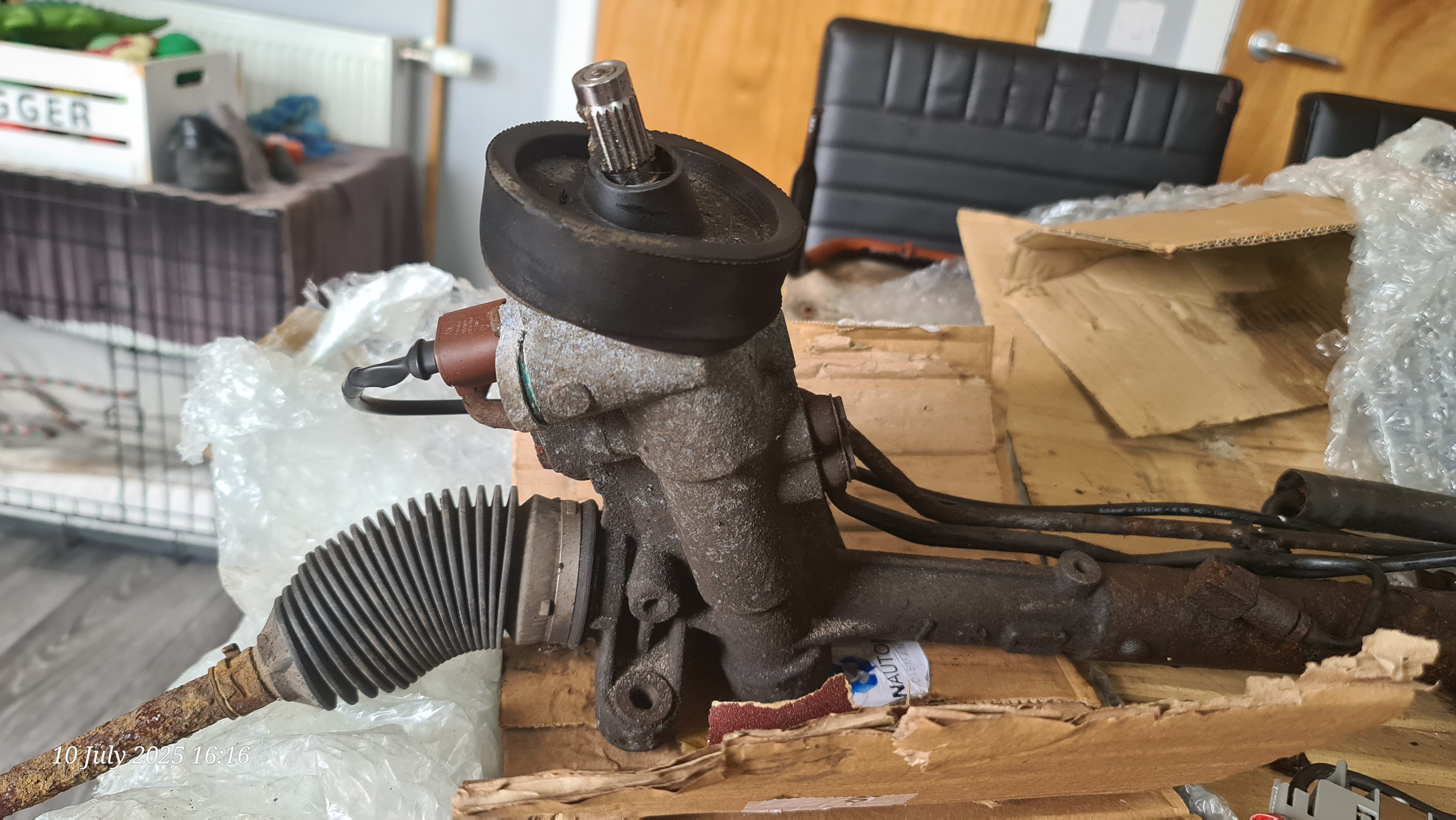

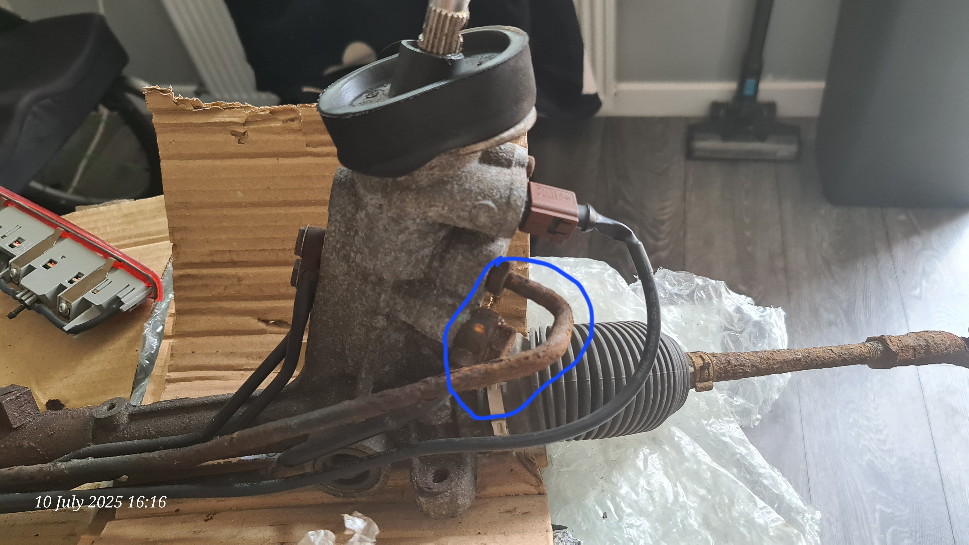

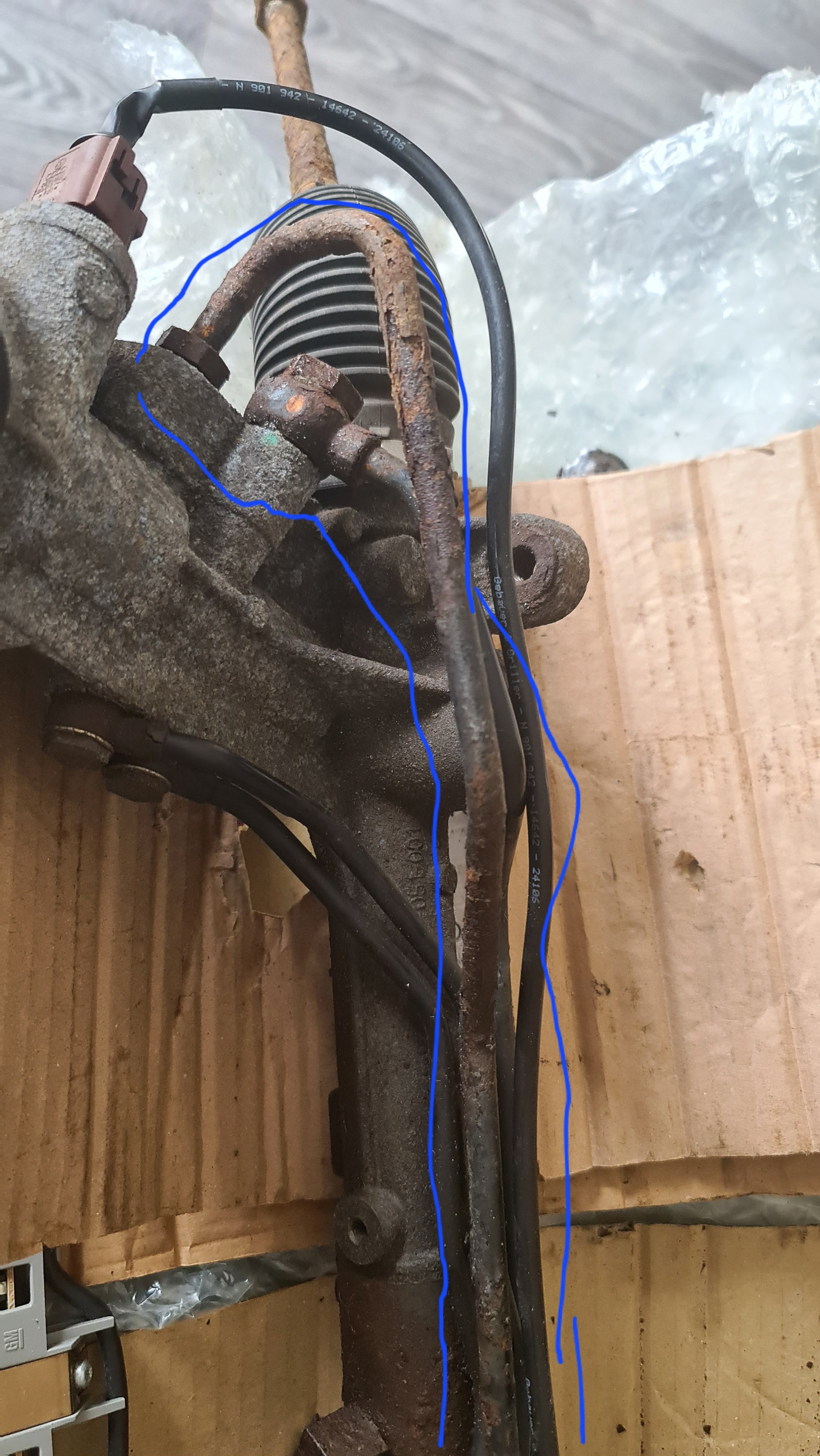

Does anyone have the part numbers for a 2007 MK1 fabia 1.2 bme engine steering rack pipes. ?The 2 pictured in blue.
I ordered some from Autodoc and they sent ones for a left hand drive instead of rhd.
Pics of the RAC and pipes needed attached.

The parts catalogue entry for a 2007 Fabia mk1 with power steering is HERE.
I believe the parts you are seeking are #20 & #24.
Thank you so much mike.
I will have a look just now
5 minutes ago, Breezy_Pete said:
Think it's this diagram actually, all UK systems are TRW, I believe.
Obviously the ones labelled rhd, with part numbers starting 6Q2.
All unavailable new AFAIK, sadly.
https://www.lllparts.co.uk/catalogs/skoda/ALL/FAB/453/4/423/423050
Thanks @Breezy_Pete there is only one number for the low pressure return which is easy to hopefully cross ref.
There is 3 of the high pressure one tho all same number but each with a different letter at the end.
I will have to look into that.
I will head to autodoc again and use these numbers and hopefully I can find something.
Thanks again 👍
