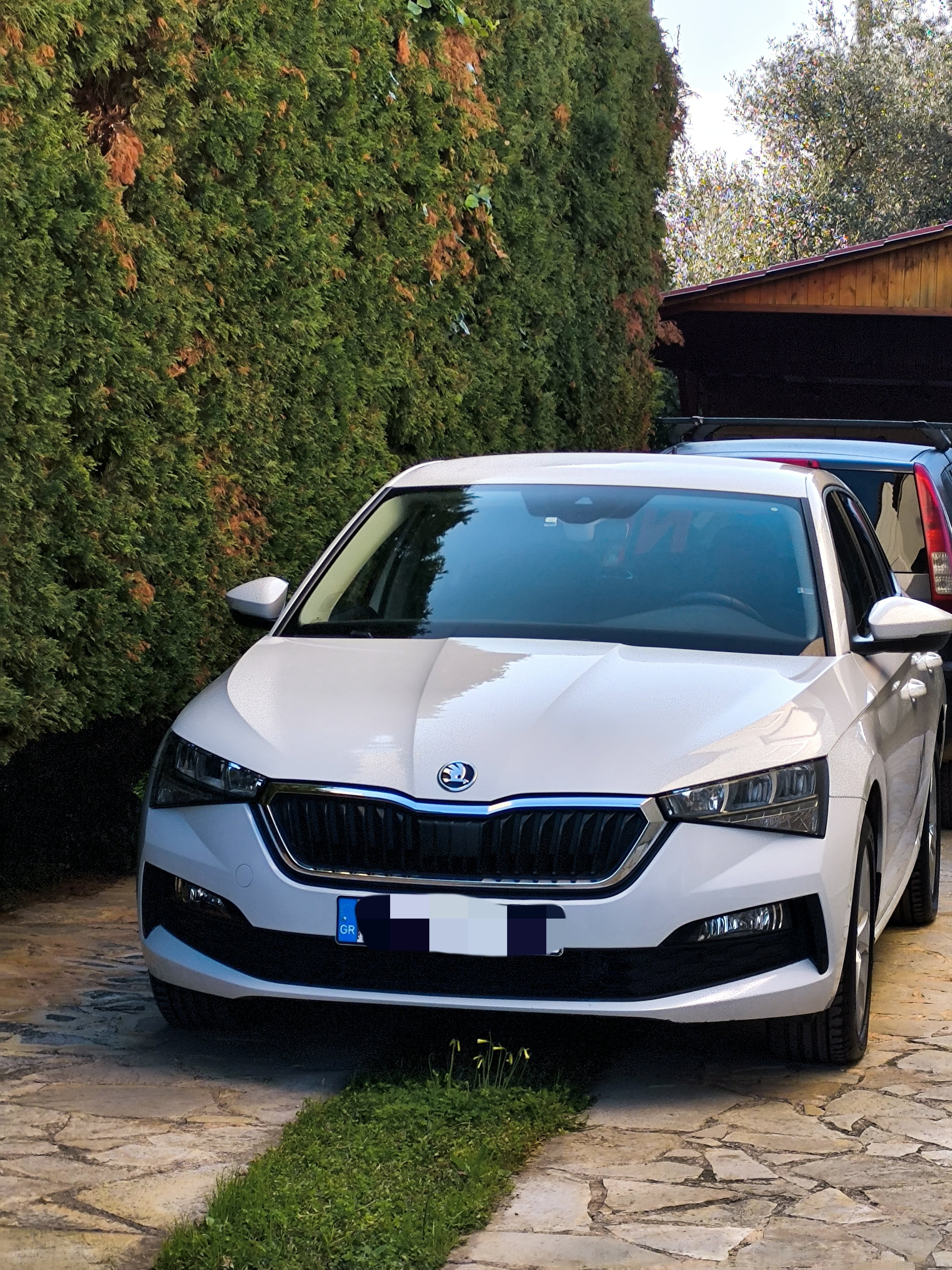

  4. Hello, This is my Scala style, bought second hand with 105k klm on the clock Thanks for having me
