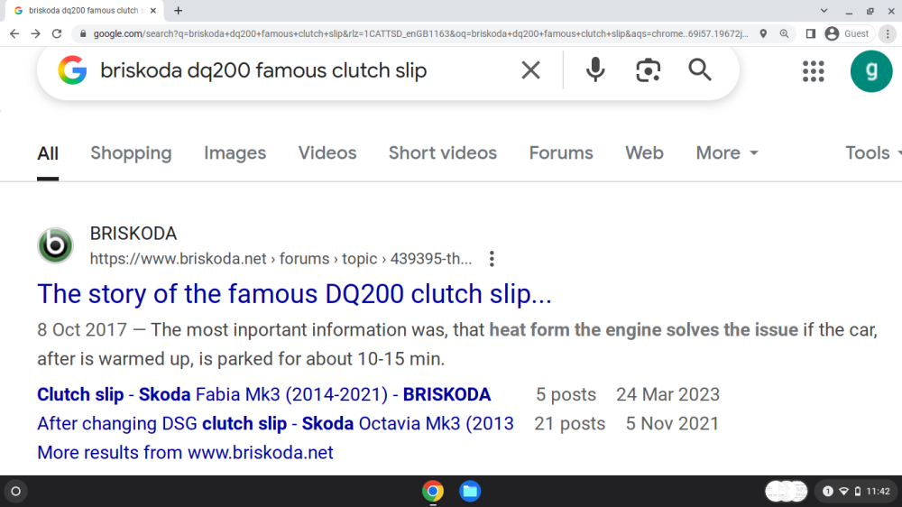

Maybe look at the threads in the Fabia mk3 section. They are long and winding, and the long and shot, pre your 2020, there were software updates, and clutch packs.
A reset might work, or diagnosis from a tech that knows DQ200,s and not one that says, 'they all do that'.
