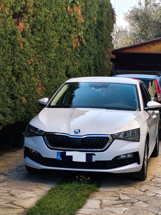

Hey guys, This looks like its going to be another one of those DQ200 posts... Coming back from weekend getaway, cruising on the motorway. At some point I noticed while in 7th the RPM short of... dancing. Car was steady at 120-130kmh. To check I dropped the car in M6 and did a pull, from 1500 rpm full throttle. Clutch was slipping up to 2500. Today i did a pull in 5th and recorded. The engine looks like it accelerates in steps. Conditions: foot to the floor, slightly uphill, dsg to M5 I will go on the highway today to see if i can recreate with video. A mechanic today tried the car said it was fine. I recorder the video after leaving his store I will try the reset method i found online (gas pressed 30sec). I've seen people complain that the gearbox is juddery, but is this normal...? This is my first ever auto gearbox. To my eyes it looks like the clutches are cooked Car is 2020 1.6TDI with DSG7, 105,000klm Thanks to all for your time
