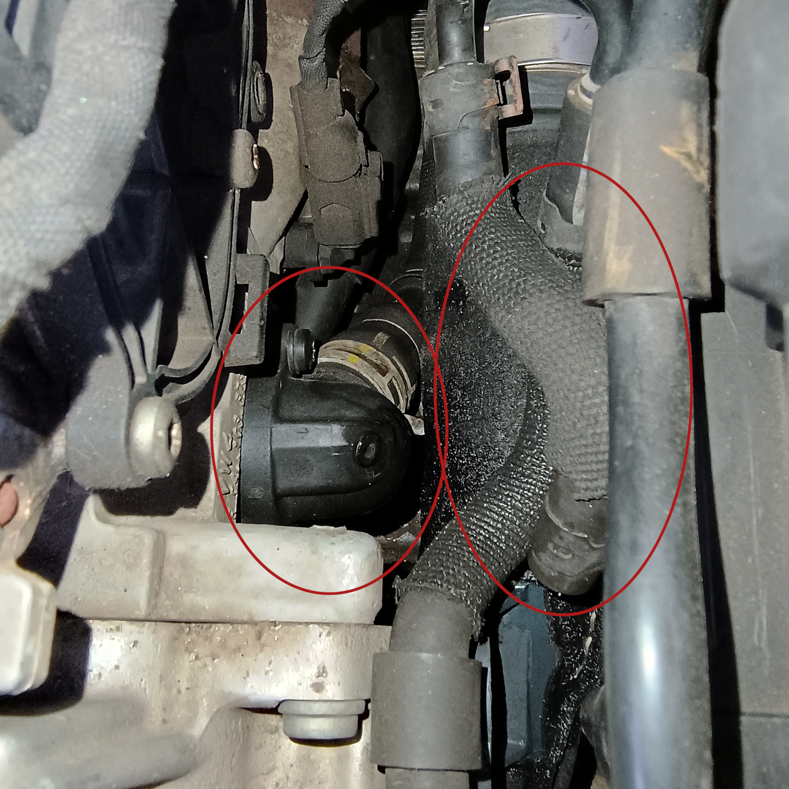

  5. As noted in y original post, it's an engine coolant outlet flange - 04L 121 131 AA
  6. Greetings, While doing a water pump/timing belt renewal, I've inadvertently broken a piece off form the cooling system and I would like it identified. It's on the right side of the engine and the best I can do is potentially identify the hose from the manual as being a hose to the exhaust gas recirculation cooler. But I don't want to lay a false scent. I've attached an image and circled the two items I'm interested. The nipple has snapped off in to the hose hence I need both parts TIA -Anthony
