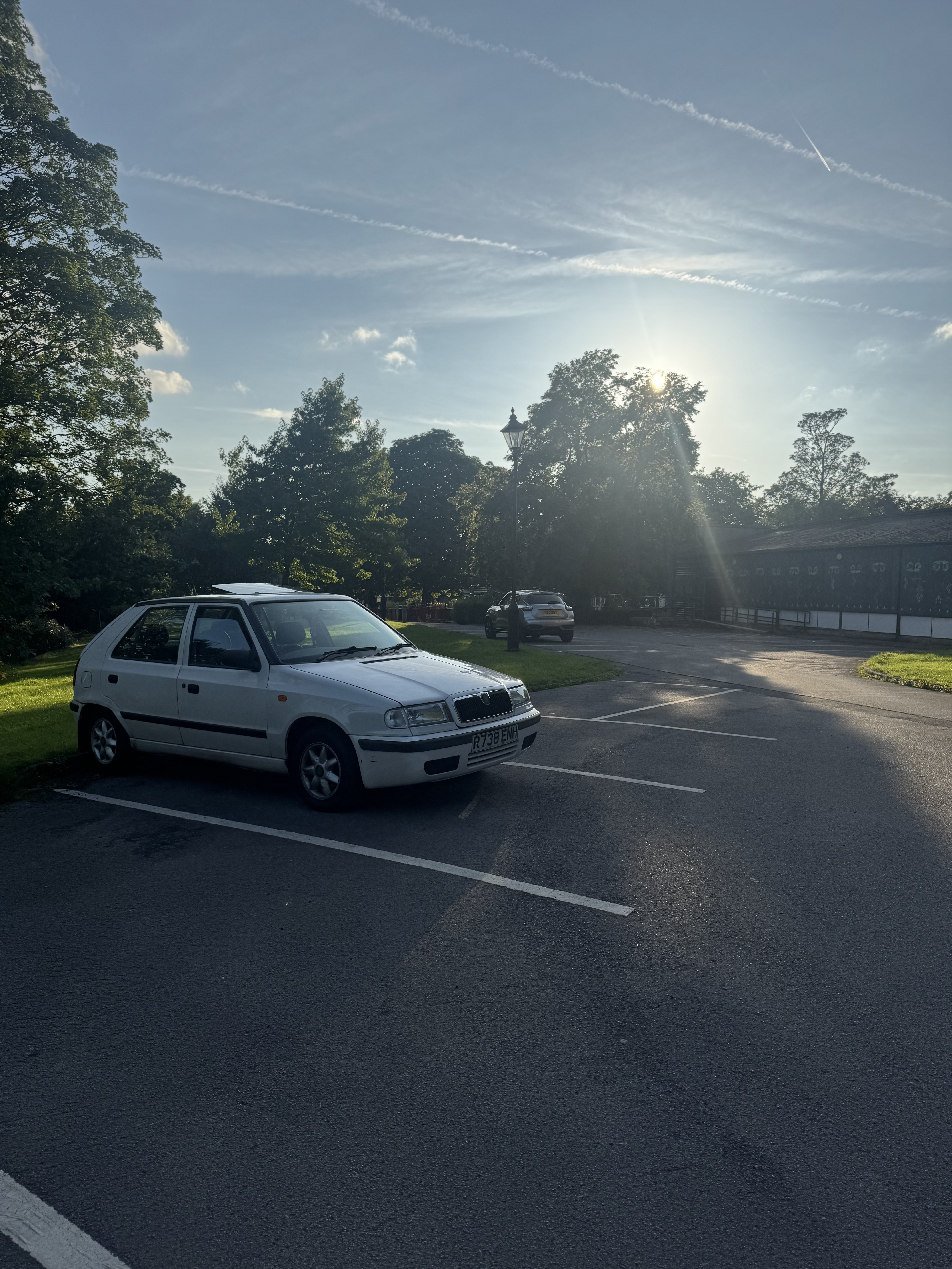

  6. Heres my 1998 1.3 Felicia GLI, picked it up for quite cheap and enjoyed it so far, needs quite a bit of TLC but runs fine (but quite on the loud side!)
