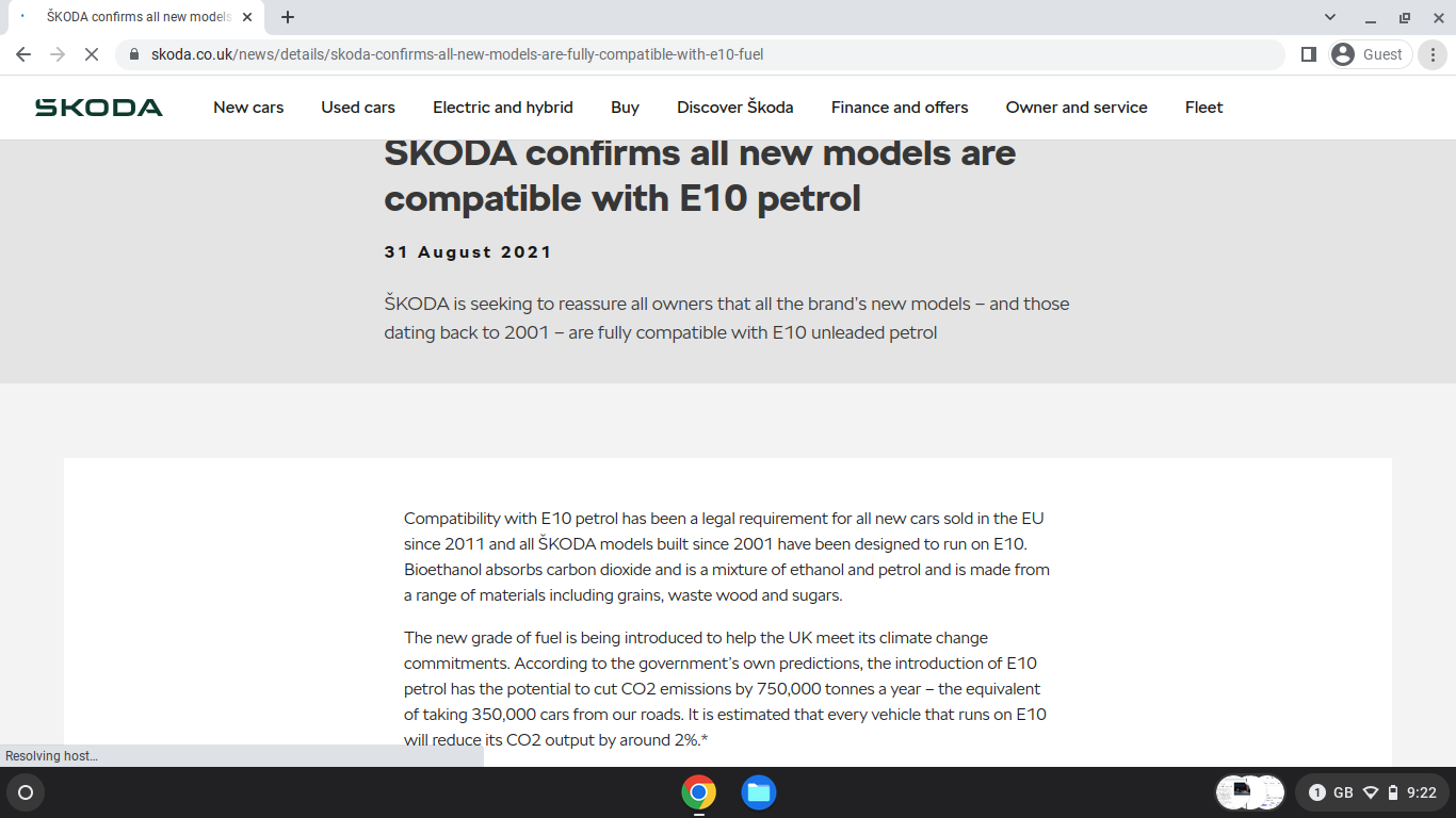

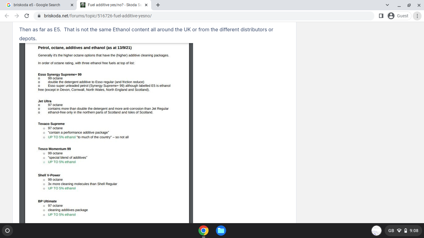

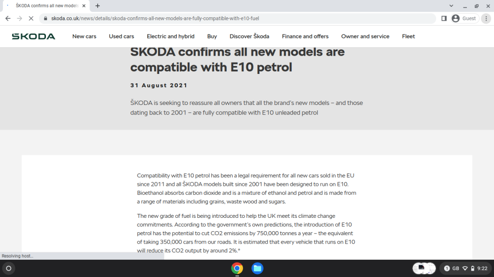

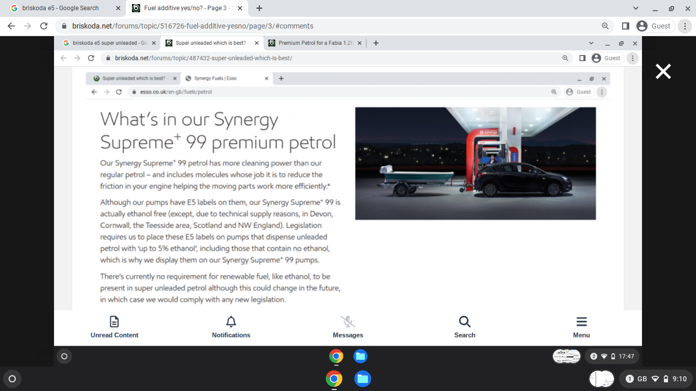

The OP is in the UK where all 95 ron Unleaded sold is E10 so might have up to 10% Bio-ethanol.
Skoda / VW says OK to use.
the 97 or 99 ron Super unleaded is E5 and might have up to 5% Bio-Ethanol.
Some might have 0% bio-ethanol like ESSO Synergy in a very small amount of the UK.
Up to the person buying what they want. Sainsbury 97 ron min Super Unleaded or Tesco Momentum 99 might be no more than the Branded companies E10 95 ron.

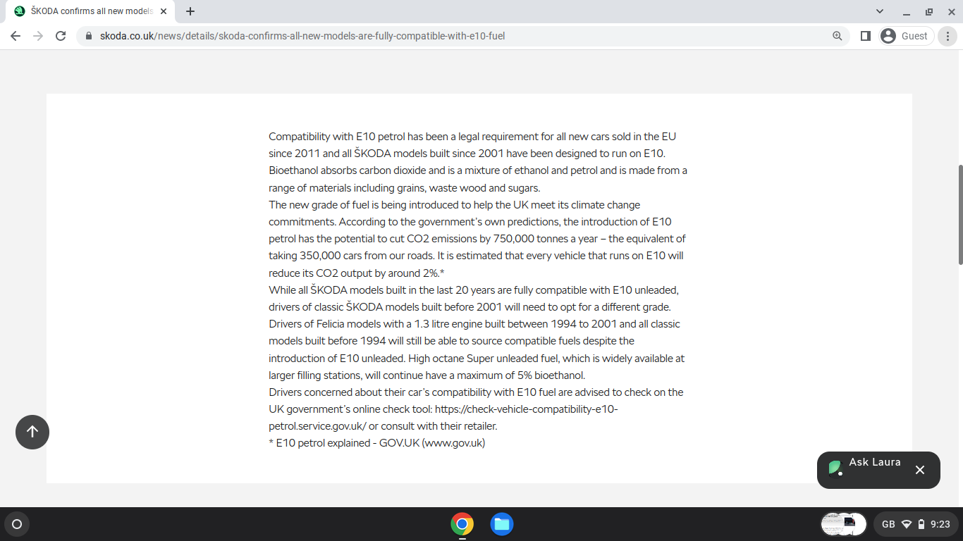

4 minutes ago, Ootohere said:
Unleaded is E10 so might have up to 10% Bio-ethanol.
As I stated above, it's not OK.
For Felicia, only the 1.6 is fine to use it.
1.3 MPI - E10 may damage the seals on the fuel pressure regulator and Skoda recommends replacement.
For all other variants of the Skoda OHV engine in Felicia and older models, the E10 fuel is not recommended - but the concern is around the rubber/plastic parts in the fuel system, not the engine itself, so YMMV.
Edited by Papez

The higher octane fuels also have greater additive cleaning packages. Attached list (already posted by Ootohere) is from 2023 but gives you the idea. - petrol.pdf
