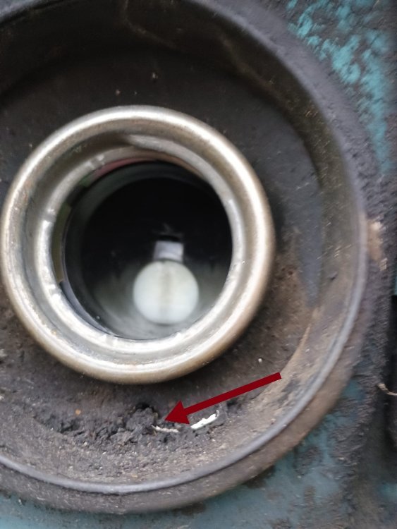

I’m not sure if it’s linked but it’s worth adding context: when fueling the car, the petrol pump stops if i’m holding the trigger down, meaning I have to spend about 15 minutes fueling the car!
Could it be that you're ramming the nozzle in too far and getting splashback or fumes, I can't remember now if the 1998 UK fuel cap entry pipes were restricted in size like modern petrol ones.
How clean and clear is the area around the filler if it's covered in debris then clean it all out and check any small hole is open and not stuff. Do you have any sort of EVAC system?
Do you normally fill the tank and know the actual capacity of your tank when full rather than what the book says?
That's impossible, the hole beneath the cap is free from debris etc?
Yeah it’s my standard consumption, I do a bit of long distance driving and running about to the shops etc but i’m on the outskirts of a city so the traffic is never too terrible! And yes free of all debris and everything, I will try to get some pics once the car is back. In regards to 99 RON i’ve had a few people suggest it and I believe its even suggested by the UK government but it’s hard to say as I’ve never been too sure
