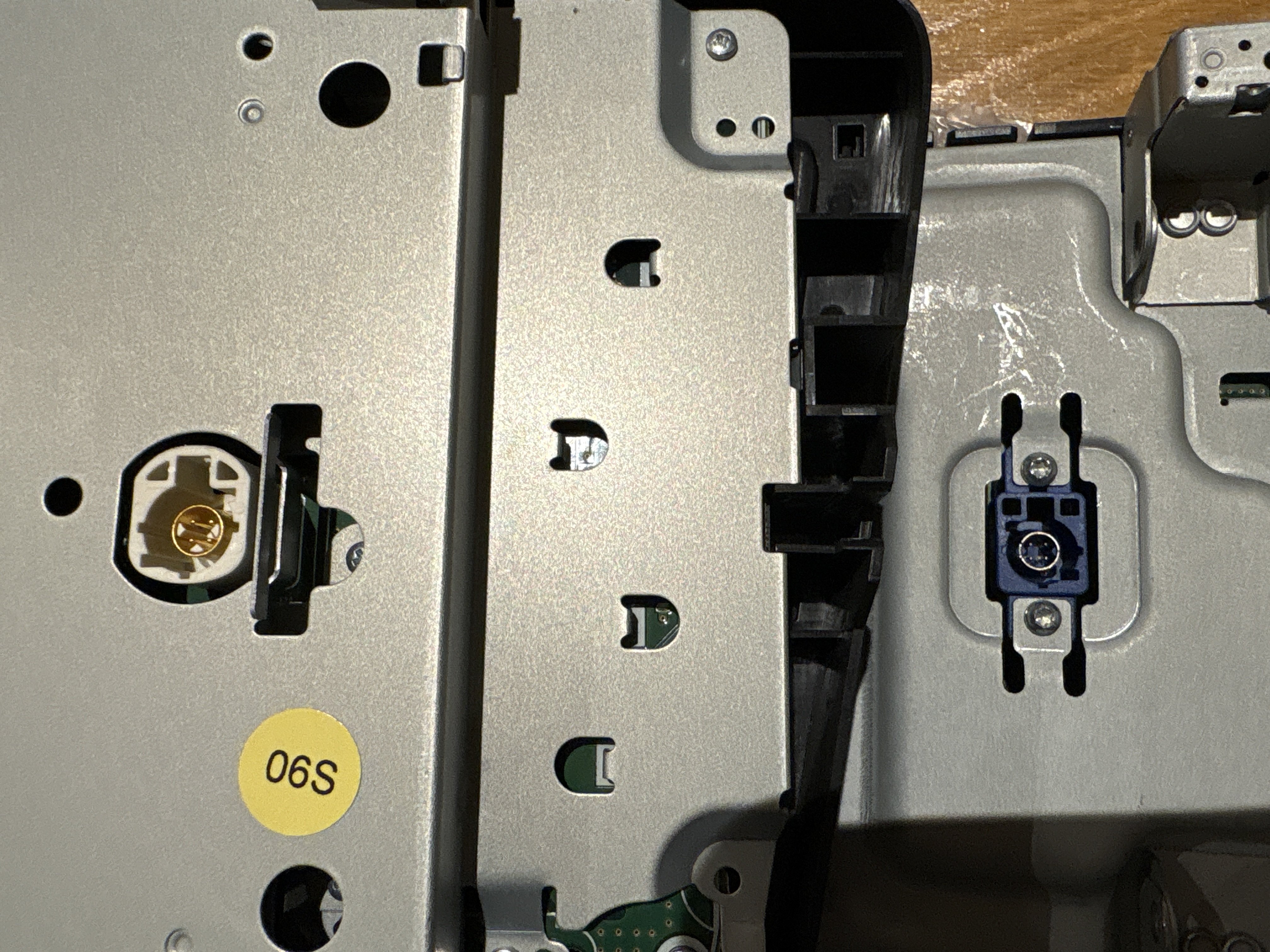

The old bolero seems to have a LDVS H port and the new display looks to have a LVDS C port

I have the new MIB2 Amundsen unit and 5E0919605M display from the list. However the LVDS cable that is in the car is a different shape to the port on the 5E0919605M display, so I can’t plug the display in. is it a case of buying an LVDS adapter or can I “shave” off the profile on the LVDS plug? :/
