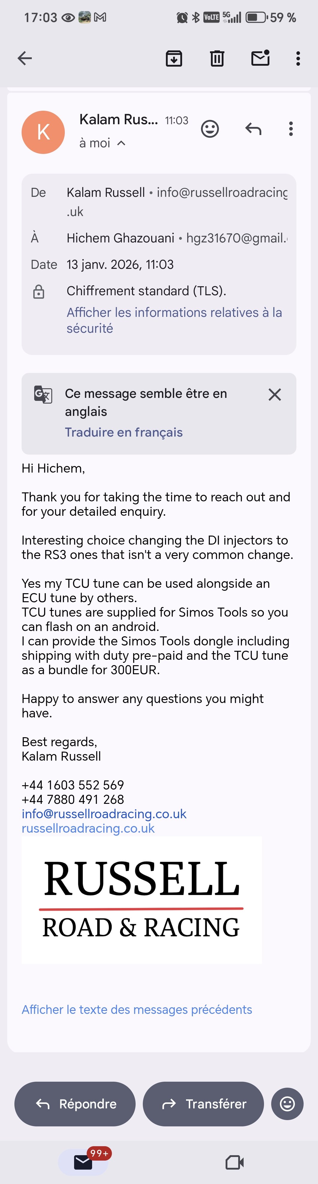

I received a response from Kalam at Russell Road Racing; this guy seems great. I ordered the Simos Tools dongle and the TCU DQ250 stage kit. Here's his reply to my technical inquiry email : Thank you for placing your order. Typically torque limits in the TCU are set to 650NM this is the hard coded maximum that the TCU can comprehend. It does not mean that 650NM is the absolute limit I have had cars running 800+NM on DQ250. Obviously in your case you're not going to be making 650NM but it is better that the limits are set well above the ECU to avoid any intervention from the TCU. The clamping pressure will be increased and work dynamically. Shift times are reduced. Torque reduction is largely an ECU side logic depending on cylinder cuts and timing retard between shifts. The TCU just has a maximum allowed torque reduction available to it. It can be refined based on logs. Happy to review pre and post logs if made with Simos Tools. And yes I am sure that we will be able to achieve your desired goals. We will get your OBD adapter posted out tomorrow. I look forward to working with you. Best regards, Kalam Russell

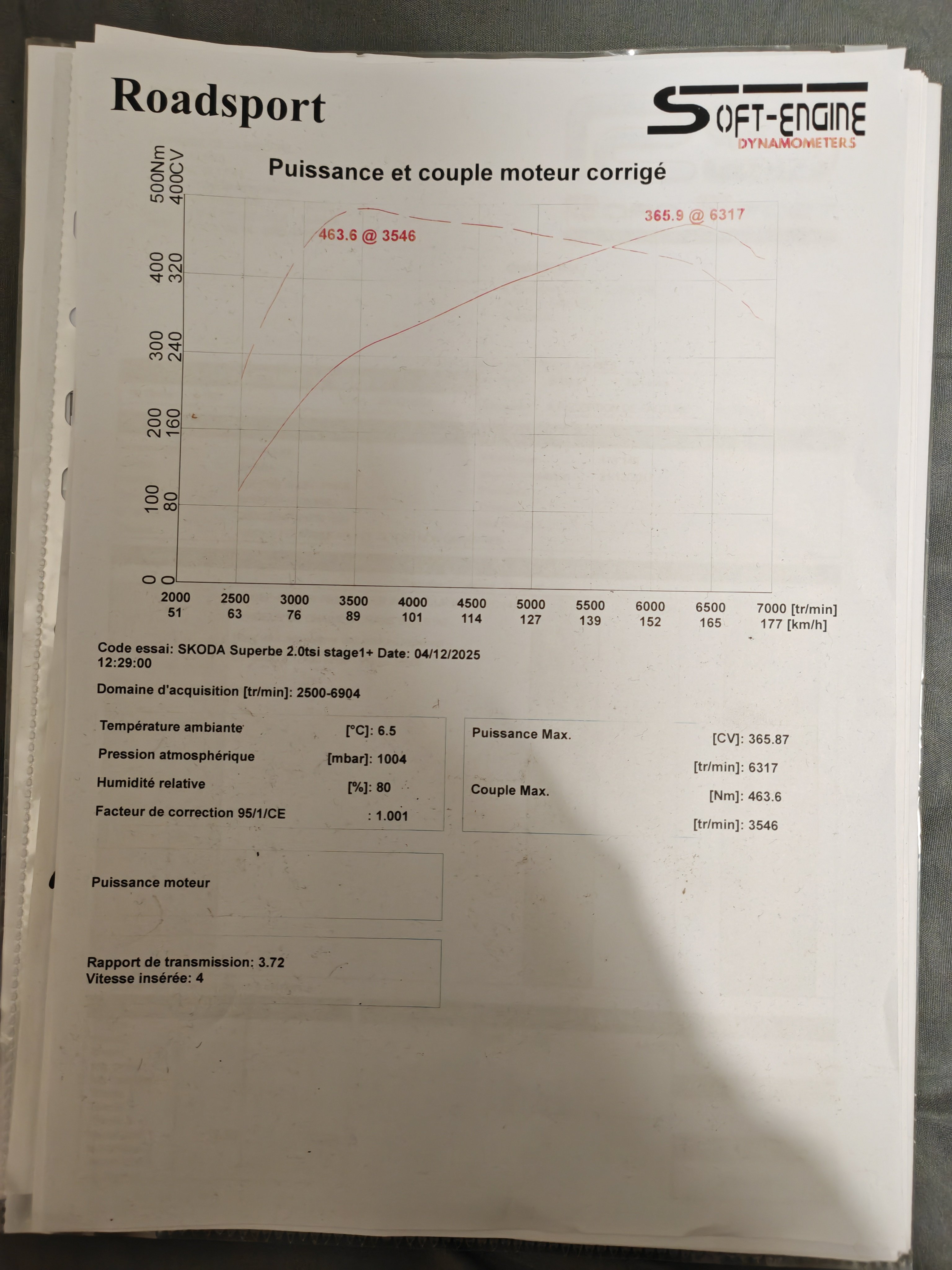

Hello everyone, I’m looking for some feedback and advice from DSG/DQ250 users with experience in higher torque setups. Here is my full situation. --- ### **Vehicle** * Skoda Superb 3V (MQB) * Engine: EA888 Gen 3 2.0 TSI CJXA 280HP stock * Gearbox: DSG6 DQ250 * Fuel: E85 (flex fuel calibration) * Mileage: 177,000 km * First registration: December 2018 * Maintenance: fully up to date --- ### **Current engine configuration** * ECU remap by **Fred Auto Sport (France)** FLEX E85 FUEL WITH BI-INJECTION ACTIVATED * Approx. **365 hp / 460 Nm** * Audi RS3 8V5 Fsi injectors * Additional * MPI injector – 980 cc** * OEM HPFP with **Autotech upgrade kit** * RS3-type brushless LPFP * Dump valve GFB DV+ * NGK Iridium spark plugs TURBO IS38 STOCK WITH OUTLET/INLET * VWR Racing ignition coils * VWR R600 intake * Exhaust & catalyst **100% OEM** Engine behaviour is smooth and consistent in all conditions, no drivability issues outside of gear changes. --- ### **DSG situation** * A DSG “stage” was applied at the same shop, but it only consisted of **raising the torque limiter** * No recalibration of: * clutch pressures (K1 / K2) * shift timing * torque reduction strategy * Full DSG reset & adaptation performed correctly using VCDS: * reset adaptations * double clutch fast adaptation * synchro-points calibration * learning drive completed * Over **1500 km** driven since adaptation --- ### **Problem** * No issues at light or moderate load * However, I still experience **micro-jerks during full load / WOT upshifts**, both in D and S * These jerks were **not present before the torque increase** * Around **6800–7000 rpm**, I sometimes feel a **clear torque cut / power drop during the gear change**, as if the TCU is intervening aggressively To me, this clearly looks like a **DSG strategy limitation**, not a mechanical issue: * clutch pressures not fully aligned with real torque * torque reduction during shifts too aggressive * shift timing / overlap not optimised for the current torque curve The gearbox itself feels mechanically healthy in normal driving. --- ### **Options I’m currently considering** I contacted **Russell Road Racing (UK)** following Briskoda recommendations. They confirmed: * Their **TCU tune can work alongside an ECU tune from another tuner** * TCU tuning is supplied via **Simos Tools** (Android flash) * They offer a **Simos Tools dongle + TCU tune bundle for ~300 €** I’ve asked them additional questions about: * torque limit values (Nm) * clutch pressure calibration (K1/K2) * shift times under WOT * post-flash refinement using logs In parallel, I’m also considering **KM Tuning DSG DQ250 Stage 2 (520 Nm)** as a more plug-and-play solution. --- ### **What I’m looking for** My goal is **not aggressive shifting**, but: * smooth and consistent WOT upshifts * elimination of torque cut / micro-jerks * proper clutch pressure management * long-term reliability --- ### **Questions to the community** * Has anyone here used **RRR TCU tuning with Simos Tools** on a DQ250? * How does it compare in real life to **KM Tuning Stage 2**? * For a real-world torque level of ~460 Nm, would you go: * custom TCU via Simos Tools * or a proven Stage 2 TCU (KM / TVS style)? * Any long-term feedback on durability with these solutions? Any feedback or real-world experience would be greatly appreciated. Thanks in advance 👍 Hichem

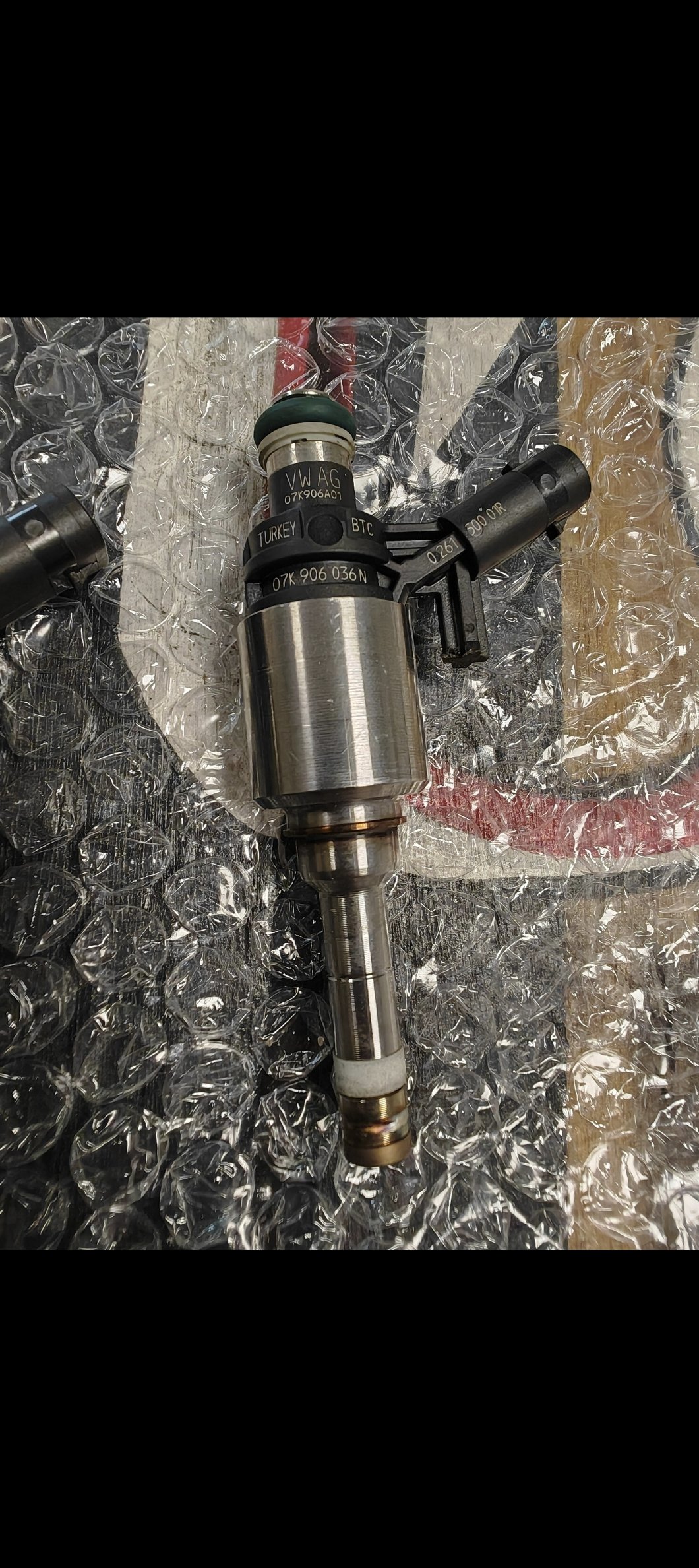

Hello, I wanted top-notch reliability with 100% E85 ethanol and a power increase. My car has 170,000 km on it, so I wanted to start fresh with a new LPFP pump and new MPI/FSI injectors. Since I have the Autotech high-pressure kit in my high-pressure pump, the tuner informed me that there was a risk of damaging an FSI injector with this higher pressure. Regarding the gearbox, the jerks are less pronounced in manual mode, almost nonexistent. I also have another problem: when I'm really under full load, at 7000 rpm, the power can suddenly drop as if I had stopped accelerating abruptly. It seems like a safety feature is preventing the gear change. The tuner replied to my email: Fredautosport answer to my mail : Hello and best wishes. I spoke with the mapper who suggested tweaking and slightly reducing the power to eliminate this effect. Otherwise, the best solution is to do a Stage 3 TVS upgrade, but it's expensive. I don't have the latest prices, but it's around €1000, and with that you get a 100% personalized map; you can adjust absolutely everything to your liking.

Hello everyone, so I asked Fredautosport, a well-known tuner in France, for a Stage 1 flex-fuel E85 tune + TCU Tune. So, in the end, on my Superb, I have an EQT RS3-type low-pressure fuel pump, 980cc MPI injectors, RS3 8V5 FSI injectors, the original high-pressure fuel pump with an Autotech kit, a reinforced GFB DV+ dump valve, and a VWR R600 intake. Everything is working well for the moment, however, I have a problem with the DSG6 transmission because under full WOT (Working On Throttle) I'm experiencing jerking during gear changes that I didn't have before with the original map. I mentioned it to him, and apparently they didn't change anything but only noted the maximum torque values for the gearbox. I'm supposed to see them again in early 2026.

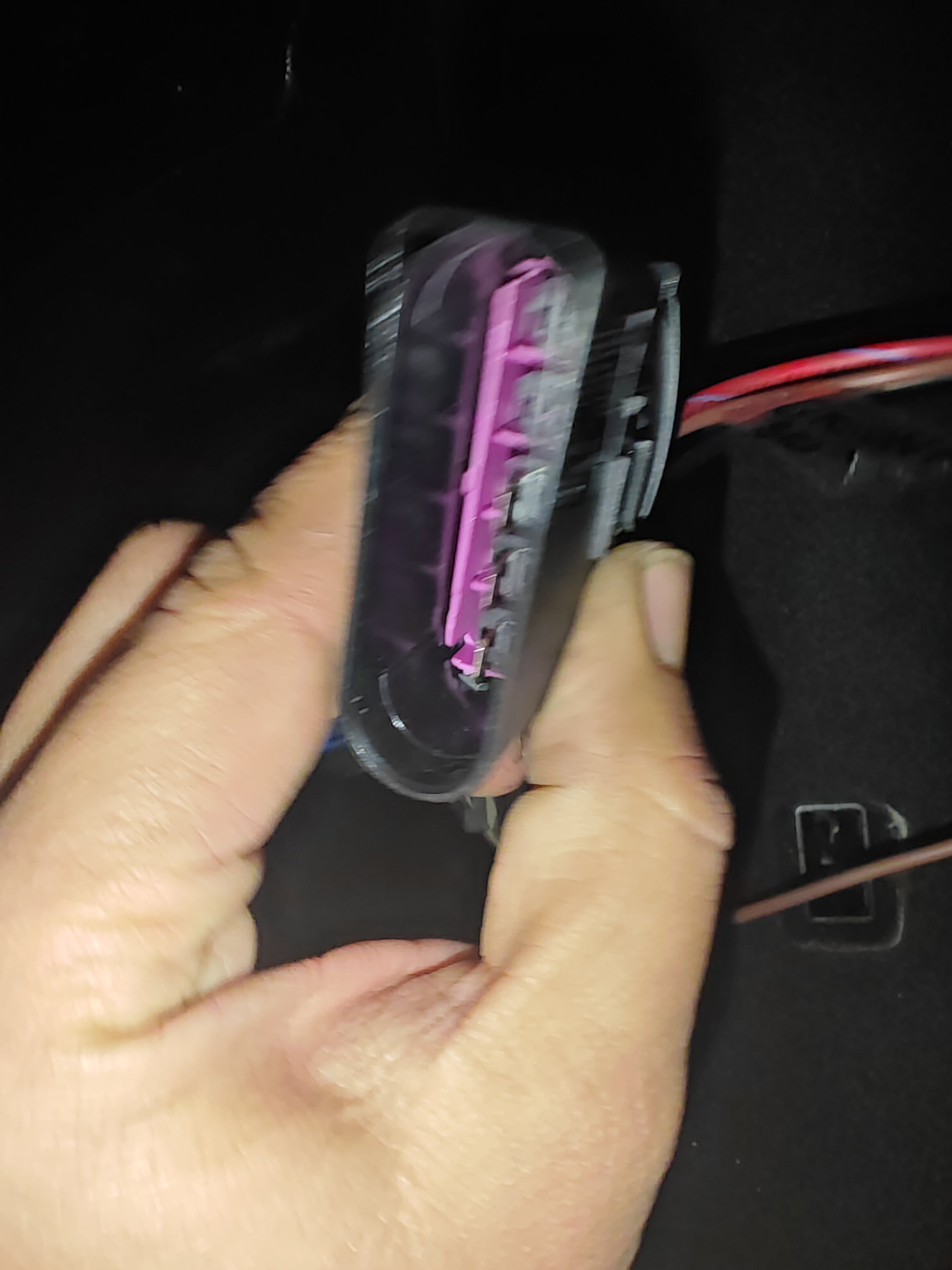

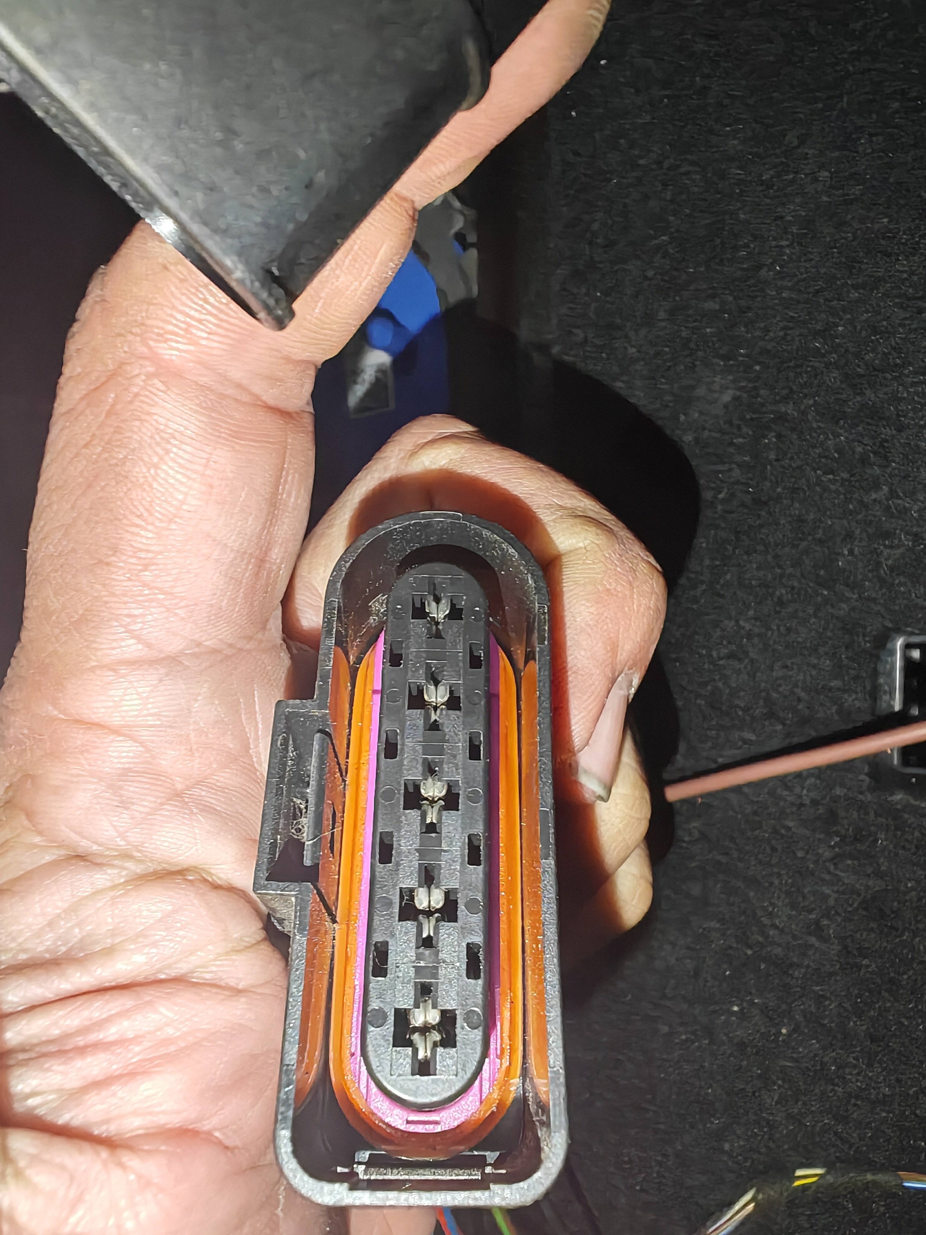

@Awesam Finally, I managed to connect the pump; it is indeed plug and play. The connector on the pump side had the pink tab inside slightly misaligned; I put it back in place. Now everything is in order, the pump works well. I have an appointment with the tuner Fredautosport in a few days for the configuration. So, I have a VWR R600 intake, large volume inlet & outlet turbo, GFB DV+ dump valve, Autotech kit on HPFP, EQT RS3 type brushless LPFP. The next modifications are a Wagner Tuning downpipe and intercooler. I found a downpipe reference; what do you think, Awesam? https://www.equip-auto83.fr/fr/moteur/echappements/downpipe-rm-motors/downpipe-inox-decata-rm-motors-pr511728_9e.htm?tkpub=GGL&tkcmpg=Shopping#desc Cheaper than supersprint 800+ euros Thanks for your help

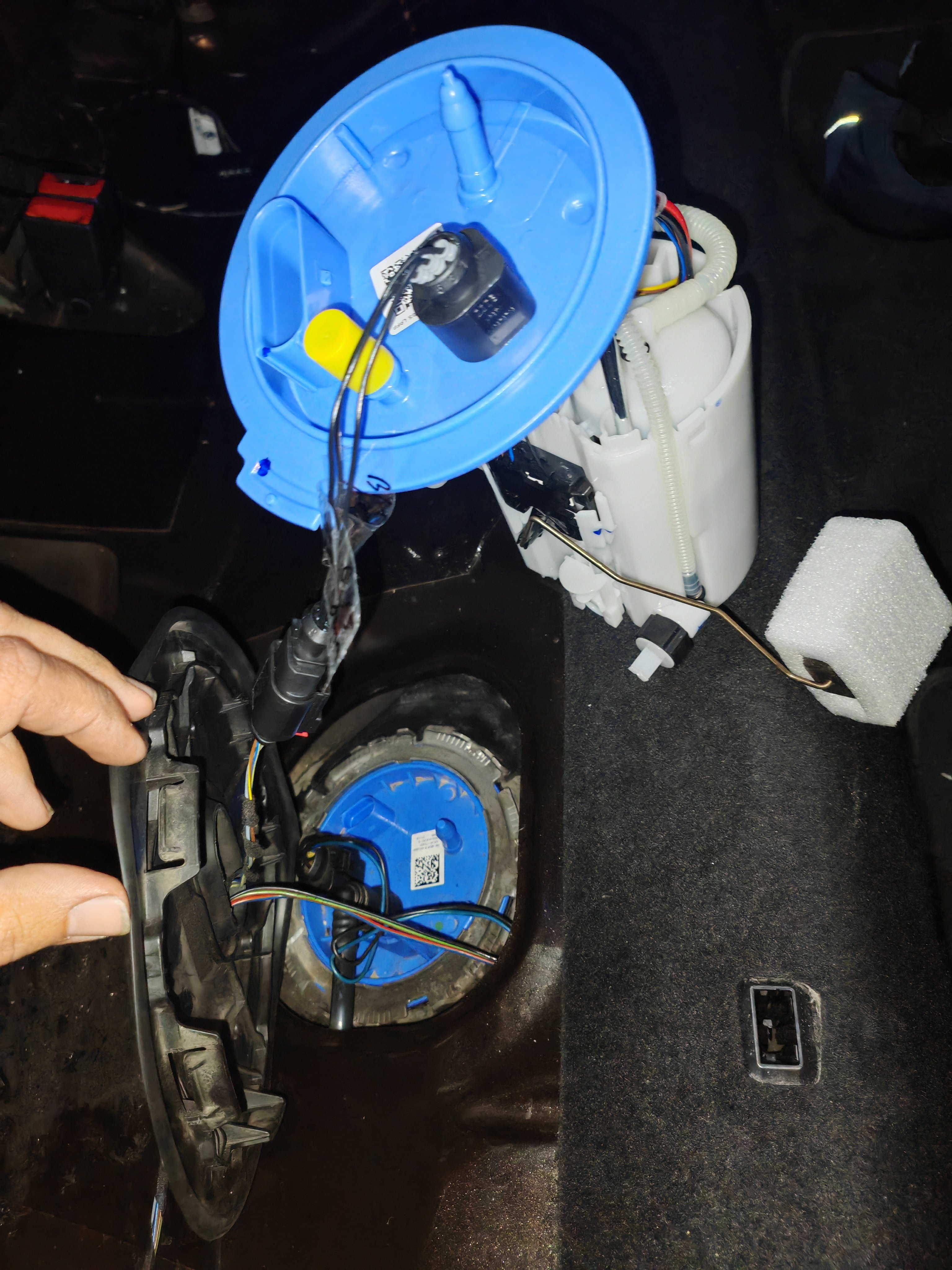

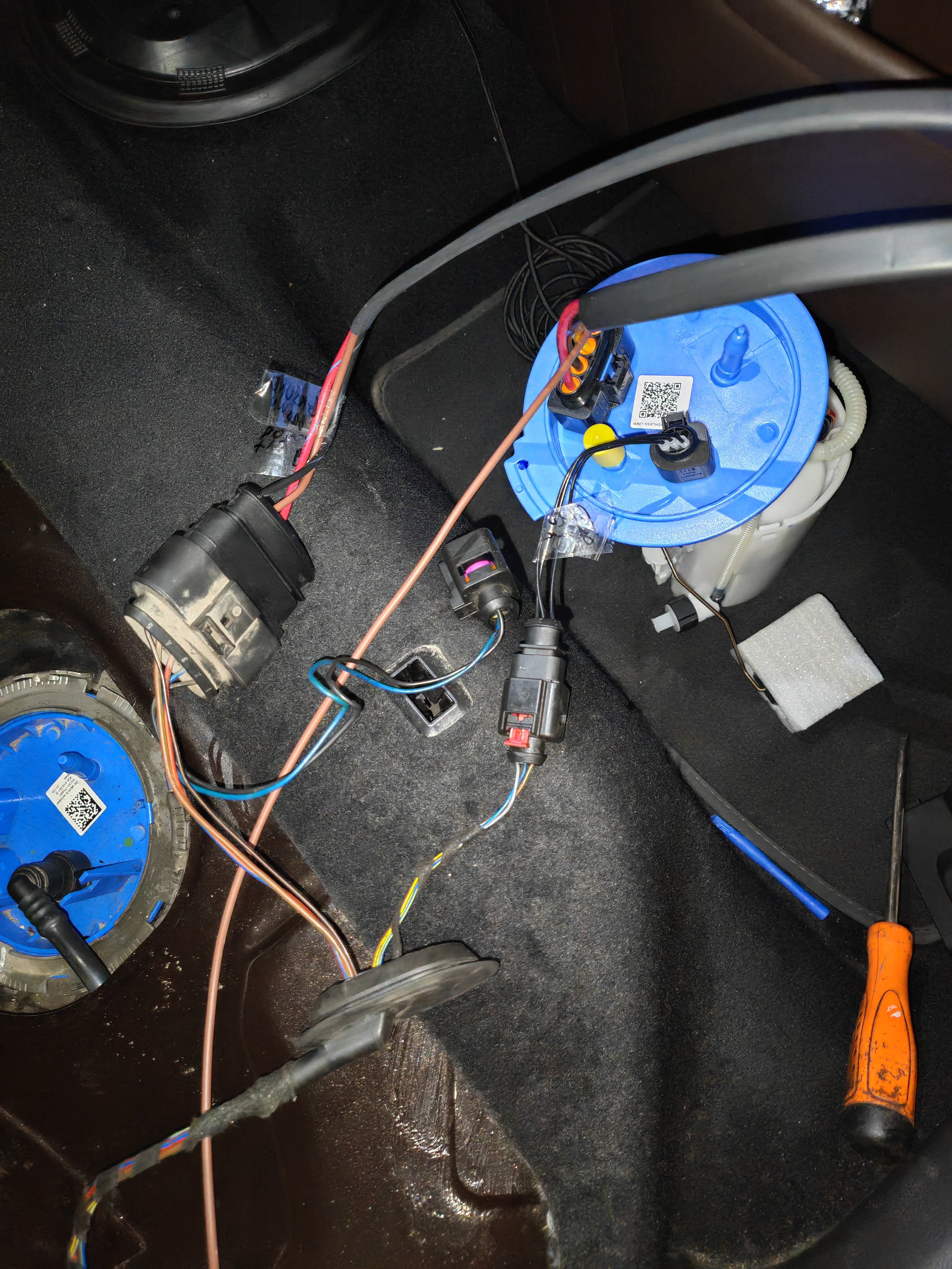

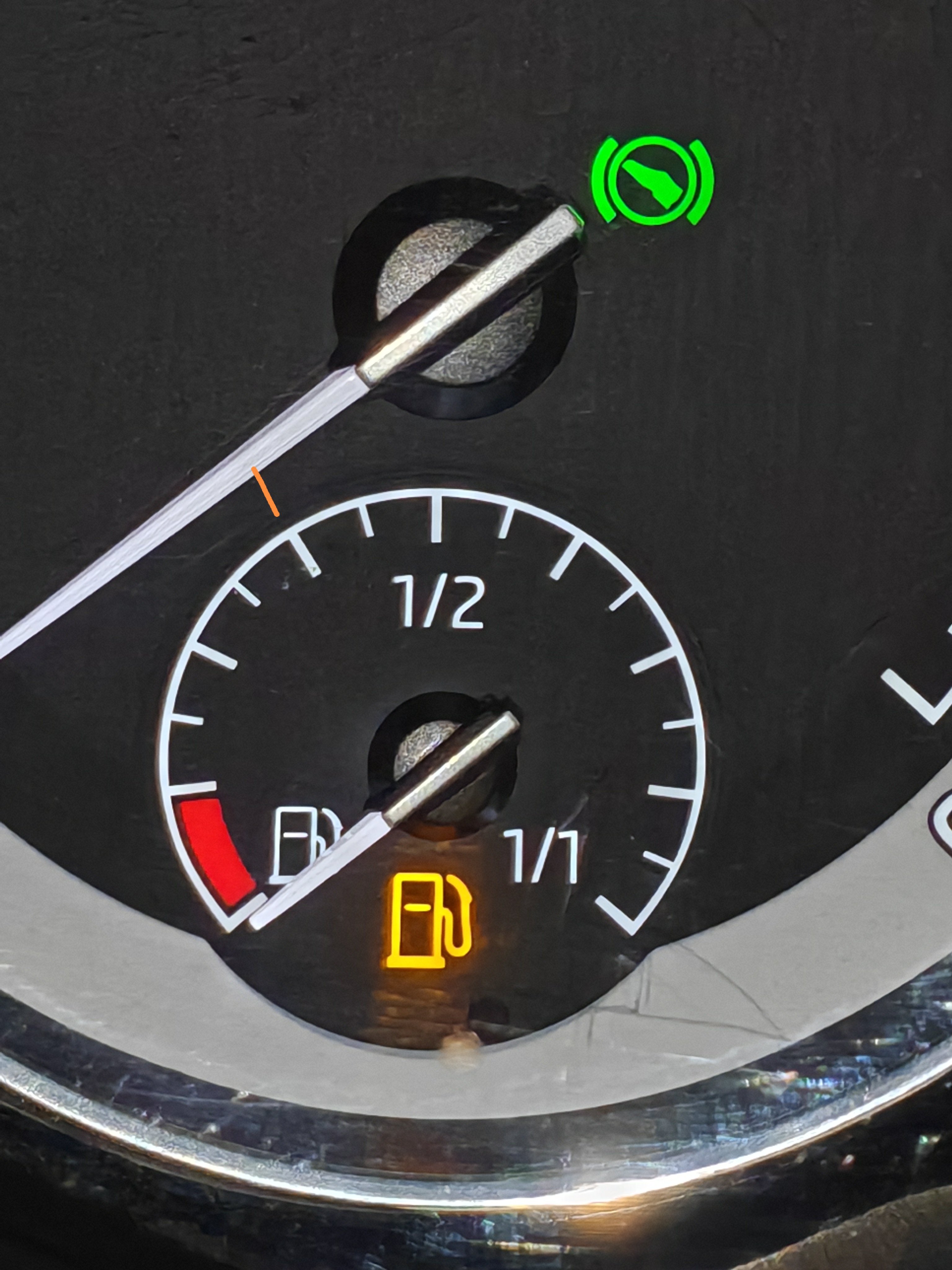

@Awesam Hey mate, I think I’ve just figured out part of the issue with my fuel gauge reading too low during testing. On the Skoda Superb 3V, the fuel tank has a “saddle” shape (split into left and right sections). The right side (passenger side) houses the main pump module with the primary level sender (the one integrated into the RS3/EQT brushless assembly). The left side (driver side) has a secondary sender unit — it doesn’t pump fuel, but it contains another float and a siphon/jet system that transfers fuel to the main side. Both level sensors are electrically linked and their readings are combined by the instrument cluster to display the total fuel level. So when I was testing the new EQT RS3 pump by itself, with only the main right-side sender connected, the gauge only went up to about ¼–⅓ full, even with the float fully raised. That actually makes sense now — the cluster was missing the signal from the left sender. Once both senders (left + right) are plugged in, the gauge should display the full combined value correctly. So I’ll finish the full installation and retest everything with both sides connected before suspecting any calibration or resist ance mismatch.
LPFP Upgrades
Hi thanks a lot, Thanks for your feedback, and otherwise, could you unclip your rear seat and take some pictures of your setup?
