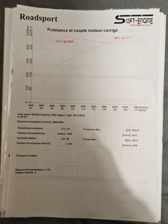

* ECU remap by **Fred Auto Sport (France)** FLEX E85 FUEL WITH BI-INJECTION ACTIVATED
* Approx. **365 hp / 460 Nm**

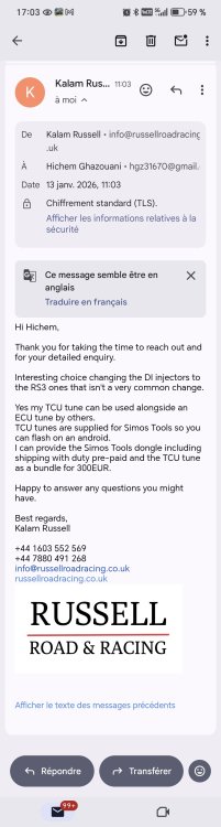

I contacted **Russell Road Racing (UK)** following Briskoda recommendations.
They confirmed:
* Their **TCU tune can work alongside an ECU tune from another tuner**
* TCU tuning is supplied via **Simos Tools** (Android flash)
* They offer a **Simos Tools dongle + TCU tune bundle for ~300 €**

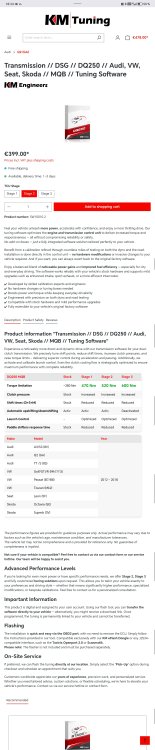

1000077458.jpgThe solution of KM Tuning see attached picture

I received a response from Kalam at Russell Road Racing; this guy seems great. I ordered the Simos Tools dongle and the TCU DQ250 stage kit. Here's his reply to my technical inquiry email :
Thank you for placing your order.
Typically torque limits in the TCU are set to 650NM this is the hard coded maximum that the TCU can comprehend. It does not mean that 650NM is the absolute limit I have had cars running 800+NM on DQ250. Obviously in your case you're not going to be making 650NM but it is better that the limits are set well above the ECU to avoid any intervention from the TCU.
The clamping pressure will be increased and work dynamically.
Shift times are reduced.
Torque reduction is largely an ECU side logic depending on cylinder cuts and timing retard between shifts. The TCU just has a maximum allowed torque reduction available to it.
It can be refined based on logs.
Happy to review pre and post logs if made with Simos Tools.
And yes I am sure that we will be able to achieve your desired goals.
We will get your OBD adapter posted out tomorrow.
I look forward to working with you.
Best regards,
Kalam Russell
