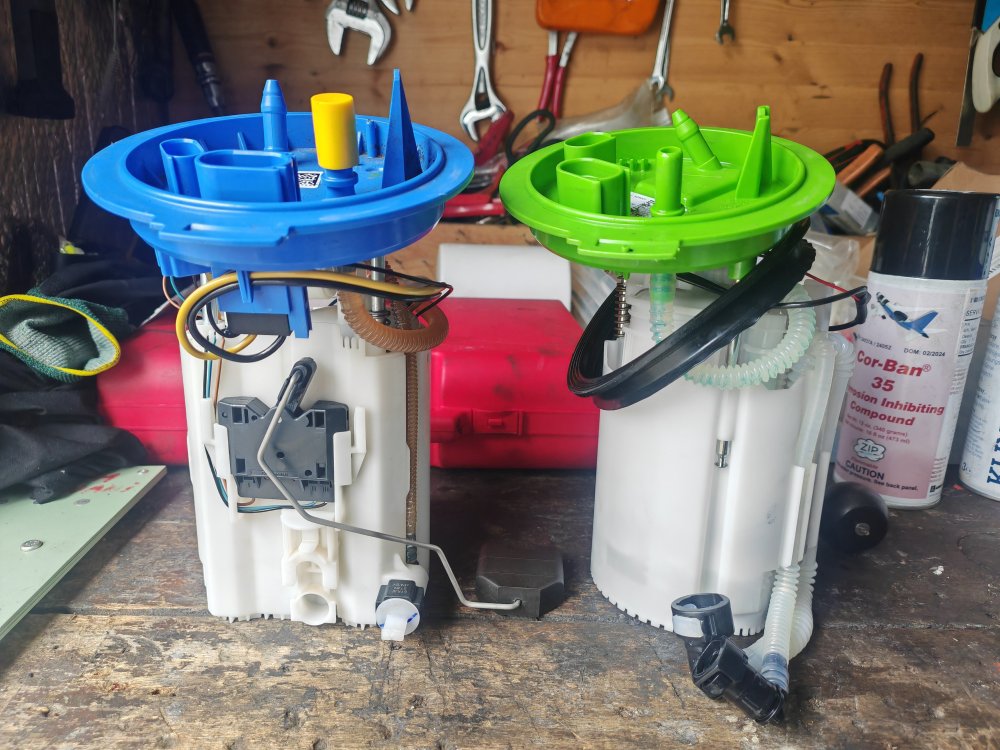

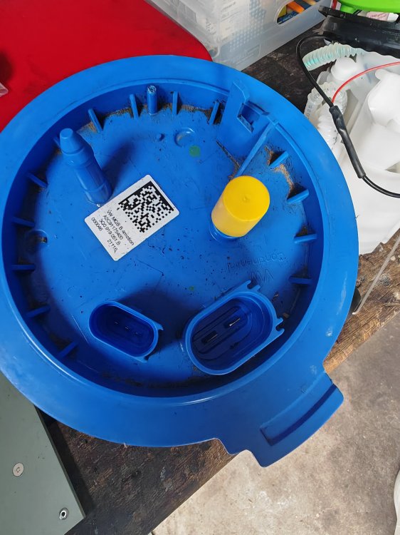

Thank you very much for your help Awesam so I have to buy an original RS3 8V bp pump, reference 8V0919087A but for the wiring how to proceed because mine is original on the Skoda the power supply of the pump is 2 pins (RS3 4 pins) and the fuel gauge is 3 pins (RS3 6 pins) We can see in picture the différences of connectors, and for the fuel level its working ? No error on fuel level sensor résistance ohm ? Thxxxxx- Help with Fuel Pump
SKODA SUPERB 3V 2.0 TSI 280 CJXA EA888.3 DSG6 DQ250 VIN: TMBCE9NPXH7xxxxxxx ORIGINAL LOW PRESSURE PUMP REFERENCE: 3Q0 919 051 B / A2C91175400 / VW MQB B 4MOTION ORIGINAL FUEL SENDING UNIT REFERENCE: 3Q0.919.673 C / A2C87349000 / VW MQB B 4MOTION Hello, I need help installing a high-power low-pressure pump on my vehicle for a Stage 2 E85 flexfuel project. However, I'm having great difficulty finding a solution. I purchased a Bosch 0580200392 pump and a Bartek 590LH kit. assembles but as it is for type GOLF 7R the fuel gauge does not work it does not seem to be the same type because the tank is different, after several in-depth searches it seems that the VW ARTEON 280 / VW PASSAT B8 and SKODA SUPERB 3V 280 share the same platform with a specific pump and the same tank, my wiring concerning the fuel gauge is 3 pins, it seems that after several searches my car model is only compatible with a low pressure pump from Audi RS3 and that there is a plug & play wiring harness. https://scskunkwerks.com/en-gb/products/awd-mqb-rs3-pump-hardware-and-harness-kit?variant=47121984880961 https://scskunkwerks.com/en-gb/products/brushless-rs3-low-pressure-fuel-pump-upgrade-for-awd-mqb If you know how to install it, please let me know which pump/harness I should purchase to install a high-power, low-pressure pump. Thank you for your help. Kind regards,- Hello from France
