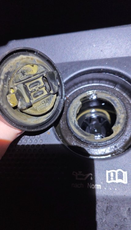

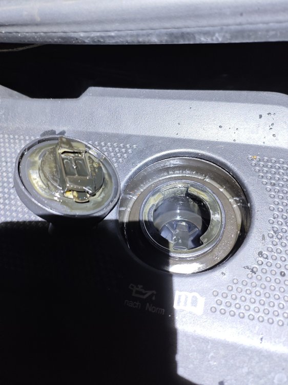

  13. As the title says, devastated. Gone to check my oil before a long journey and just top it off, bam. Propper milky cap. Fuuuuuuuu#£& Well I had no choice about 150 miles from home I thought il clean it up and drive, at least gives me an idea of how bad the problem is. Photo 1 is moment of discovery Photo 2 is having cleaned it up then driven 150 miles To me luckily it doesn't look too bad, it's a bit of milk, clearly I caught it early enough Dipstick is normal looking oil, I don't appear to be losing coolant although I've not exactly been checking it as religiously as I do the oil, no white exhaust smoke other than the normal cold start stuff. Engine is on 115k miles. And temp throughout the long journey was completely normal. 1.9TDI engine code BSW, early 2007 model I'm clutching onto a tiny piece of hope here that itl be something else. I did do the tandem pump last year, after changing the gasket I determined the leak was in the pump itself or the gasket I brought was crap as it carried on leaking. Although obviously it is plausible to also just be a leaky head on the outside, I find that unlikely. I can recall coolant lines run through the tandem pump but I don't recall if oil does too. I'm wondering is it plausible it is mixing here Is there anything else I should check before getting one of those coolant checking kits? Also anyone know someone around Nottingham who's a dab hand with changing the head gaskets on these, my regular mechanic is out of action ATM. If the heads got to come apart I assume it's worth doing the glow plugs and possibly any power mods I want doing at the same time done, e.g bigger turbo, head bolts, injectors? Thanks guys, wish my wallet luck!

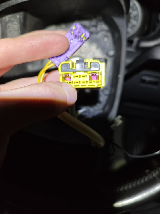

  14. Aight. I've got VCDS and I've got my OEM airbag. So imna swap it. If it goes off I can probably reset it. Thanks for the help y'all

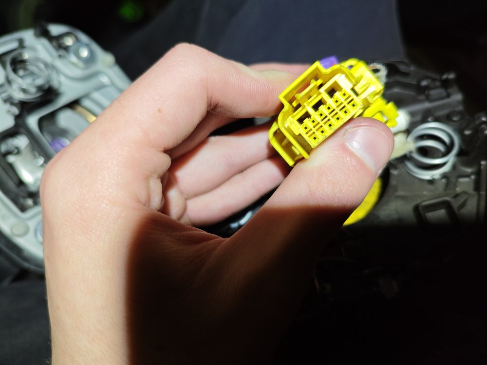

  15. Hi guys, I feel stupid with this one but I had on good authority that almost all VAG steering wheels not only fit eachother but the airbags where a simple swap too. I had also been told that if the connector doesn't fit splicing it would be possible. I've ended up with a Facelift MK2 Octavia steering wheel trying to fit to early MK2 fabia. The airbag connector itself at the airbag side is the same fitment but the loom is different at the squib side. I'm not overly bothered as the wheel and airbag was only £40 but I'm curious is it possible to just splice? Or can I use my OEM loom as it physically fits im just concerned the pinouts would be different. See photos thanks. Original is top connector photo, replacement is bottom. Also attached photos of wheels themselves

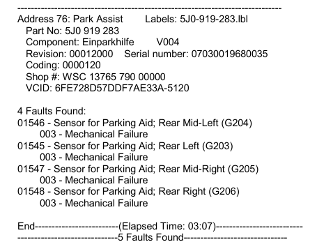

  16. Well never mind. Brown on mine was the 12v reverse signal. Despite being ground almost everywhere else in the car! I couldnt find a pinout, in the end I verified I could find a 12V constant power (red yellow), 12v reverse signal (brown) coming into the PDC and that I was getting 12V on the output side out of almost all pins other than maybe 2 or 3 which seemed normal. So problem exists on the sensor lines after the PDC as far as I can tell. Maybe all 4 are just dead at once! Or theres a break in the line somewhere. Il have the bumper off some other time its freezing!
  17. No corrosion on my unit but measuring the input side to the PDC module is interesting. Some vague information online tells me the blue black stripe wire is likely reverse signal which I can see a blue black coming off the reverse light so seems to check out (assuming that's where the signal is coming from). Engine off ignition on, pos2 in reverse 0V, engine on 2V. My reverse light works. So I'm just tracing that wire back now. Measured outgoing from the reverse light at 12v. Although I can't find exactly where the splice is at the moment. My feelings are it's buried deep in that car I don't suppose anyone has a pin out. My pdc is PN: 5j0919283
  18. Nice one mate thanks for that. The area you describe the connection to be is suspect cus the boot light there is also out so possible corrosion or something has gone on there. Il have to take that boot trim off then. I get the solid tone whenever I go into reverse and clearing the codes they re appear once ive been into reverse so I deffo know the sensor's connections are kaput but until I fix that I've got no way to know if any sensors are kaput. If I get to swapping any sensors il make sure not to glue them until ive verified its the correct side. This connection then is suspect number 1. Its just a question of if any of the sensors are broken once I fix that. Hopefully VCDS will show me
  19. Hi everyone, Earlier this year I purchased a 5J (2007 so awkward crossover year) fabia, making it the fourth Skoda outside the house. I think we've got a problem! She's a beauty all blacked out and elegance spec 1.9TDI so best engine and all the bells and whistles for its time. But have sorted out quite a few bits on it to get it where it is. Im now onto the fairly minor niggles. Parking sensors being my next adventure. Its the only diag codes I have for the car now (other than aftermarket radio) and I would like to have them working. When I run a scan in VCDS it comes back as all sensors mechanical failure. Which says to me its unlikely a sensor issue and likely an issue with ground or supplied 12v power. Unless they are wired in such a way that one sensor dying brings them all offline, but I find that unlikely otherwise whats the point in having separate diag codes for each! Obviously the first thing I've done is check all the fuses relating to parking sensors. No luck there. I'm just here to ask before I spend ages poking around with a multi meter, are there any common faults with these sensors I should check first? Does anyone know where the sensors ground to and where the wires run for them? I'm thinking tomorrow morning I will be pulling most of the boot trim out and having a hunt for their incoming 12v and ground as I can see them entering the car towards the center of the bumper assuming into the boot. Any info helpful. Many thanks :) Heres my VCDS export:
