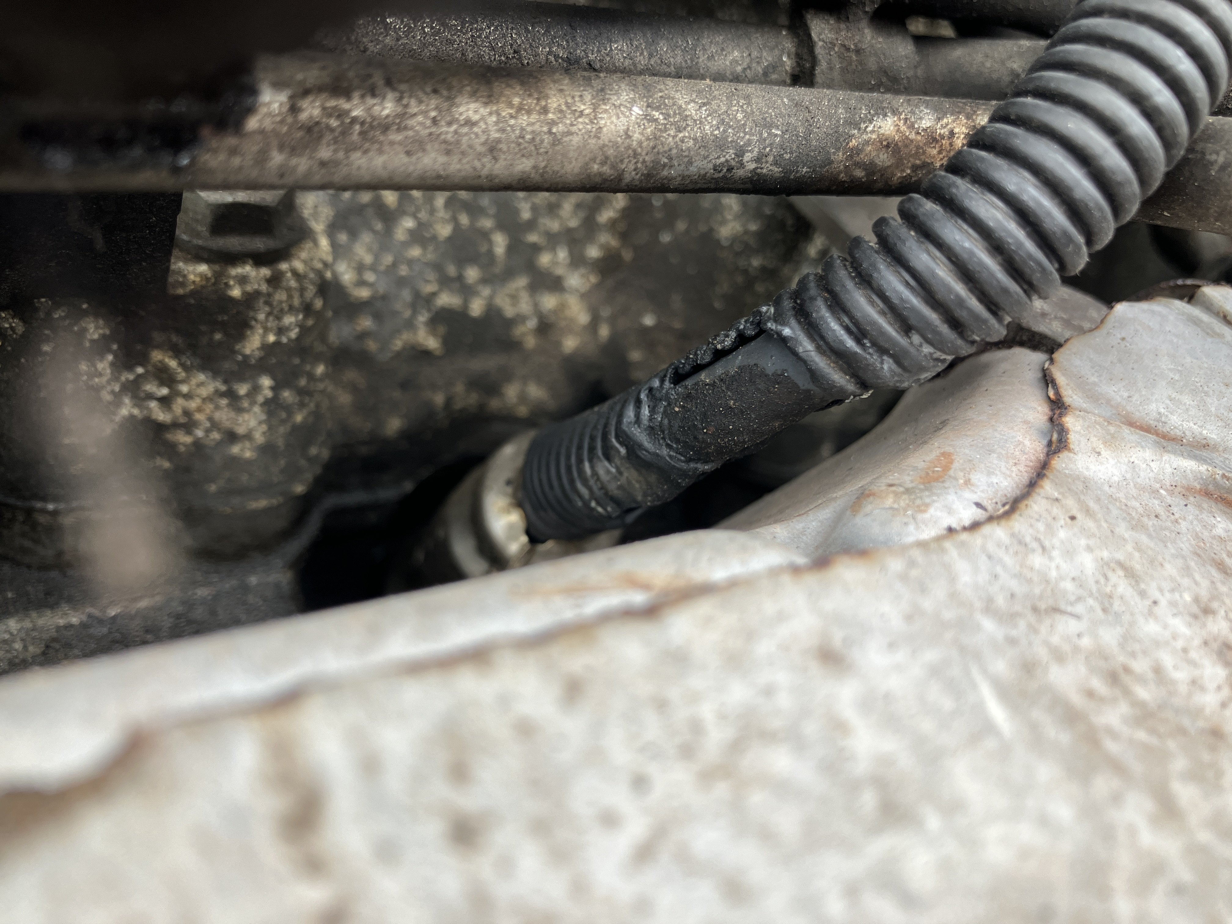

Reviving this old topic to ask: this shouldn't happen to the sheathed lead, even no 3, in under two years (about 20k miles) should it..? Not touching shield but very close, and that's routed and clipped correctly, as far as I can tell (ie there's nothing else available to hold or support the lead to be further away). CBZB 85hp engine, 2011.
