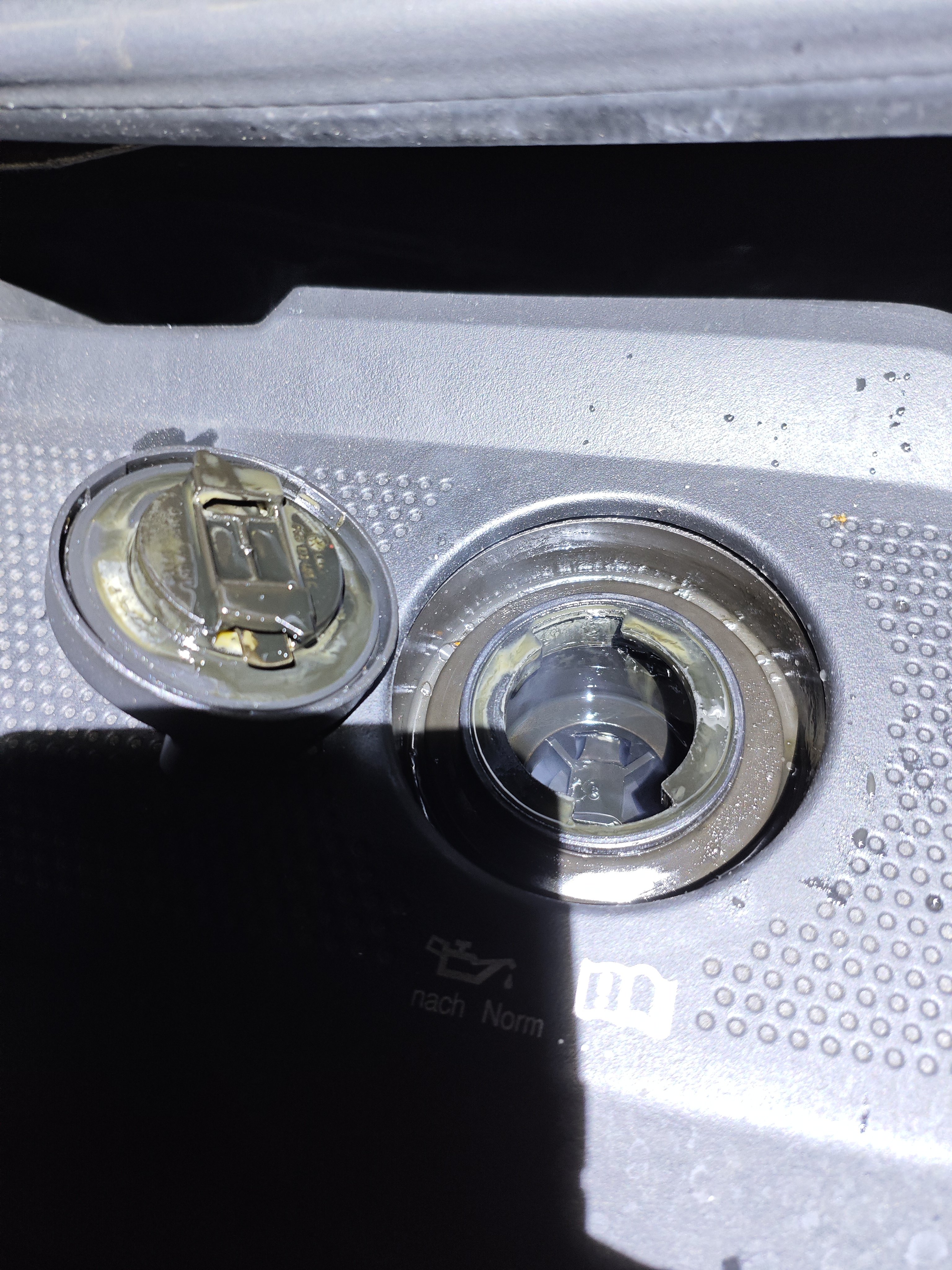

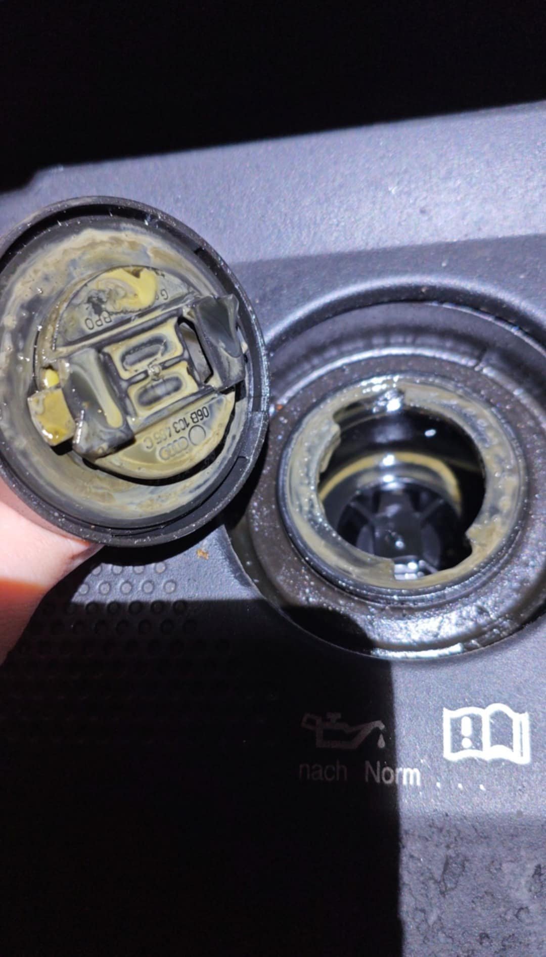

  13. As the title says, devastated. Gone to check my oil before a long journey and just top it off, bam. Propper milky cap. Fuuuuuuuu#£& Well I had no choice about 150 miles from home I thought il clean it up and drive, at least gives me an idea of how bad the problem is. Photo 1 is moment of discovery Photo 2 is having cleaned it up then driven 150 miles To me luckily it doesn't look too bad, it's a bit of milk, clearly I caught it early enough Dipstick is normal looking oil, I don't appear to be losing coolant although I've not exactly been checking it as religiously as I do the oil, no white exhaust smoke other than the normal cold start stuff. Engine is on 115k miles. And temp throughout the long journey was completely normal. 1.9TDI engine code BSW, early 2007 model I'm clutching onto a tiny piece of hope here that itl be something else. I did do the tandem pump last year, after changing the gasket I determined the leak was in the pump itself or the gasket I brought was crap as it carried on leaking. Although obviously it is plausible to also just be a leaky head on the outside, I find that unlikely. I can recall coolant lines run through the tandem pump but I don't recall if oil does too. I'm wondering is it plausible it is mixing here Is there anything else I should check before getting one of those coolant checking kits? Also anyone know someone around Nottingham who's a dab hand with changing the head gaskets on these, my regular mechanic is out of action ATM. If the heads got to come apart I assume it's worth doing the glow plugs and possibly any power mods I want doing at the same time done, e.g bigger turbo, head bolts, injectors? Thanks guys, wish my wallet luck!

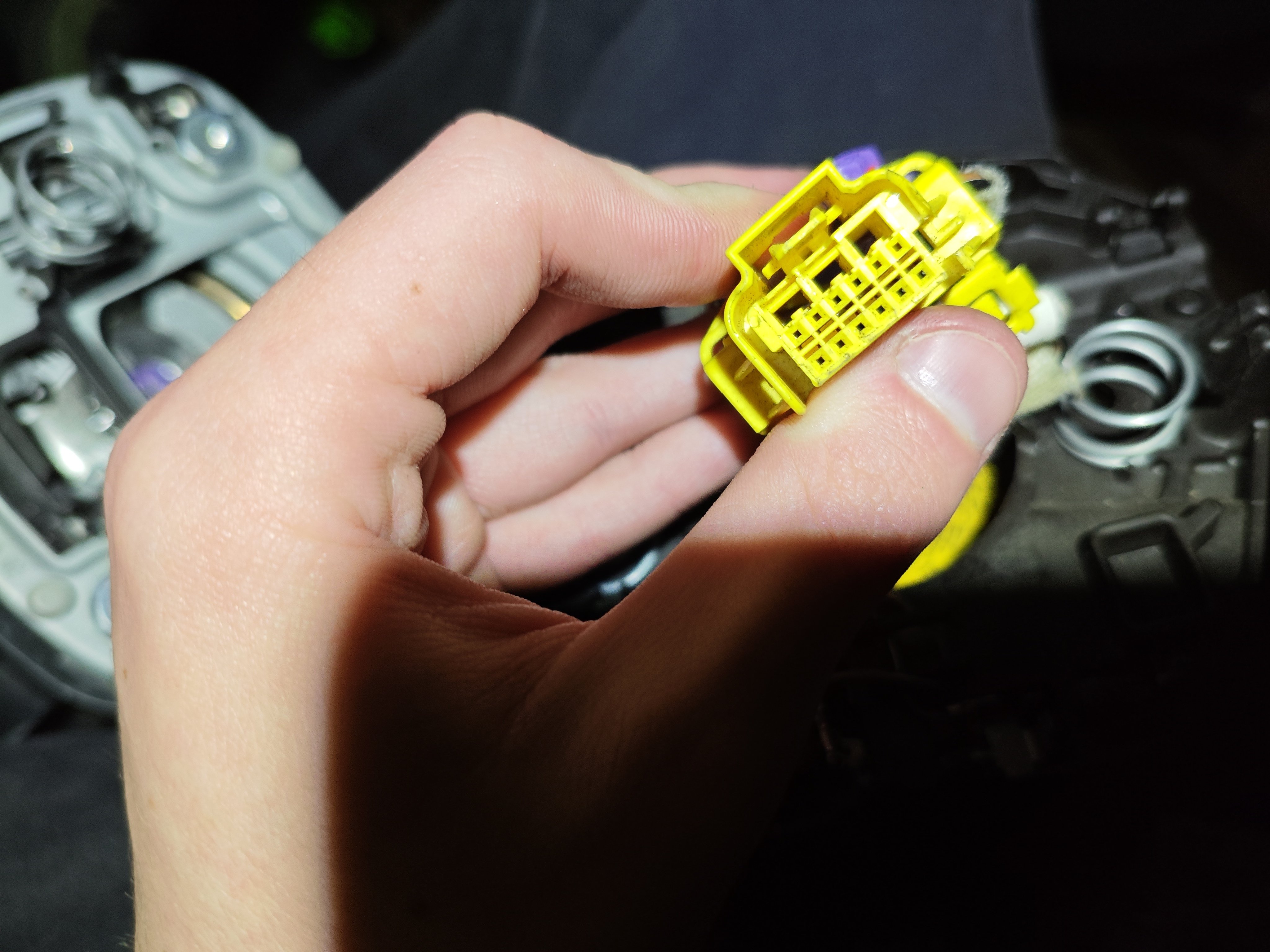

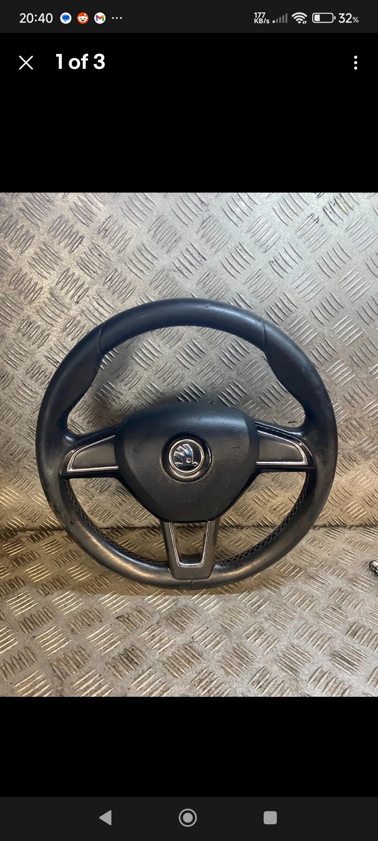

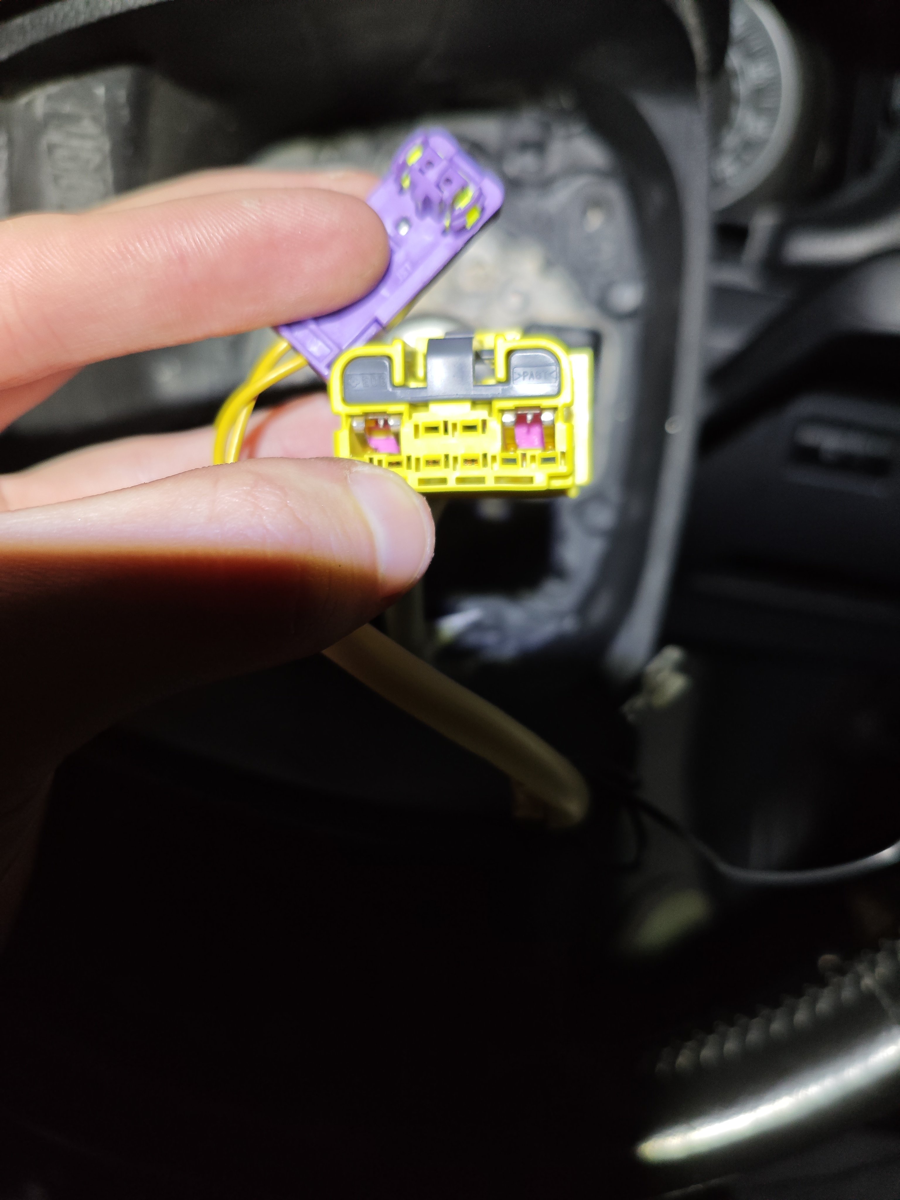

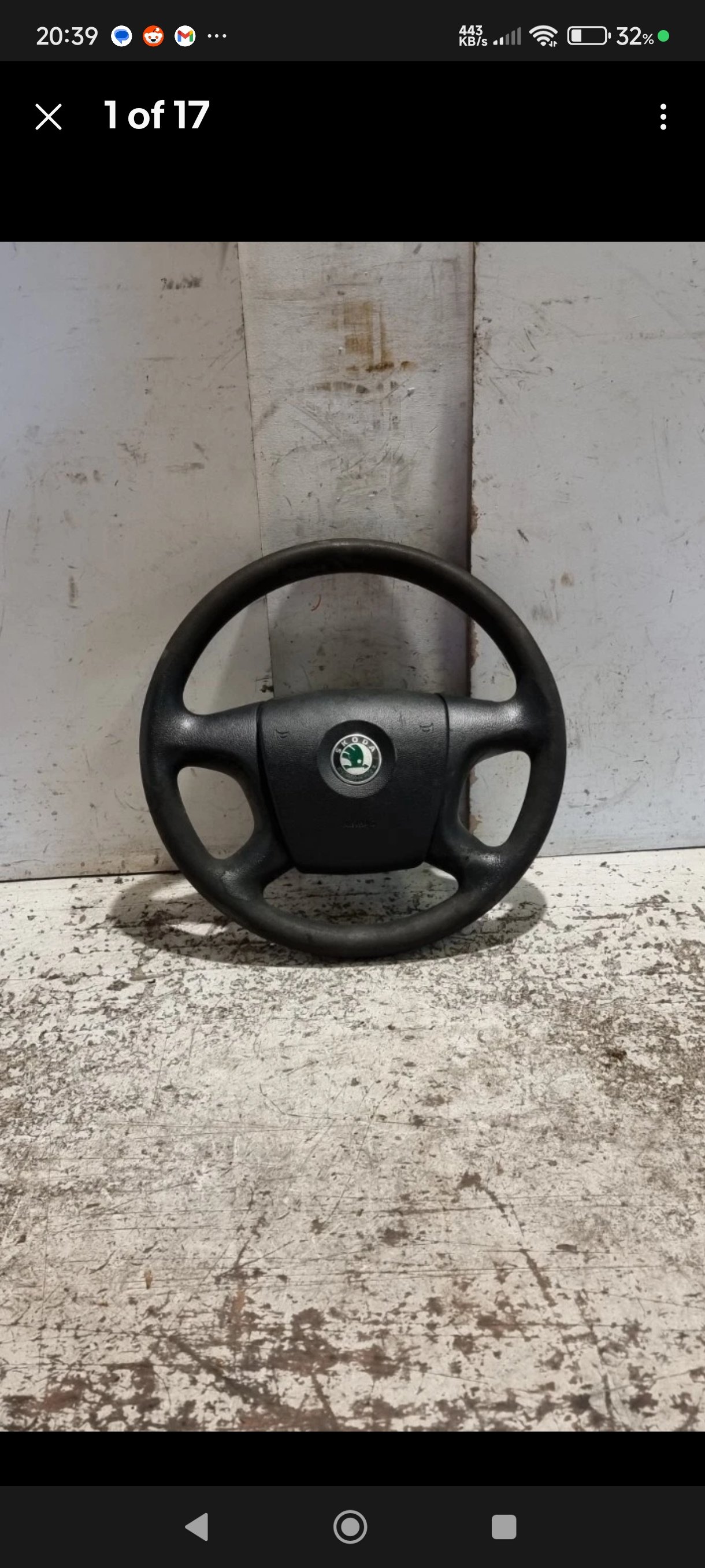

  15. Hi guys, I feel stupid with this one but I had on good authority that almost all VAG steering wheels not only fit eachother but the airbags where a simple swap too. I had also been told that if the connector doesn't fit splicing it would be possible. I've ended up with a Facelift MK2 Octavia steering wheel trying to fit to early MK2 fabia. The airbag connector itself at the airbag side is the same fitment but the loom is different at the squib side. I'm not overly bothered as the wheel and airbag was only £40 but I'm curious is it possible to just splice? Or can I use my OEM loom as it physically fits im just concerned the pinouts would be different. See photos thanks. Original is top connector photo, replacement is bottom. Also attached photos of wheels themselves
