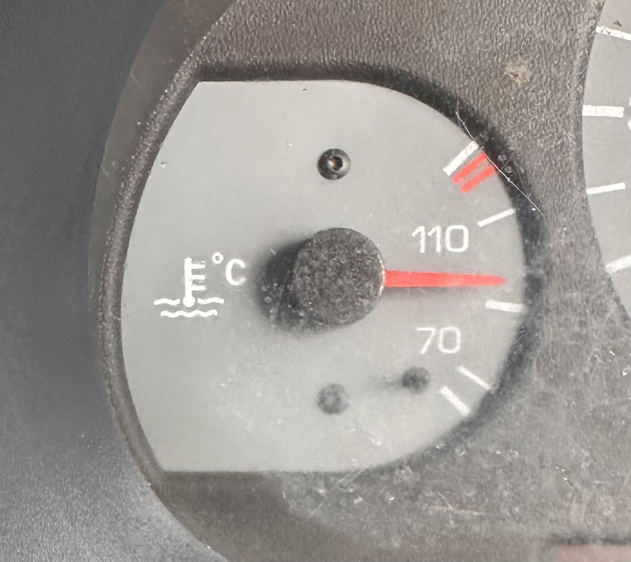

  12. Little update. New radiator arrived today and has now been fitted, but looking at the old one removed I couldn’t see any really issues other than it was showing its age. I’ve taken it for a run as much as I legally can and to be honest there isn’t any significant change. The needle does sit slightly lower but I have to bear in mind the front bumper or grill was not on the car. The picture attached shows the temp when I pulled up and by the time I got the camera on my phone open the temp had already started to fall. Does anybody know the dimensions of the heater matrix pipes as I’m thinking of splicing a piece of pipe in to release the tension on the one that stretched? Also can the heater matrix be removed without removing the heater box? Regards Rob

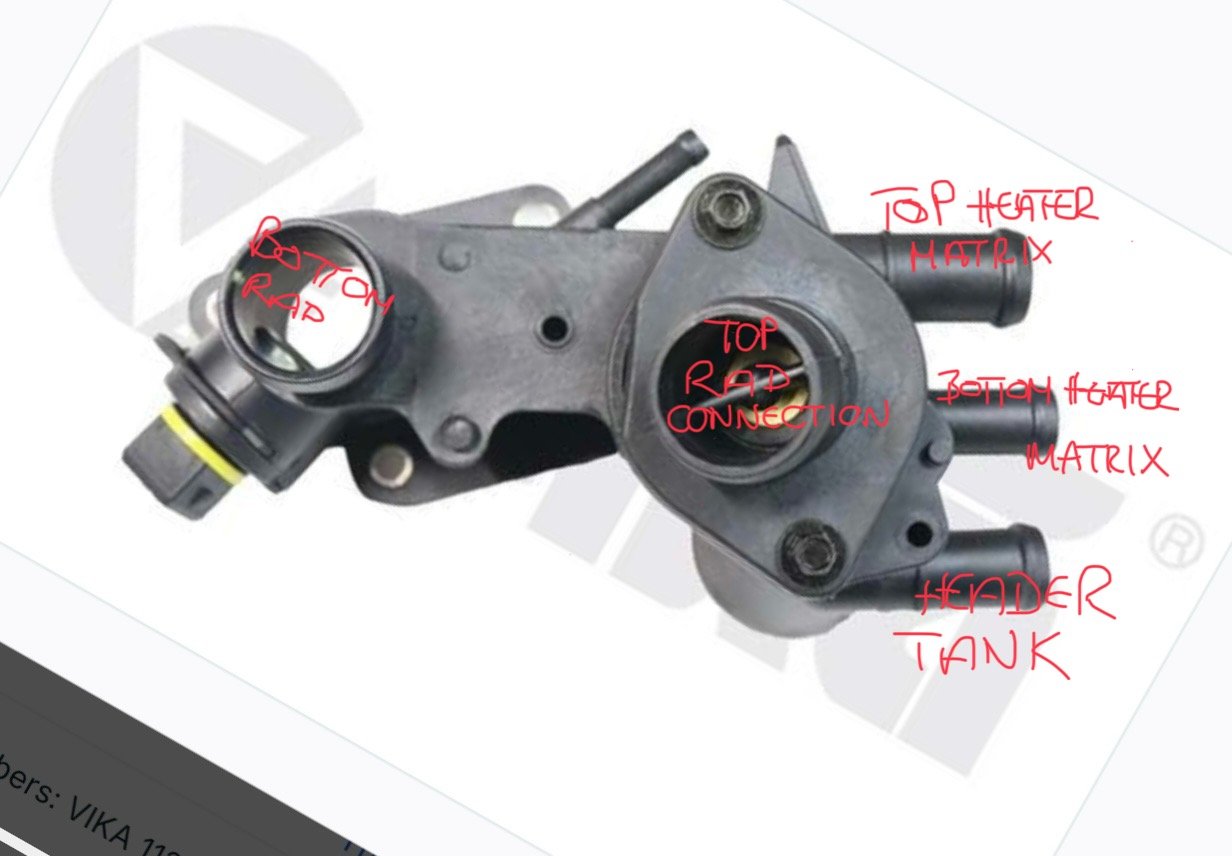

  15. There’s 3 that all sit together on the back of a 1.6 thermostat housing and he put them on wrong. When I bought the truck he even said that the heater was crap and didn’t work. If memory serves me correctly this is how he had them arranged.

  17. aahhh, I didn’t realise there were 3 different sized radiators. On your figures I do have the correct radiator fitted for a 1.6. Looking at the radiator it’s not in the best of conditions so a change won’t hurt. Regarding the coolant pump it was all changed while doing the rebuild as a matter of course rather than a necessity I also changed the water pump, thermostat housing, thermo stat and temp sensor. The coolant hoses were also connected wrongly to the thermostat housing but after asking on this site the correct configuration was found. I still need to find thermostat housing to the heater matrix hoses as the ones fitted aren’t correct and thought they have flow are tight against the air box. The air guide is there. @D.FYLAKTOS The sensor fitted does have a yellow ring but as previously stated if at tick over the needle sits perfectly on 90degree. Do you know the difference between blue and yellow. @Papez Does anyone have any idea where I can get the heater matrix coolant hoses. I did originally post asking but didn’t get any response?

  19. Hi guys, I’m close to get another Felicia pick up, up and running but as it gets closer to being back on the roads I’m seeing issues I’ve not seen before. Giving the car a shack down I’ve notice that the temp gauge sits at around 100degrees when driving as pictured. When the car is parked up the temp sits at 90, rising to around the 100 degree mark and the fan kicks in and pushes the temp back down quickly as expected. The Felicia is a bit of a mongrel in that it started life as a 1.3 but now has a 1.6 in so I’m expecting issues like this. What do people think the reason for the temp sitting so high could be? My rad measure roughly 60x40x4 (is this the correct size?). The thermostat housing was replaced and came with a thermostat installed. Thanks in advance Rob

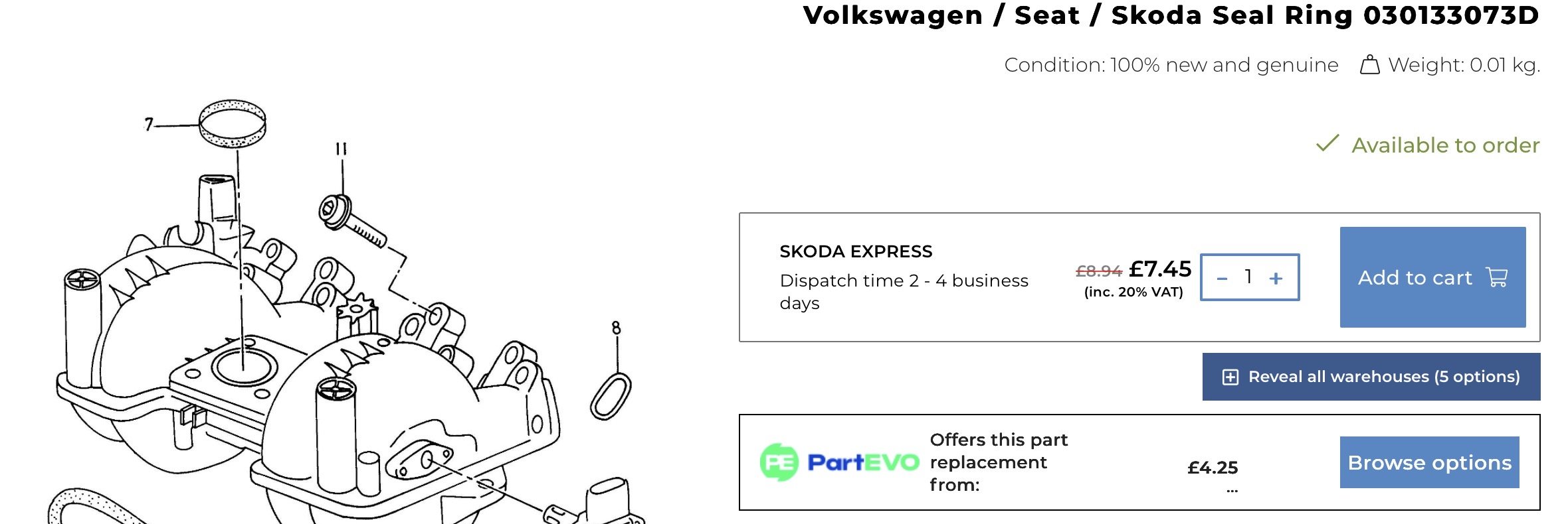

  22. The O ring is available for £10.50 with P+P on LLLparts and measures 52x2. You can get an equivalent from eBay for around £4.

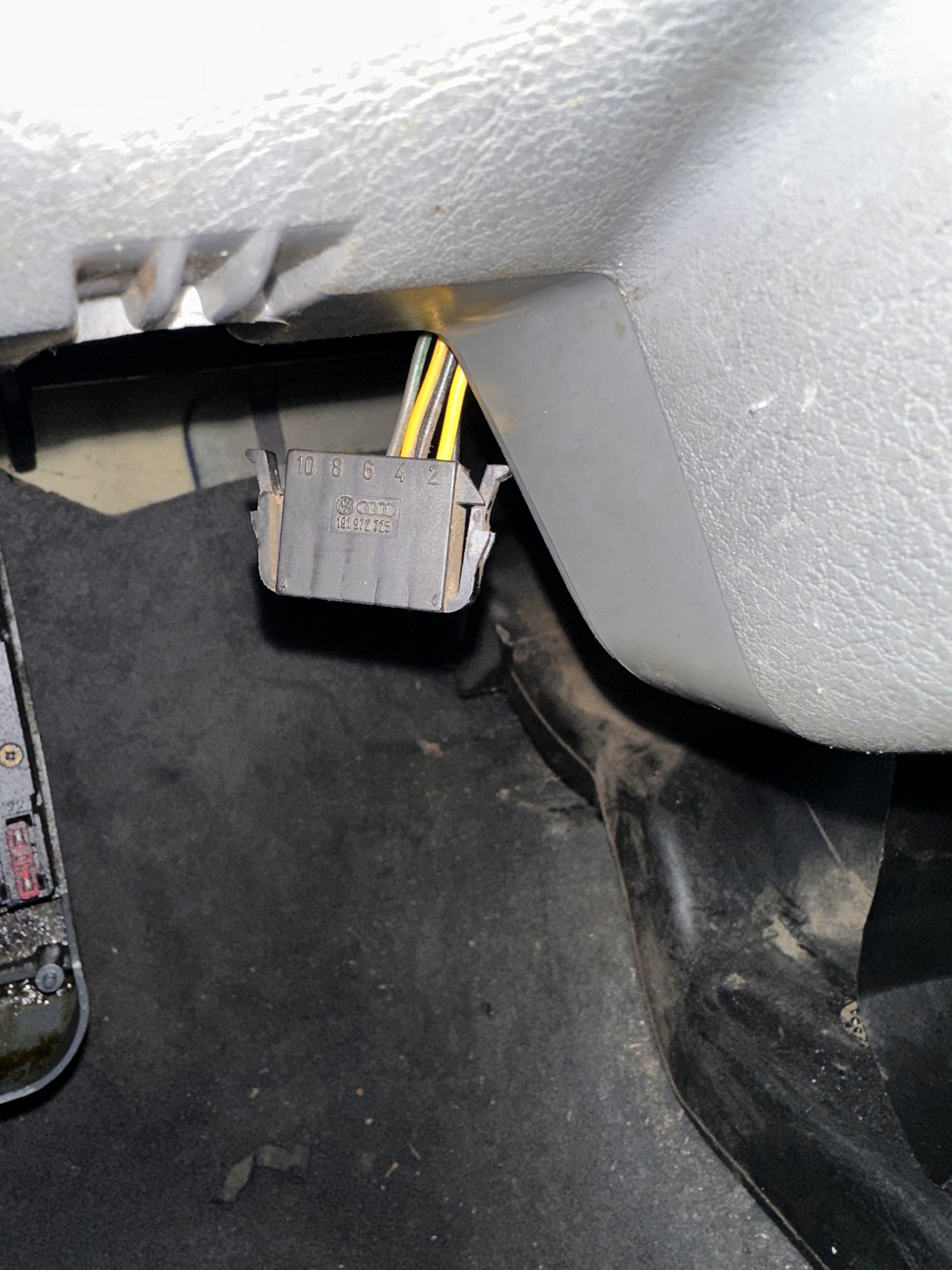

  23. Thanks for that. I have the two ends that i assumed go into control unit but no control unit. so connecting them up is out of the question.
