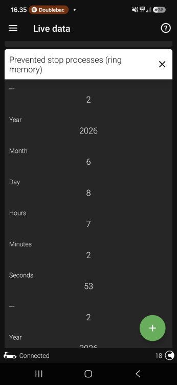

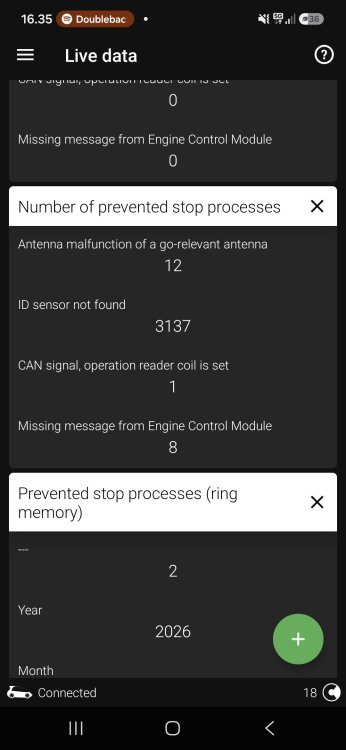

Hello, what could be the reason why my kessy not working, it sometimes works and sometimes not, only the problem is the door handles, trunk and start button is working. I have change the key fob batteries and also the car battery also have changed last winter. But what its weird is that there is no fault codes at all...
I also changed the driver door wiring because there was cracks.
Sometimes in radio screen it show that 12v battery low, when there is still 12.3v when ignition is on, could it be the reason that it disables the kessy system?
