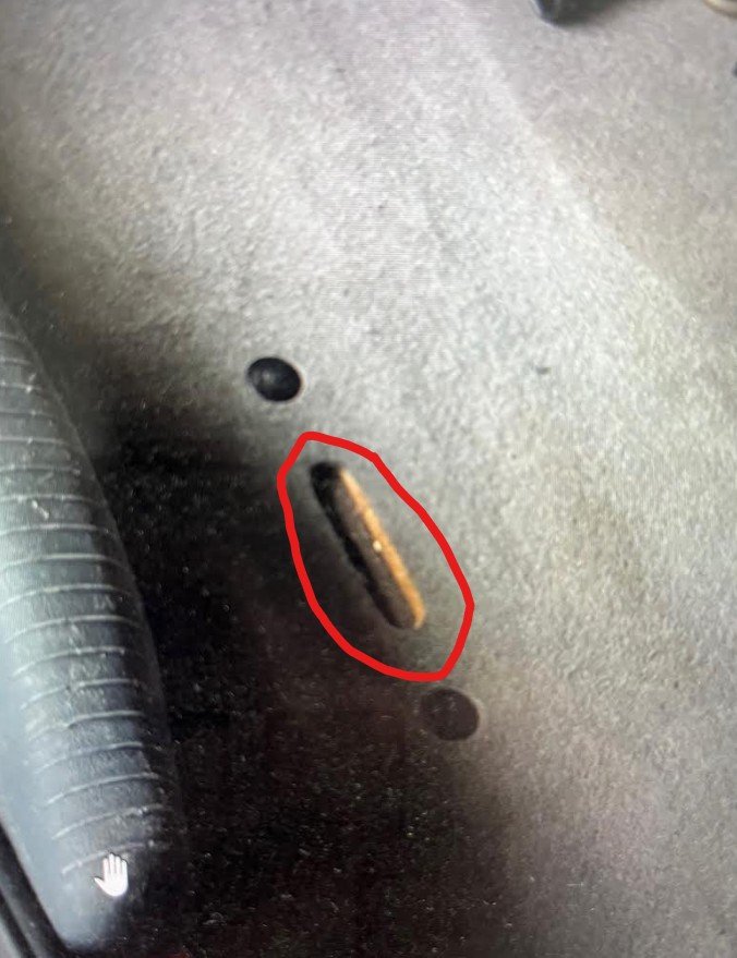

  15. On the boot carpet - looks like there should be! If so, does anyone have any pictures, or is there a part number for it?

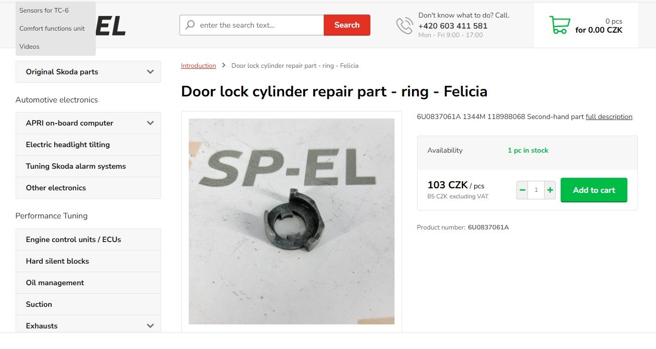

  16. I bought that one from sp-el 😀 I have bought items from amd-autodily, they're a good supplier - I've even returned things I accidentally bought (a rear window seal that I thought was a rear door seal). Used one may be the best option for you, the circlip is easily removable, I removed it with a screw driver and my son re-fitted it by the same method, but circlip pliers are cheap

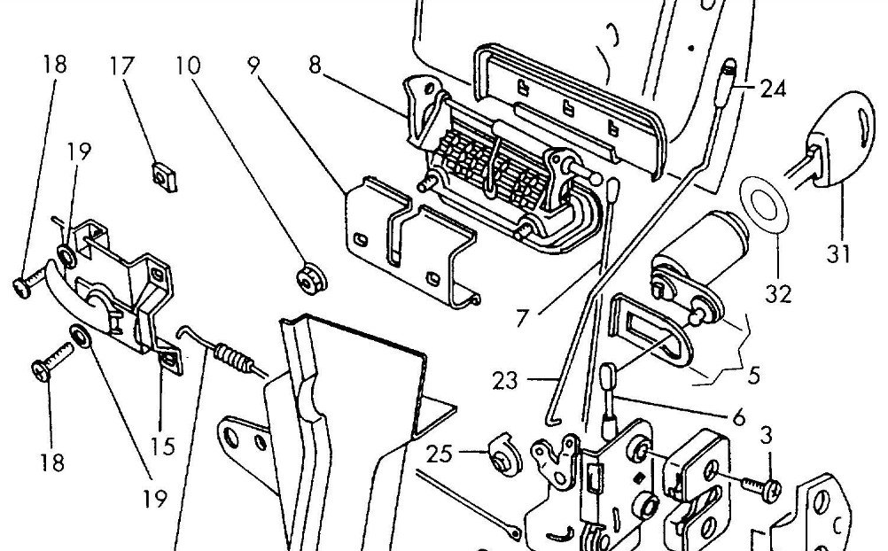

  17. It would appear to be the case - try swapping the lock barrel from the other door, it's probably the easiest way to check - certainly easier than removing/refitting the locking mechanisms! By the way, after my son had spent hours peering at the Haynes manual instructions, I found the Skoda Workshop manual - much better! Chapter 57-8 onwards.

  20. So, I think I may have solved it - see the attached images of the lock barrel cap, the lug that is broken should restrict the movement of the latch, which it doesn't.... and low and behold, on line I found new caps!
