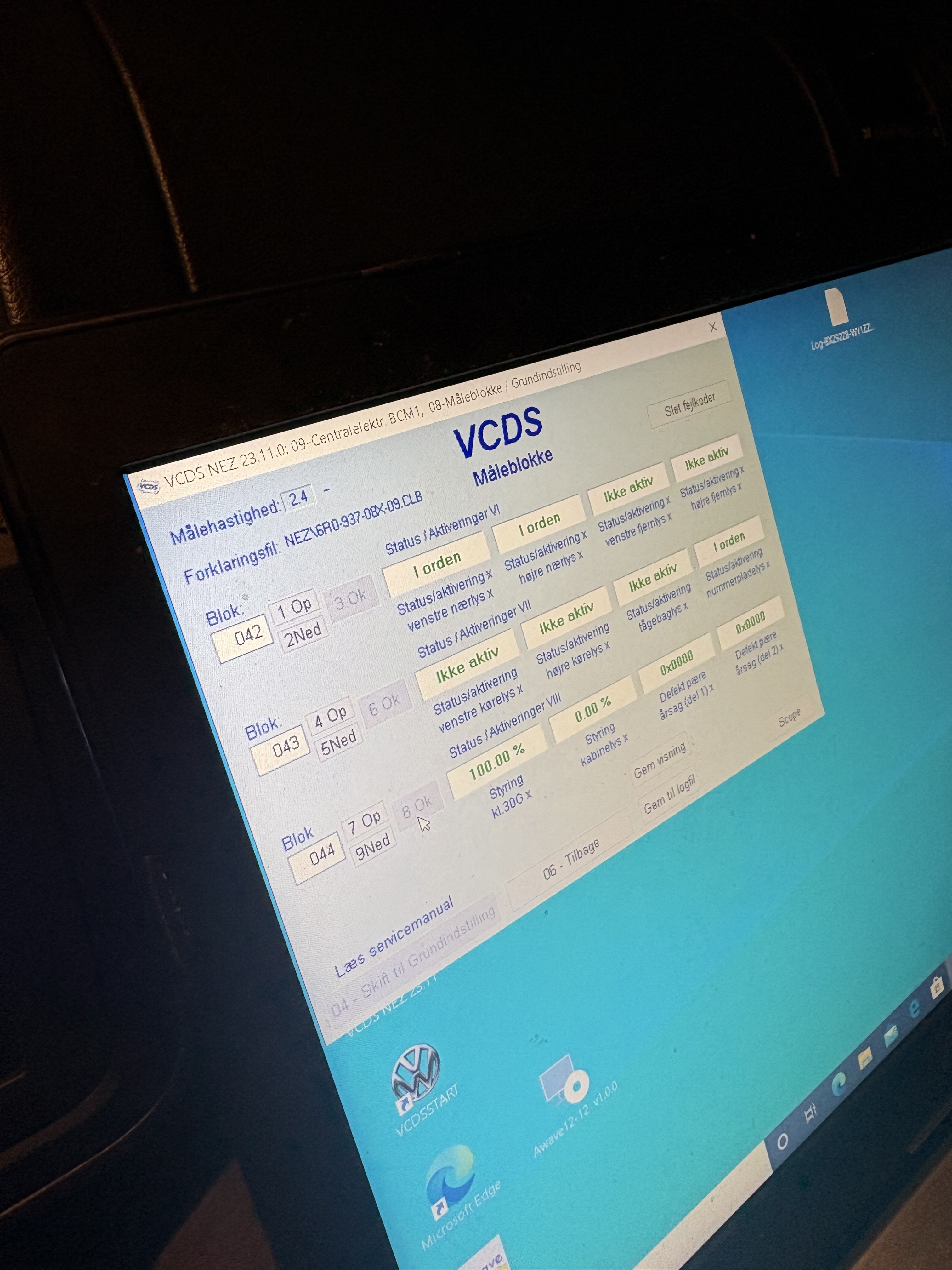

  2. Well, found out why now. Seems the relay 484 is missing, together with the wiring... So I'll either have to find a wiring diagram, find the wires, install relay 484 or get it into a service workshop and pay for it. Anyone got a wiring diagram for the DRL in Fabia II 5J ?
  3. @Evolution13 You have any more guesses? Still looking for the solution, and enabling DRL in the BCM in byte 23 bit 6, just error 31

  6. Well, that makes sense why it isn't physically there, even though the slot is there. Also looks to make sense why VCDS can see monitor that RDL is "not active" rather than "not installed" (the mid row)

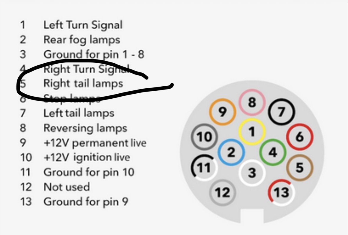

  7. Well, essentially it is everything on pin 5, so all normal lights that is normally associated with the right side
  8. Right now, only on the left side... could be some broken wiring, but the issue is that I'm not sure how this is wired, if is is original, then I was hoping there would be some great documentation about it, if it is DIY, then I would have to dig into the car, but right now: position light: only works on left side. Brake: both sites. Blinkers: both sites.

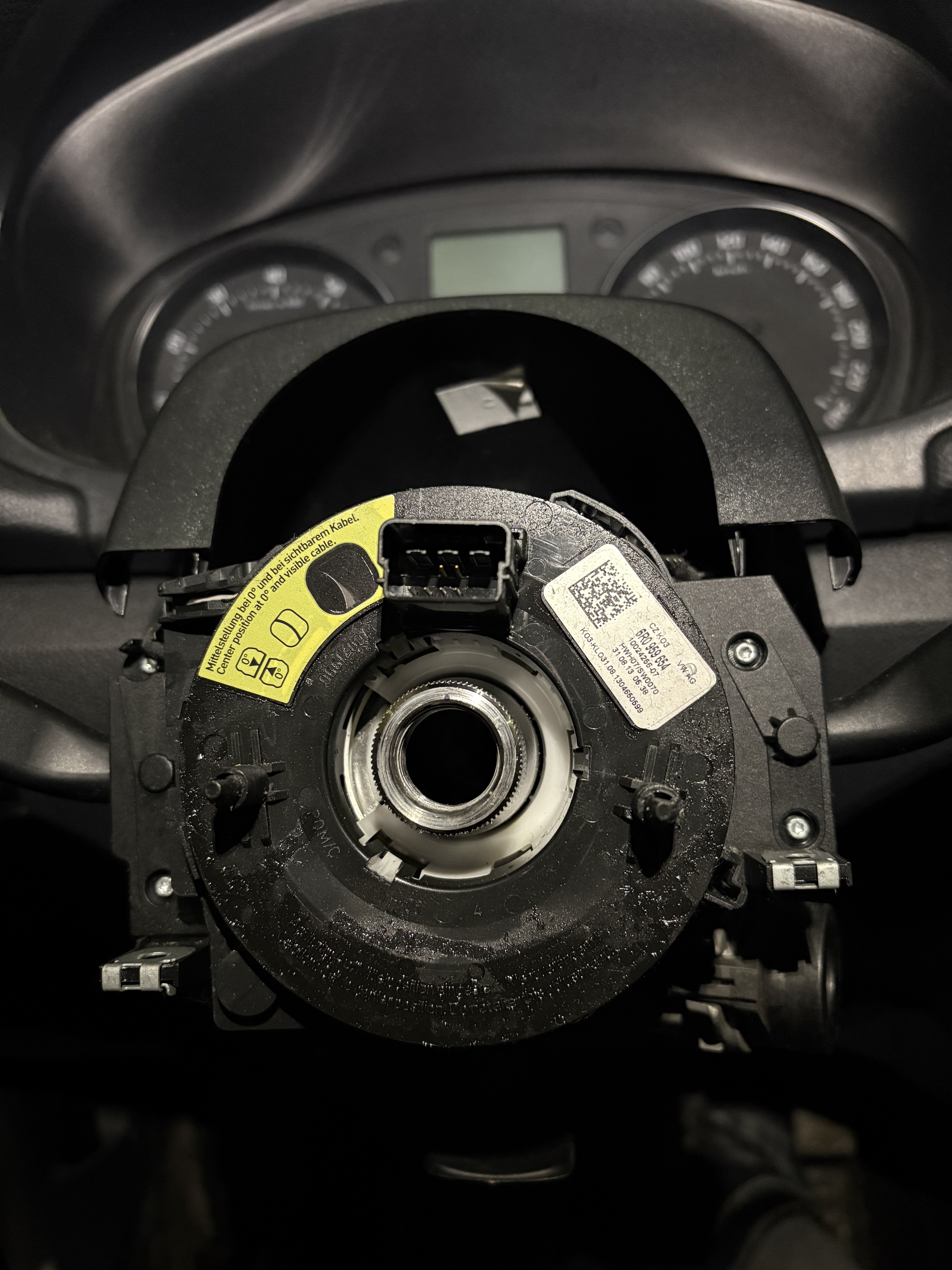

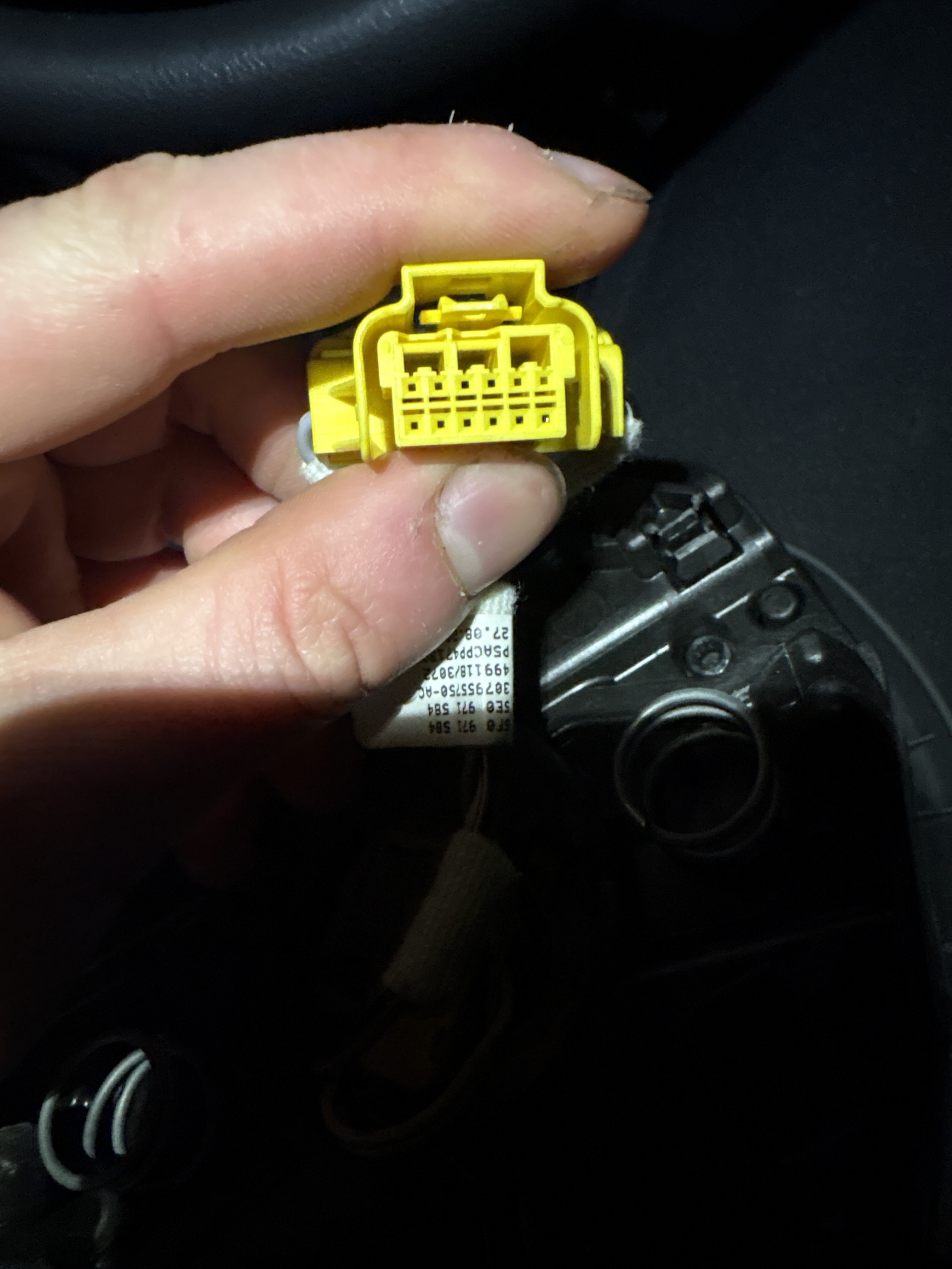

  9. So I'm planning to replace my current stock steering wheel with the a 3 spoke leather steering wheel with buttons (MFSW). Now, I know that the cabling is done through the Airbag, so that should be in the new Steering wheel as well, but I read that the slip ring could have an impact as well, if it supports MFSW or only cruise control ( to add, I do have cruise control arm). Furthermore, are there any limits onto which steering wheel from which models I can use? Or is it just as long it is the same connector? My current steering wheel: Slip ring: Connector:

  11. Soo, I have just gotten my hand on a Fabia MkII from 2014. Some things here and there that I want to change. However, the first thing is that I have noticed that my running daylights aren't working, and can't seem to figure it out. I do have them in the bottom of the car, right beside the fog lights, but they aren't turning on. Checked the fuses, not blown, checked the computer with VCDS, found them, cannot remember the byte right now, enabled them, no change. After a while I found that there should be a switch at the fuses, don't have that! Is it true that I may have the lights, but cannot use them as the switch isn't there??
