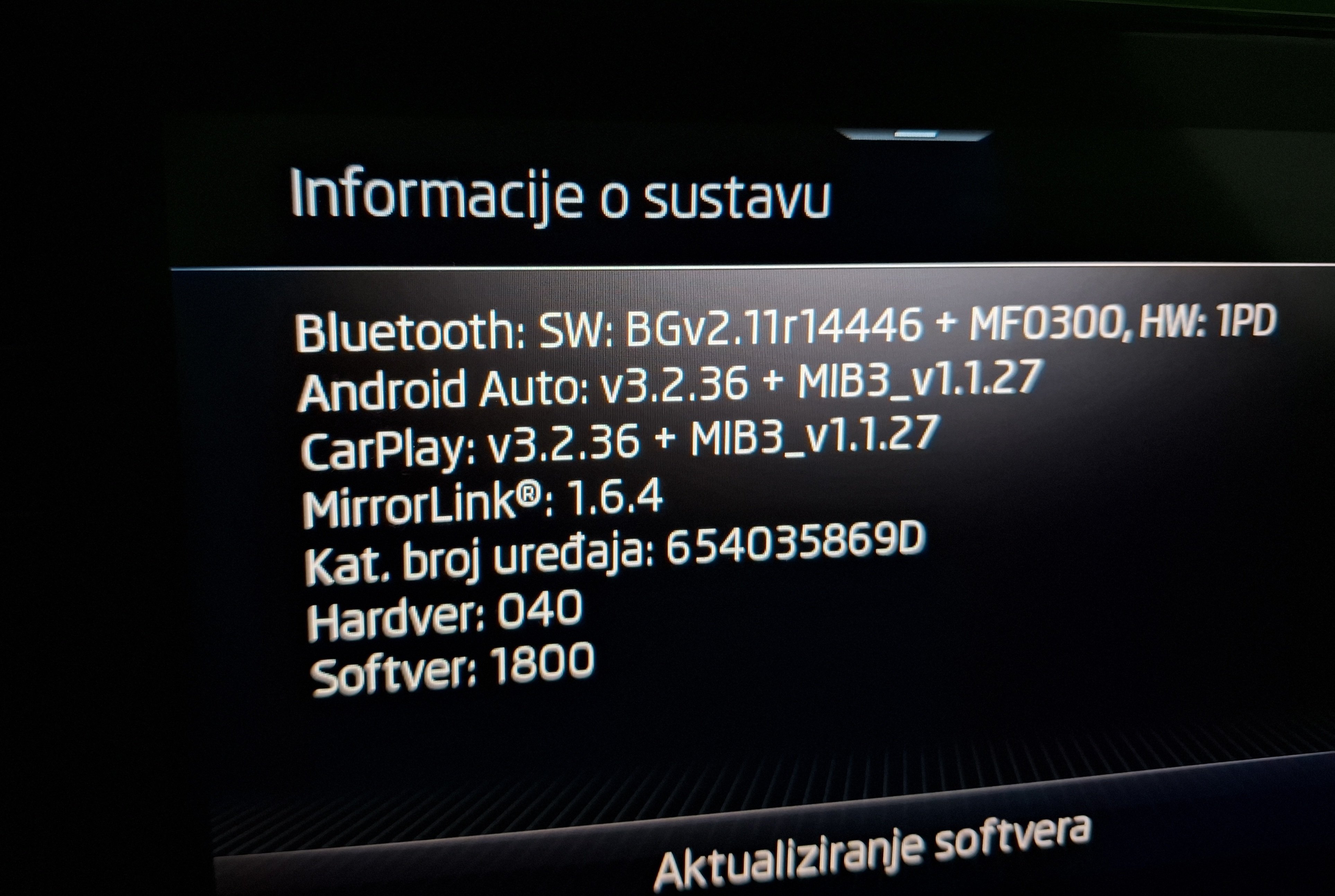

  5. Thank you! My is a bit different in HW, i dont know if thats the problem: And you have non WIFI unit I have D one MIB3E_MQB_BTWIFI
  6. @Oldtowny28 Can you share what unit is in your car, model and what is the mib3 men3 entry? Thank you

  8. Hi all, help needed. I have issues getting camera to work. I ordered the one from the first post. (B type) When i first connected camera, it wasnt recognized. Than i unplugged and plugged again, and bolero restarted, and camera started to work. But (sad face) the image is black and white, and there is no guidelines shown. To note: i did not touch coding at that moment. Just plug and thats it. After that i try to do some codings via obdeleven to see why is b/w and why there is no lines. No luck: What i have tryed: Control unit: 19 Gateway Name: Installation list, specified installations Values: Camera System Rear View: Old value: Not coded New value: coded Long coding Control unit: 76 Parking Assistance Values: Camera type: Old value: not installed New value: Rearview camera Adaptation Control unit: 5F Multimedia Name: Vehicle function list BAP Values: VPS_0x0B_msg_bus: Old value: Not activated New value: Terminal 15 Adaptation Control unit: 5F Multimedia Name: Vehicle function list BAP Values: VPS_0x0B: Old value: Not activated New value: activated When i add camera to the gateway, the 6c unit shows. But its black and i cannot access it to code it further. I get this errors also: B110231 - Rearview camera no signal U111000 - Function restriction due to communication interruption Please help Forgot to mention: unit is mib3e_mqb_btwifi
