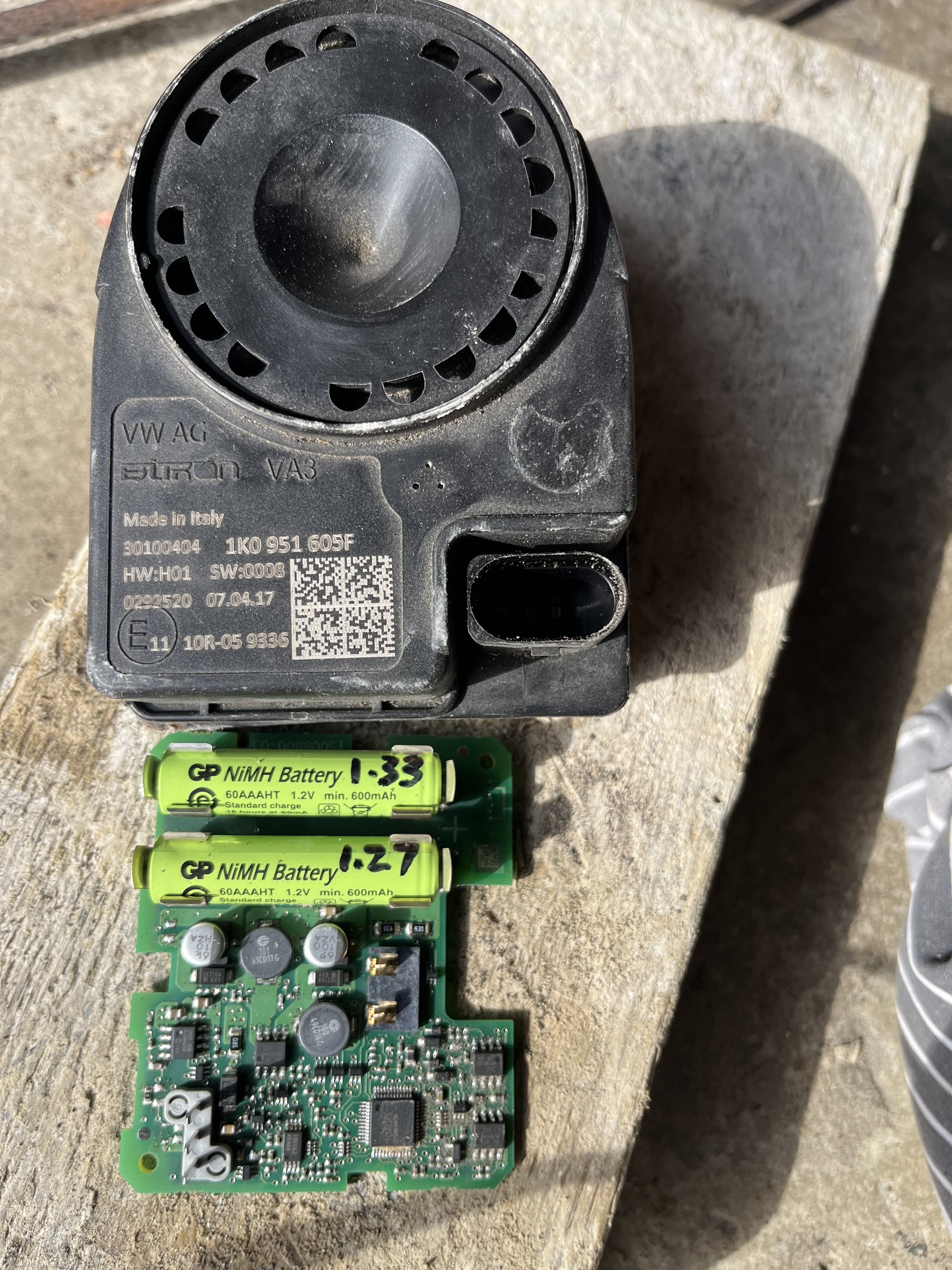

  1. Thanks for replies. The main car battery has not been tested. Car is 9 yrs old. Owned car 3 yrs. Don’t know if battery is original but seems likely. Car starts fine and stop start works. I have now cut alarm siren open. Pic of it attached so anyone having problems with this can see model number and the inside - 2 x AAA rechargeable batteries which slot in - not soldered in. One of these reads 1.33v , one at 1.27v in series so total 2.6v so doesn’t seem too bad. But I replaced the batteries today with new energiser rechargeable batteries. Alarm now seems fine, but it’s probably too soon to be sure. Will update if it turns out to be dodgy still. And I will check the current drain when car locked up. Thanks for replies
