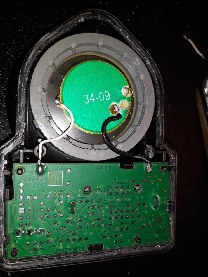

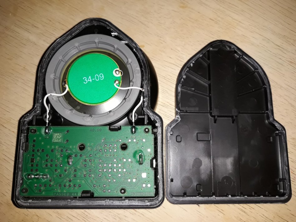

I scanned the VRS with VCDS recently and there was a "low voltage" error to do with the alarm siren picked up.
I decided to replace the battery (2010 vehicle) and hoped that the battery hadn't started leaking over the circuit board.
I had read that you open the case up with either a Stanley blade or a hack saw. A mate suggested heating before cutting so I used the wife's hairdryer before cutting with a Stanley blade. It was pretty easy when heated up a bit.
Unfortunately that's as good as it got as I had a couple of issues. First one was I cut a wire with the blade while opening it up as there are 2 very close to the edge of the case. Second was I got the wrong battery.
I will get the correct battery and replace as planned.

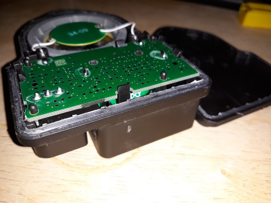

I replaced the wire. Please note that if you de-solder the original wire, the metal coating comes with it so you need to solder in another place. I moved the wires to sit in a bit.
I took some photos that may help others if they decide to replace the battery. It looks very easy to do. I also have a photo showing the position of the alarm at the rear of the front drivers wheel arch.

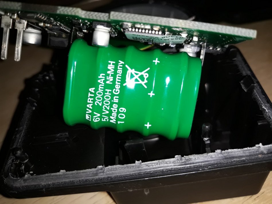

From my searches you can find a 150mah cell pack easily but not the 200mah.

The original is just 5 X Varta V200H batteries which you can still get. It's just soldering or spot welding the pin at each end that would be difficult.
Soldering wires on the cells is easy provided you roughen the surface with an abrasive, clean and flux the surface and use a high heat iron for a quick application of solder, you don't want to wait around with a puny iron waiting for it to heat the button cell.

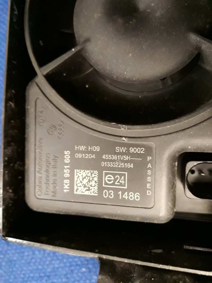

Did a VCDS scan and it showed 01134 Alarm horn (H12) logged as a fault, removed siren and took it apart, battery reads 6.9v so that looks good PCB has no corrosion, the battery is a Varta 6v 200ma 5/V200H  Ni-Mh and my siren is 1K8 951 605. Cheers Stuart

I had another look for one of the Chinese copy alarm sirens but it seems they are no longer available either. 1K8 951605 or 1K0 951605.

I want to check old part number as people have said the letter at end can cause problems and not work if not identical.

Heat the siren along the seam with a hair dryer and it opens easily with a Stanley knife. Just watch for the 2 wires next to the inside of the seam.
Thanks, I found an exact replacement on ebay. So old one out and car working. Will fit the new one on weekend.
i hacked it open, battery had not leaked which was interesting.
