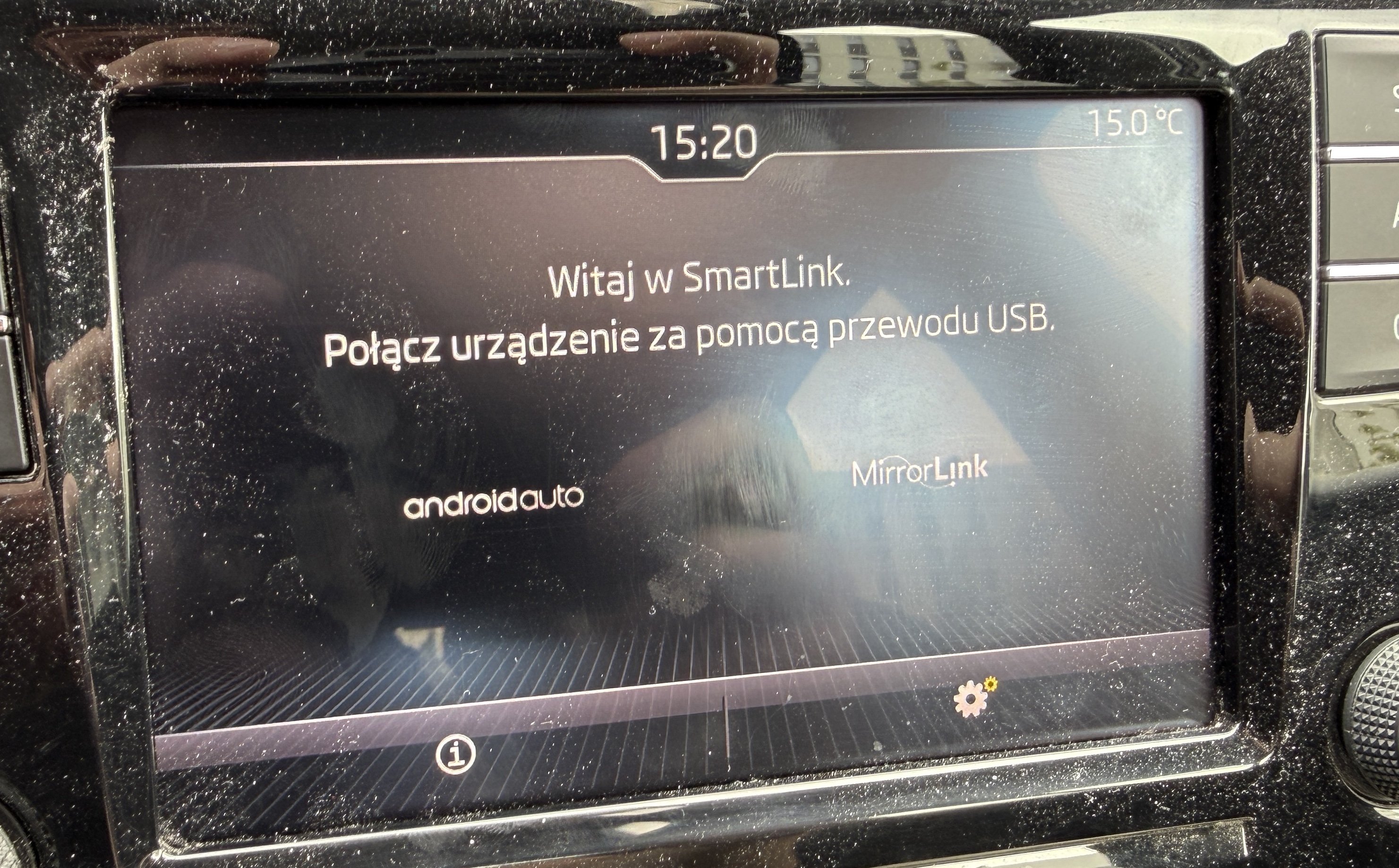

  2. Now I see that I’ve got only androidauto and mirrorlink on screen, no CarPlay. Does that mean that the radio won’t work with iPhone?
  3. When I connect the phone the music from the phone starts to play, via MEDIA probably. When I Connect via USB and Bluetooth the CarPlay says both connections cannot work together and to disable Bluetooth. With Bluetooth off and the cable only the music from phone plays, but nothing changes on screen.

  5. Ok, everything works, however one last thing. My Skoda CarPlay (iPhone) does not connect to the radio. However, music plays via USB cable, so I assume, "iPad" in OBD works. What could be the solution?
  6. EDIT: solved by changing USB port to 3.0 -> not enough voltage on 2.0, going to install the thing, wish me luck! Rapid Liftback

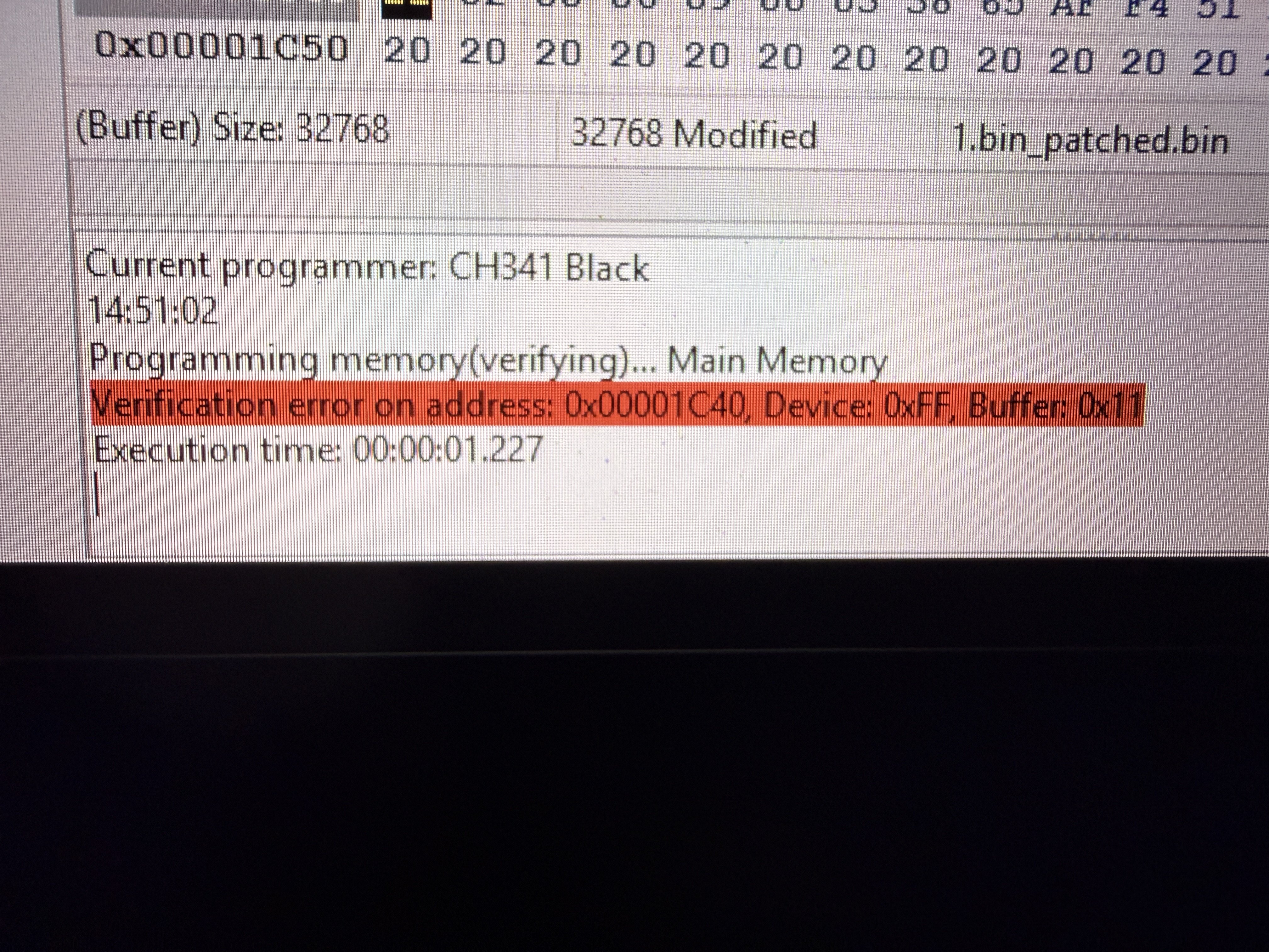

  7. Ok, I made it through, the programmer was damaged, I’ve bought new one, working. However, during write process i’ve got following error: Any help? For orginal 1.bin there is no issue

  9. Yes, I’ve tried original, must be programmer phisical issue
